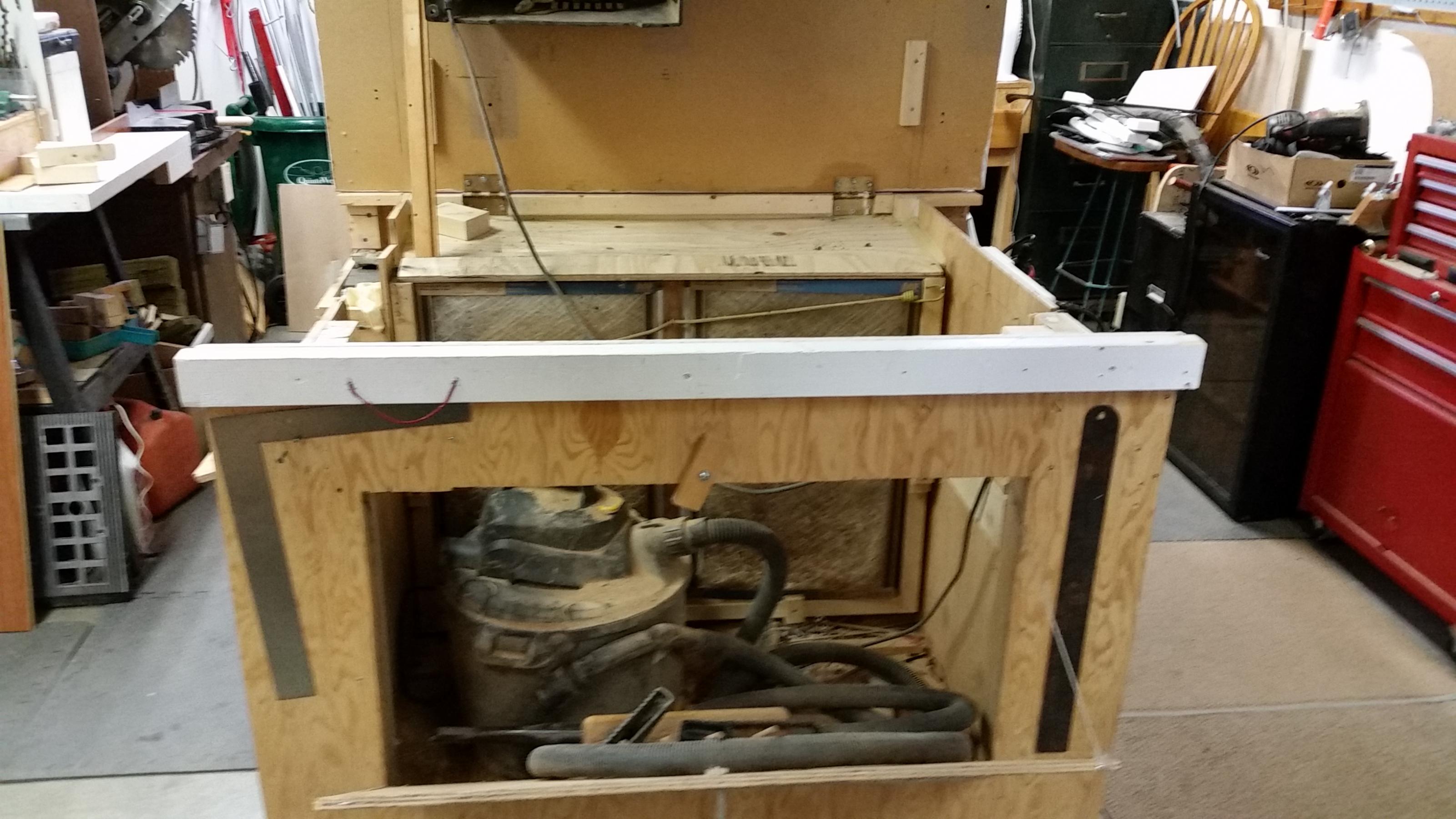

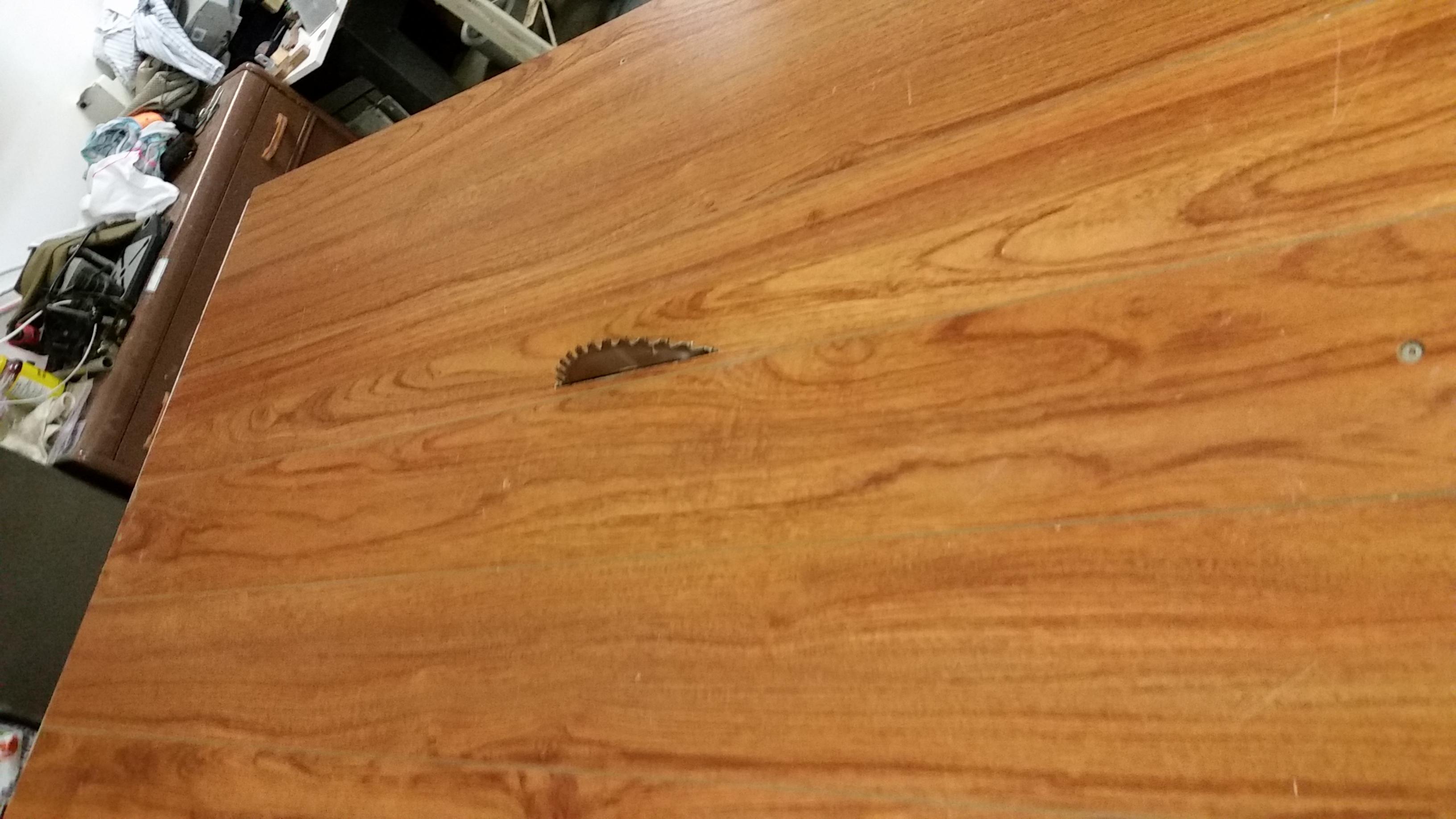

I built a DIY down draft table 4'X4' with a table saw in it a while back and also a place for me to store my shop vac.
Got tired of clearing off the table to open the door (lid) every time I want to cut a board.
Solution:

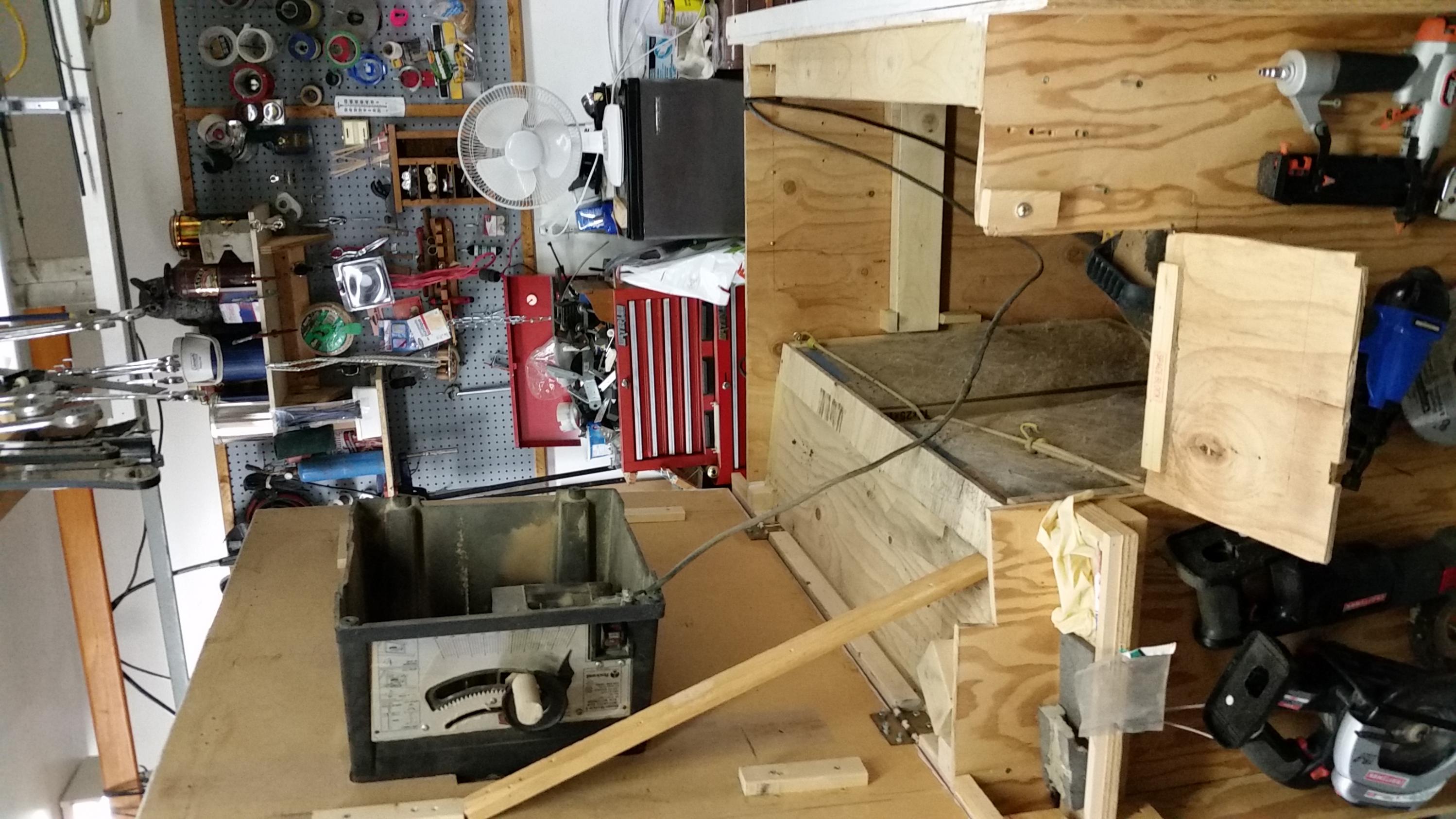

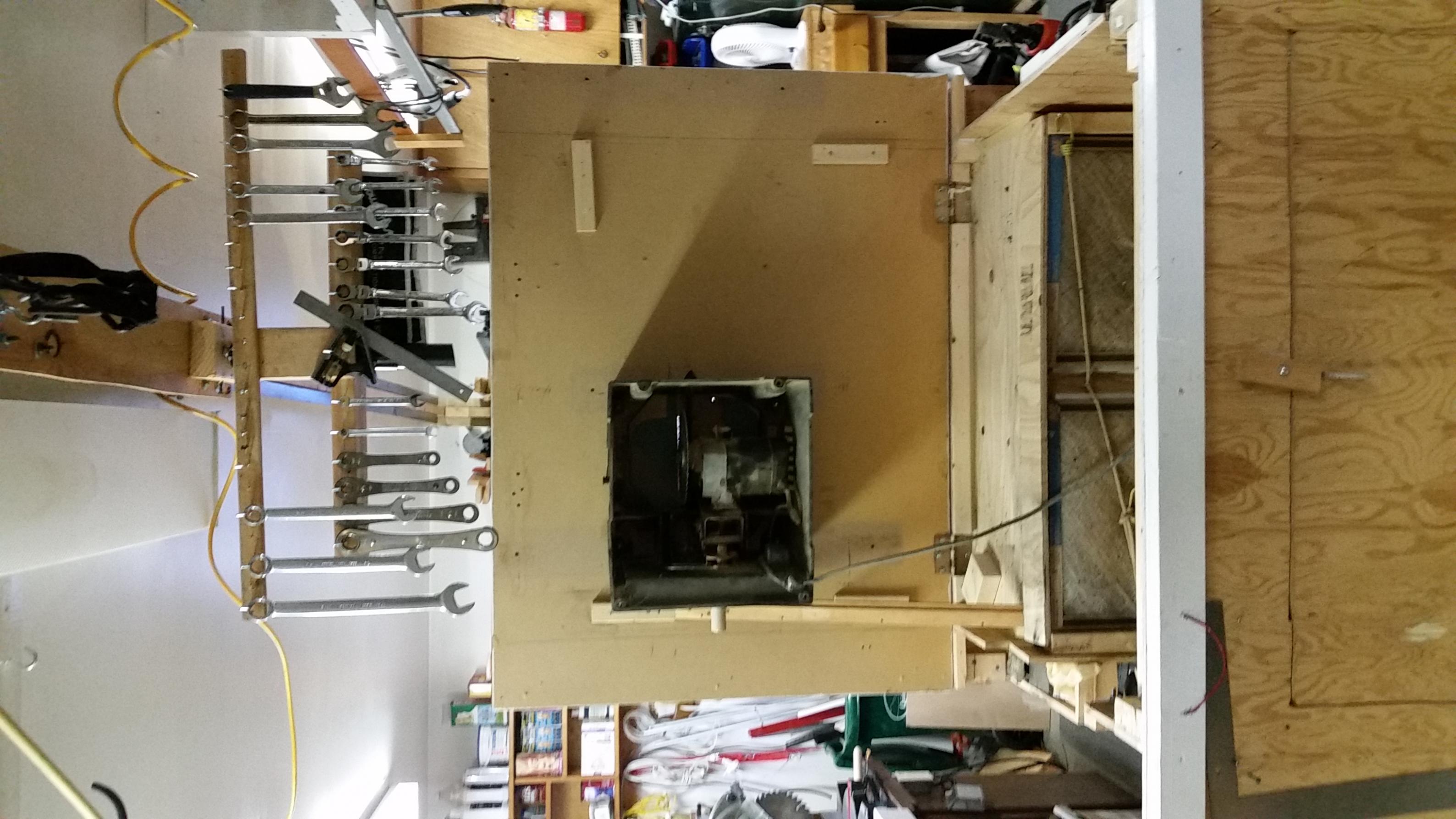

1) Removed my table saw from the stock mount and bolted the saw to the underside of the table.

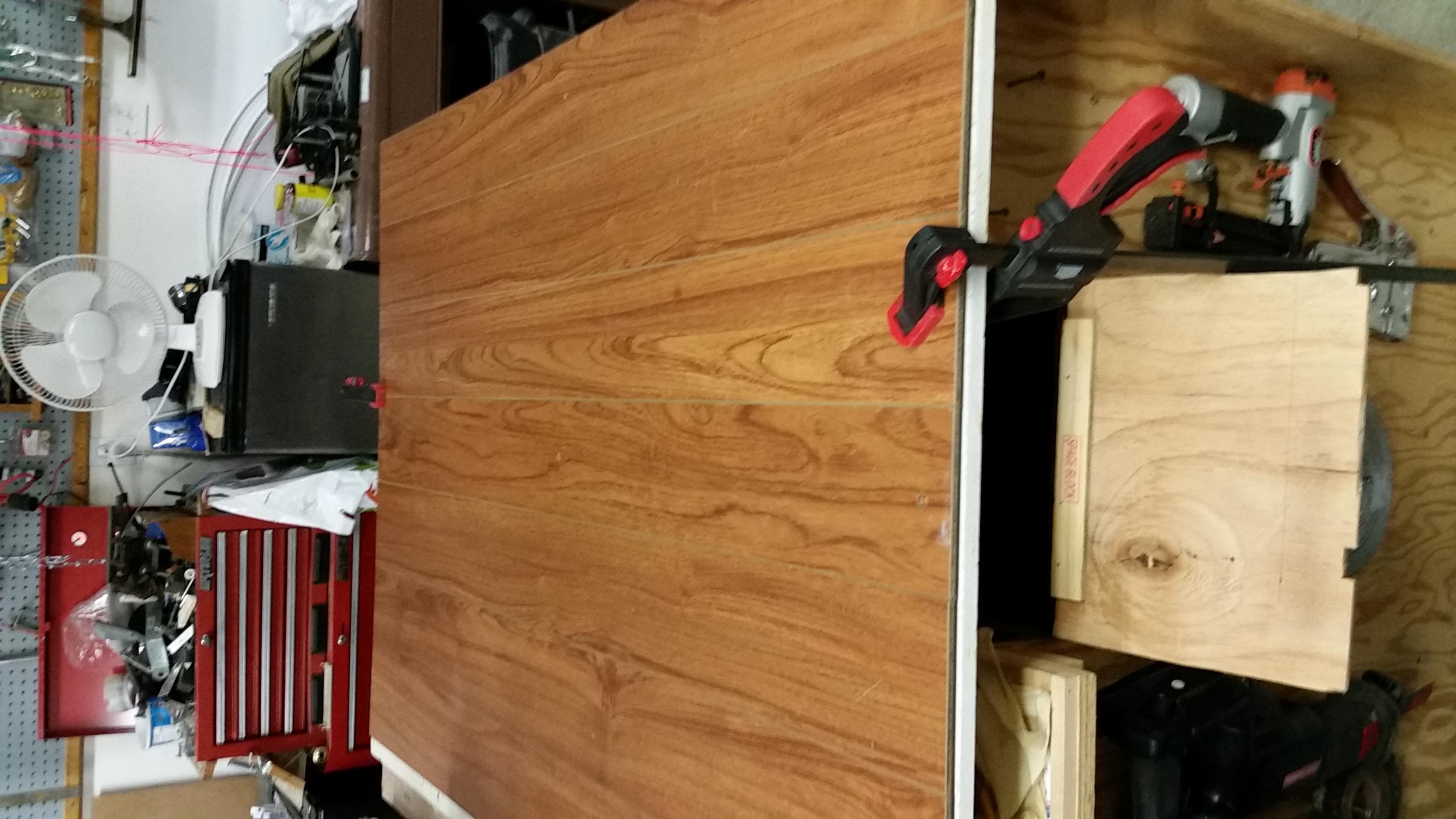

2) Added a new top Laminated MDF interlocking flooring boards.

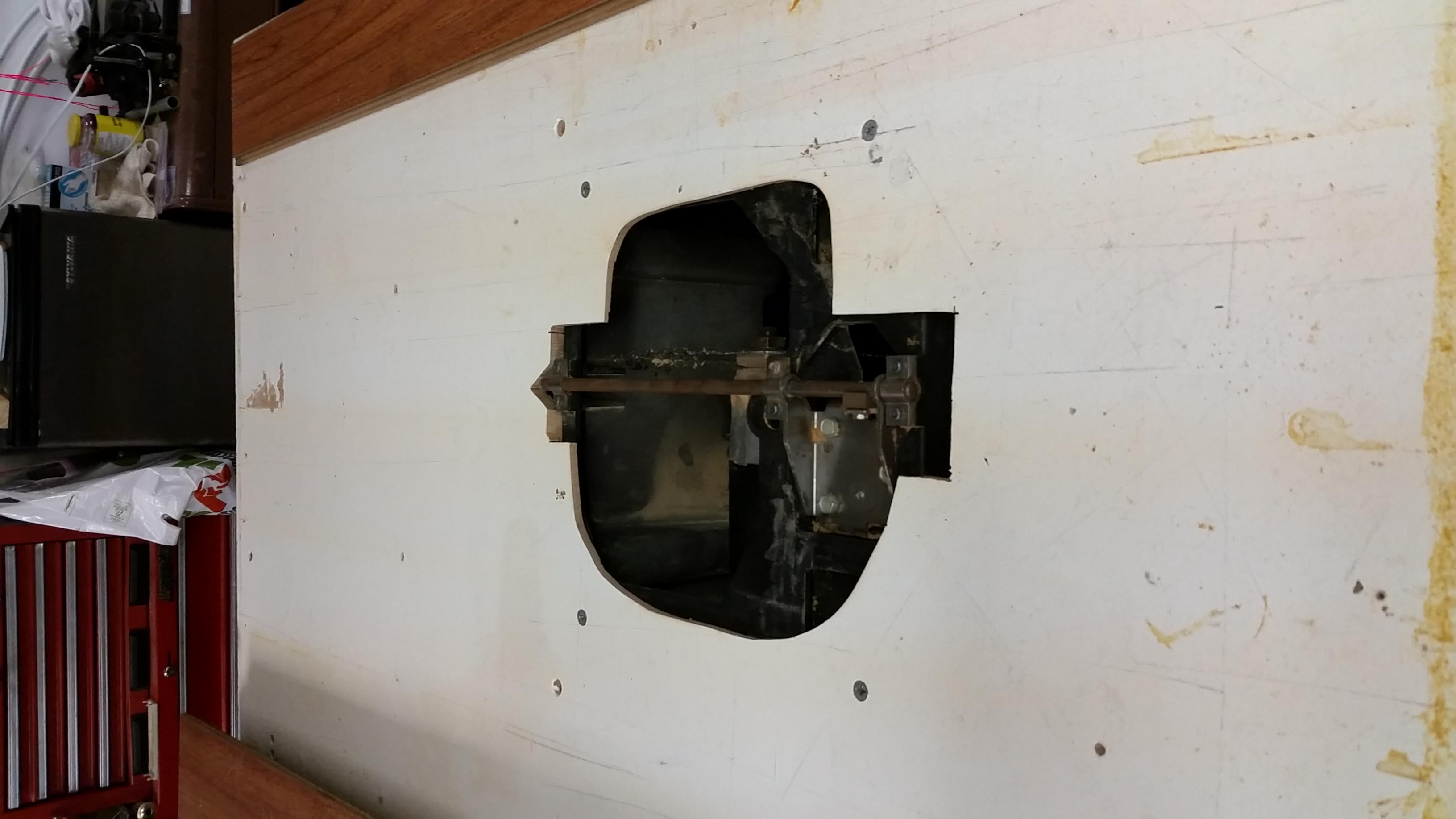

3) Start the saw & raised the blade to max and now have a small 'blade' hole in my table top.

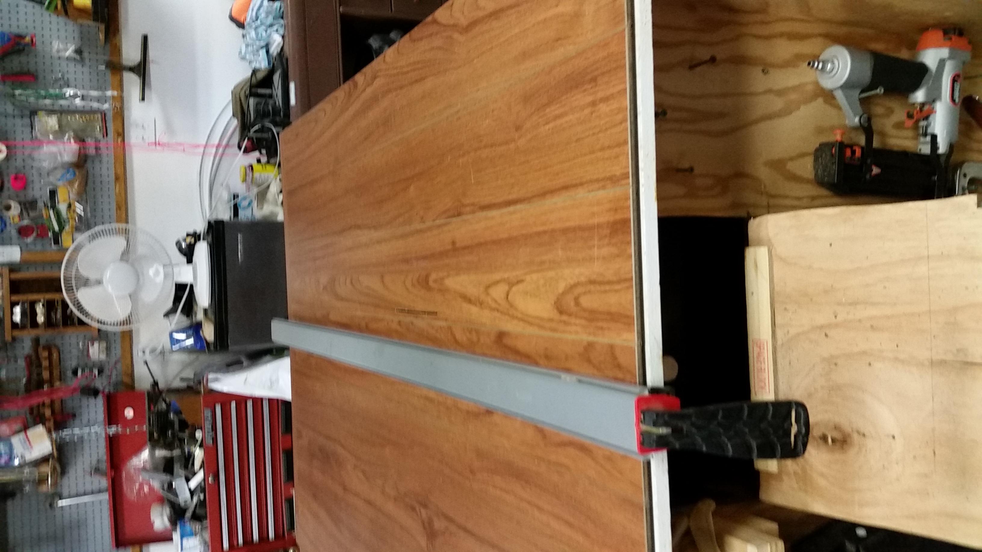

I use my locking, portable guide to properly set align the wood for cutting.
Cuts up to a 2x4. and the side access door sucks in most all debris.
The table is on wheels for larger jobs / location placements and stores my shop Vac.
