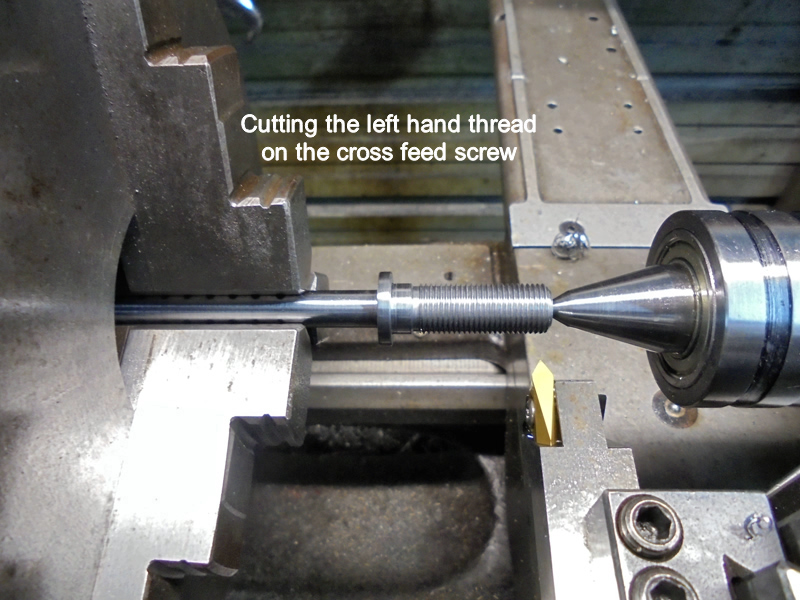

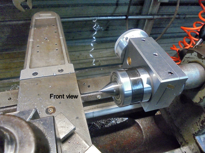

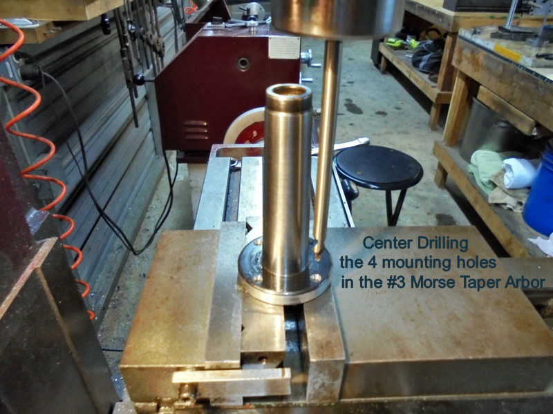

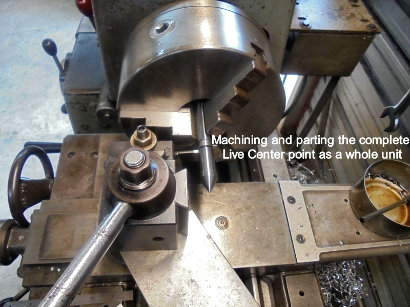

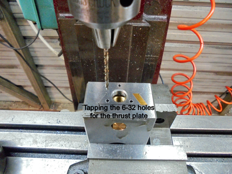

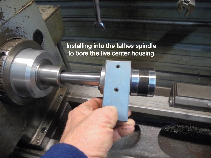

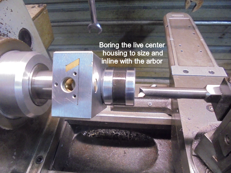

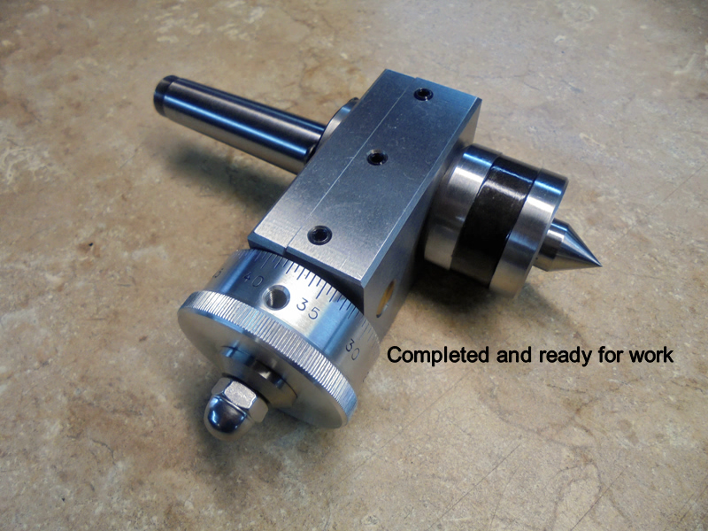

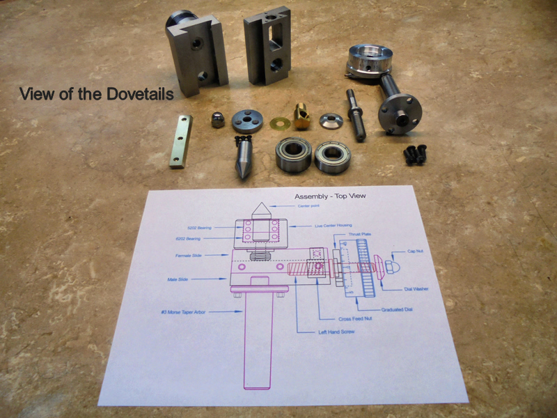

So by using the same principle as the Boring Head I came up with this dedicated tool that I call the Tail Stock Taper Turning Attachment.

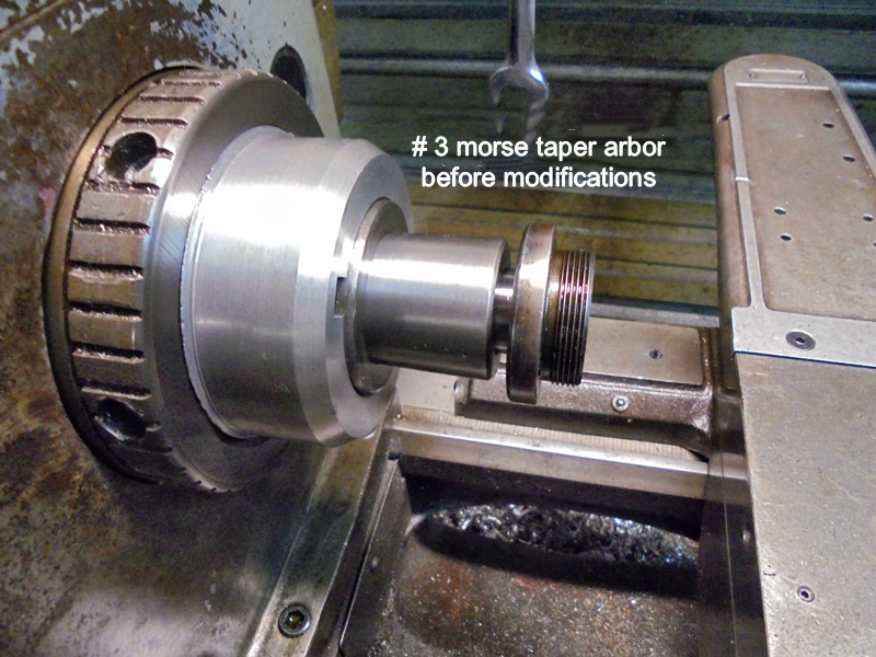

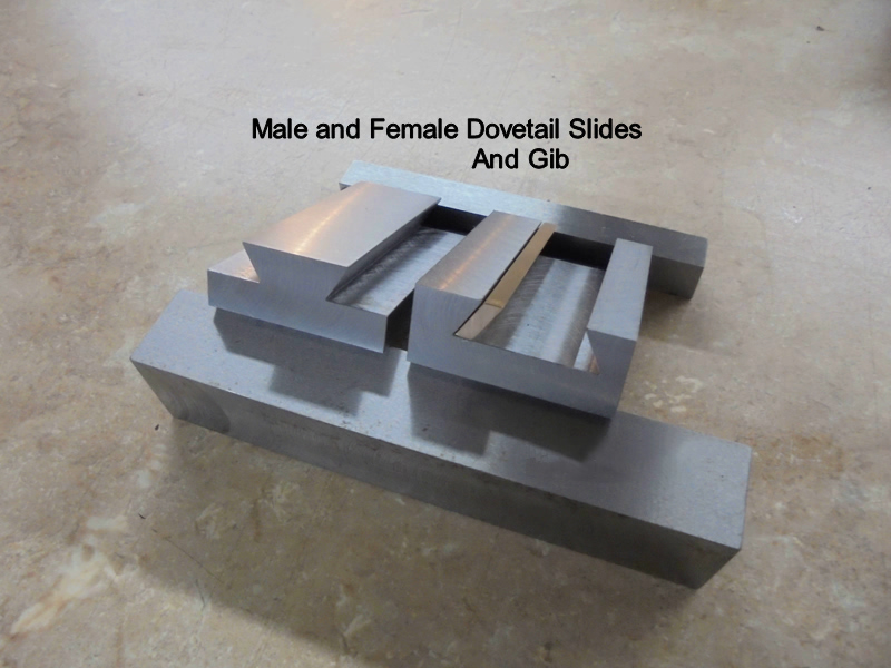

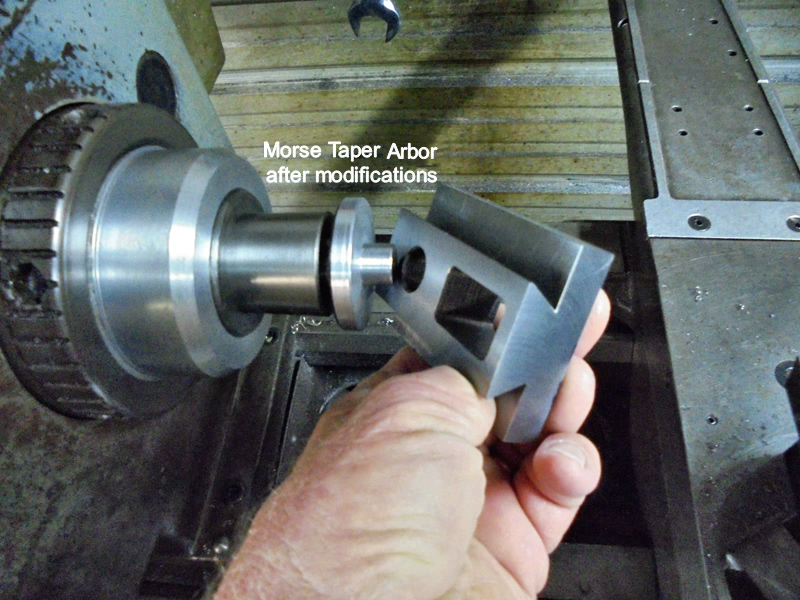

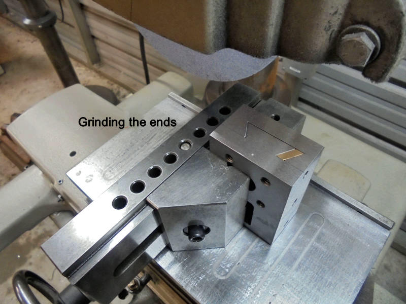

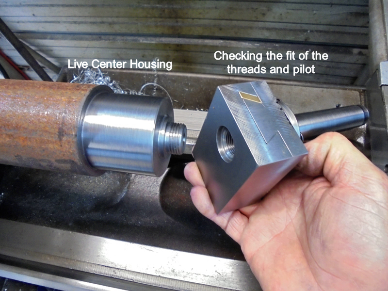

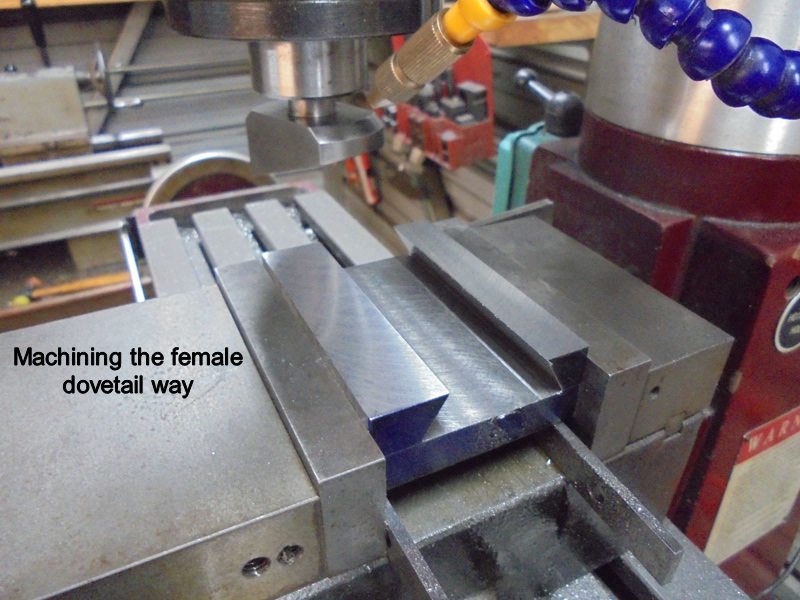

This tool consists of a Male and Female Dovetail Slide, It has a Live Center fixed to the Female Slide and a #3 Morse Taper Shank fixed to the Male Slide, I had a new #3 Morse Taper Shank with 1.500”-18 threads which was originally designed for a Milling Machine Boring Head that I modified and fixed to the Male Slide, the offset of the Live Center is adjustable by means of a left hand screw and a Graduated Dial that has one hundred .0005” increments engraved on the circumference for precise adjustments, the unit has an off center movement of 11/16” which will cover most any taper I desire.
This tool can be set to cut any angle, just indicate the live center in with the headstock of the lathe then set the graduated dial to zero, with some simple math you can then move the center over the amount require to cut the angle you want.

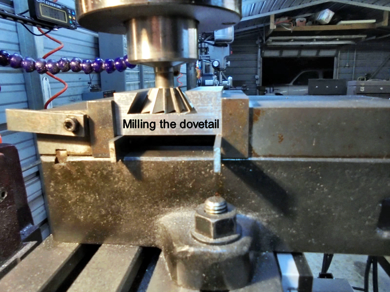

Everything pictured in this post was made from brass, aluminum and alloy steels, I have included multiple photos of the machining processes, a couple videos of the graduated dial being engraved and numerals being stamped, along with a video of the completed tool being used, I am not an actor nor a narrator so excuse my repeated words and or my fumbling for words in the videos.
Captainleeward made a tool similar to this one back inDecember; I made a comment in his post that I was in the process of making something similar to his at the same time.
Below are some photos of the machining processes and three videos of the tool being made and operated.
