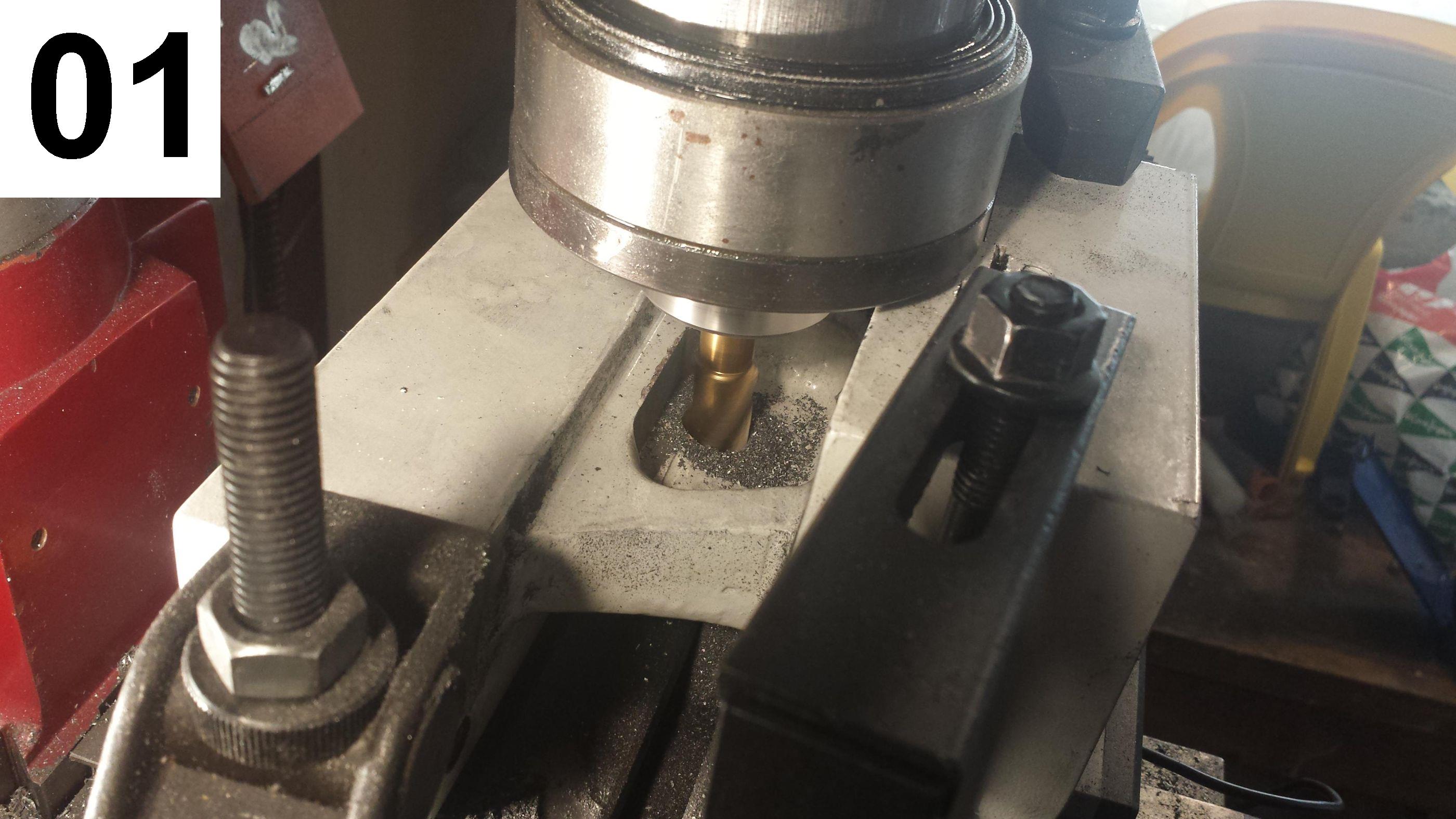

    Milled hole in tailstock with 16 mm end mill. (drilled it first)

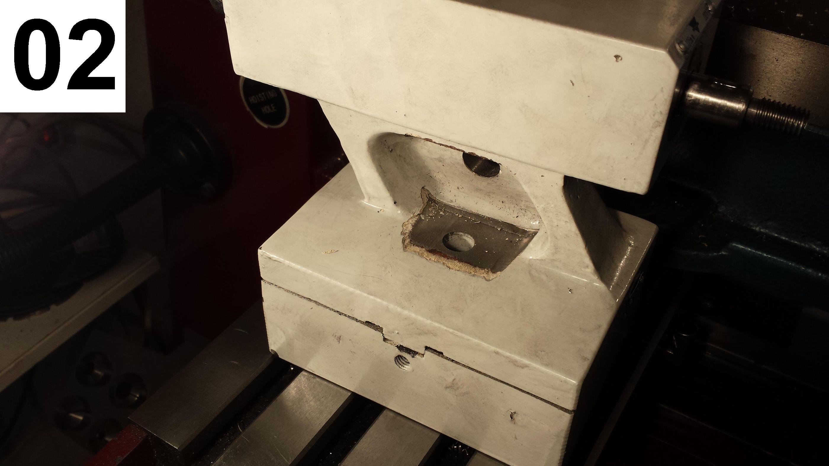

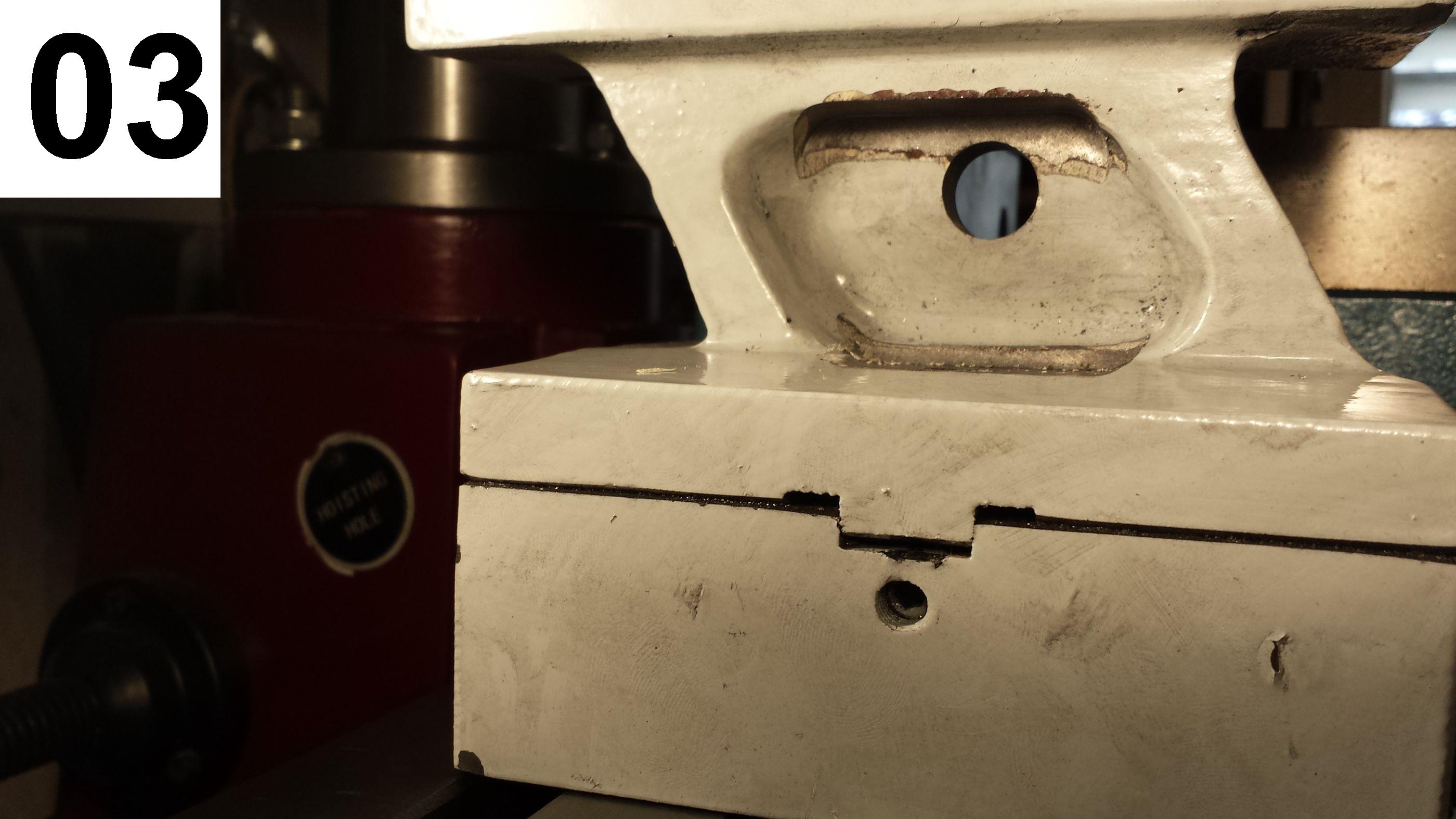

    Pictures 02 and 03
    Milled bottom and top of oval shaped cavity in order to install frame block.
    Had to remove coating and some cast iron in order to have flat bottom and enough room on top.

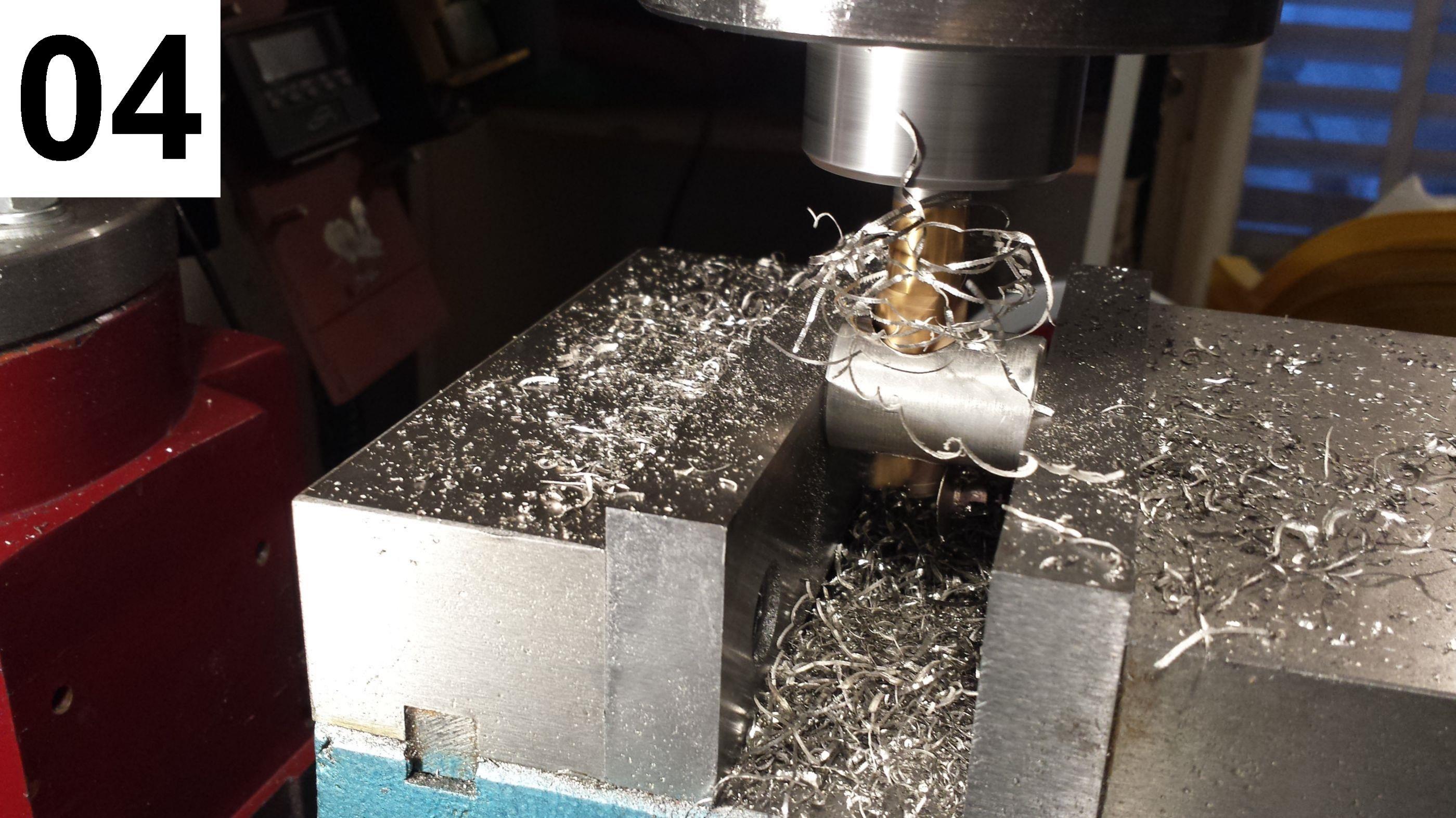

    Milled piston hole with 16 mm end mill.

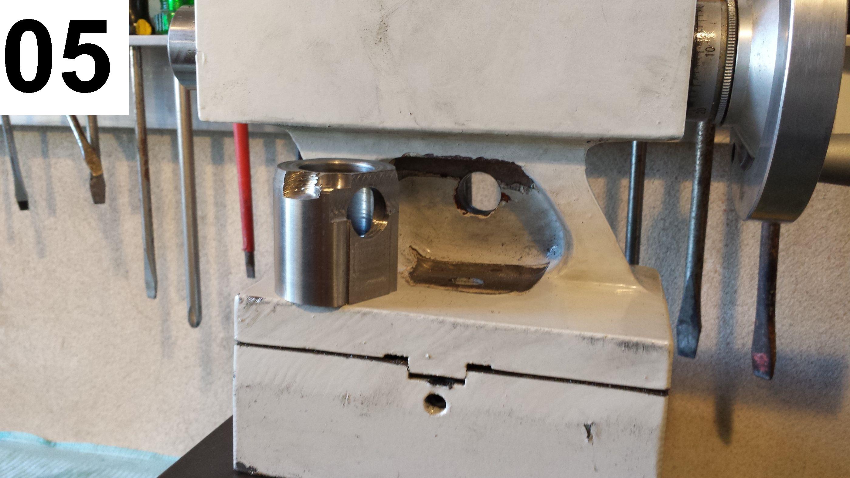

    Also had to remove some material at frame block (piston housing) in order to fit inside cavity.

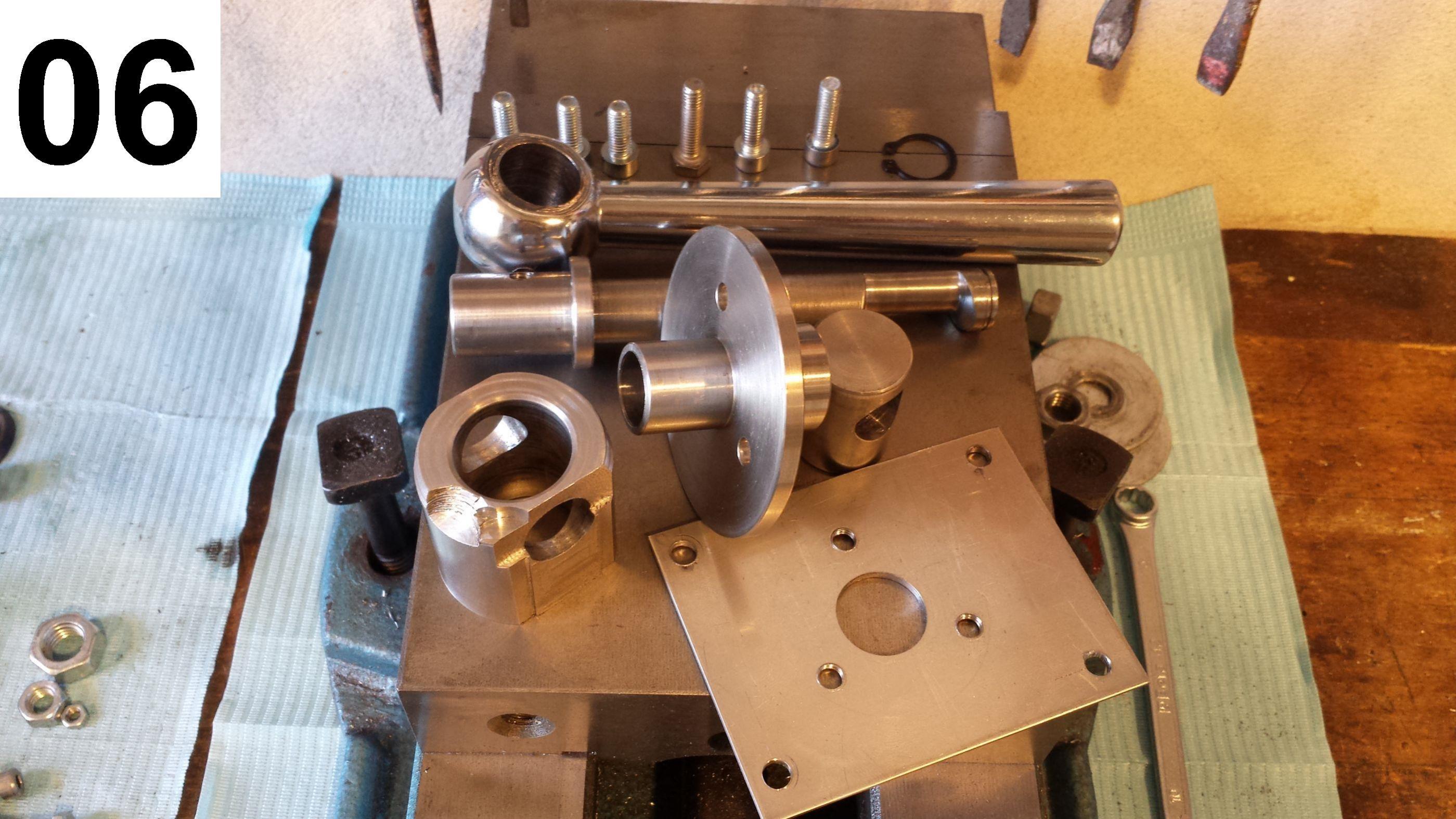

    Picture 06
    Parts. All made from stainless steel except snap ring and chrome plated handle

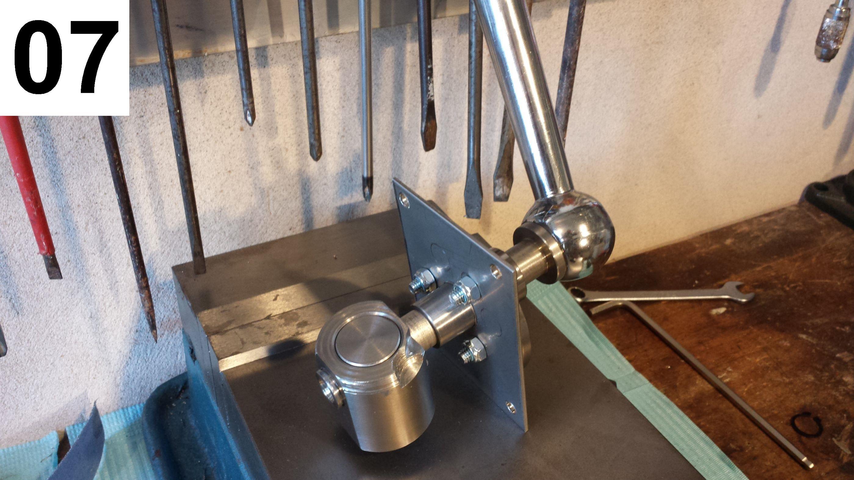

    Picture 07
    Parts assembled on top of milling vise (locked position)

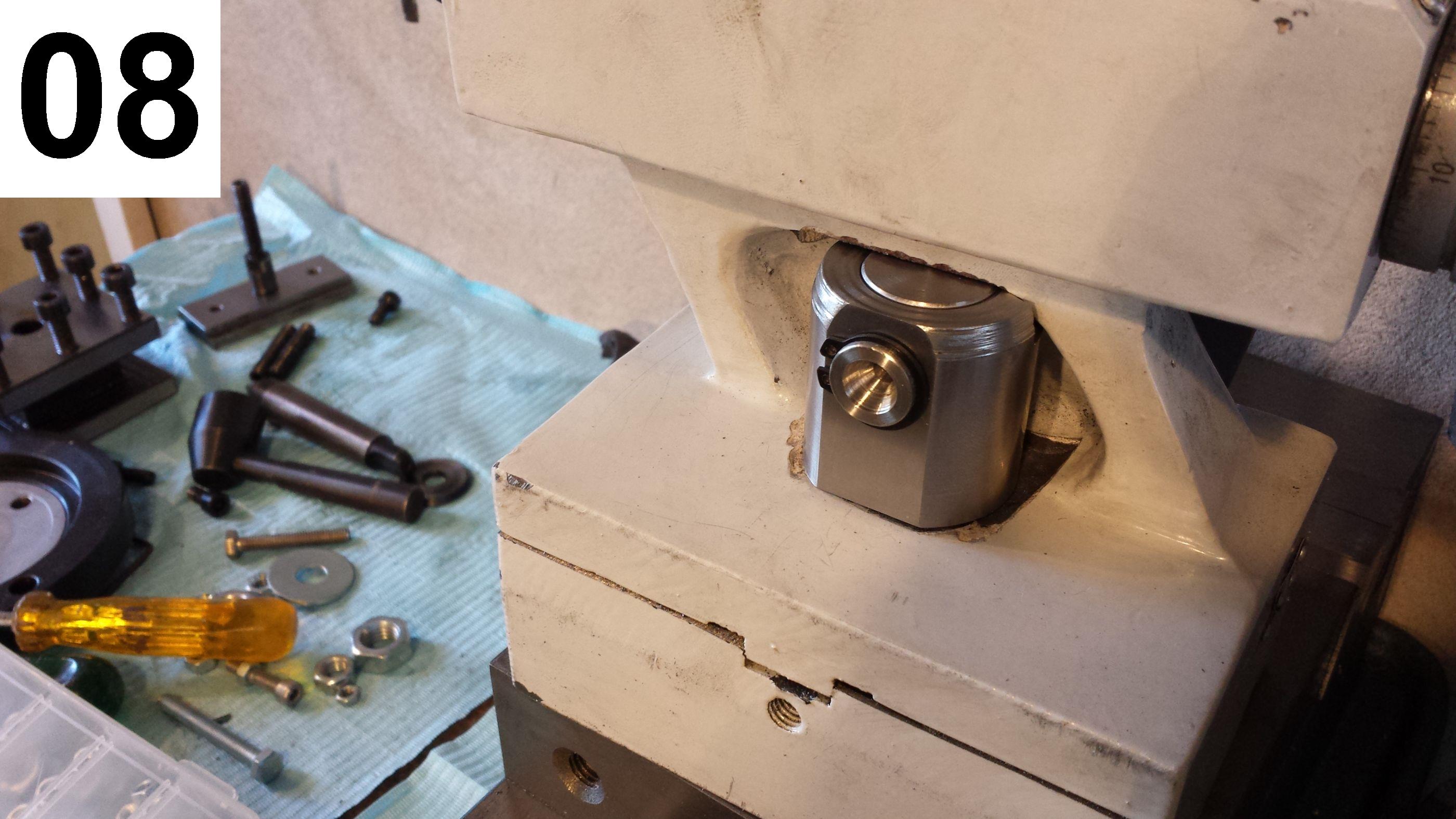

    Picture 08
    Front view of tailstock (locked position – piston up)

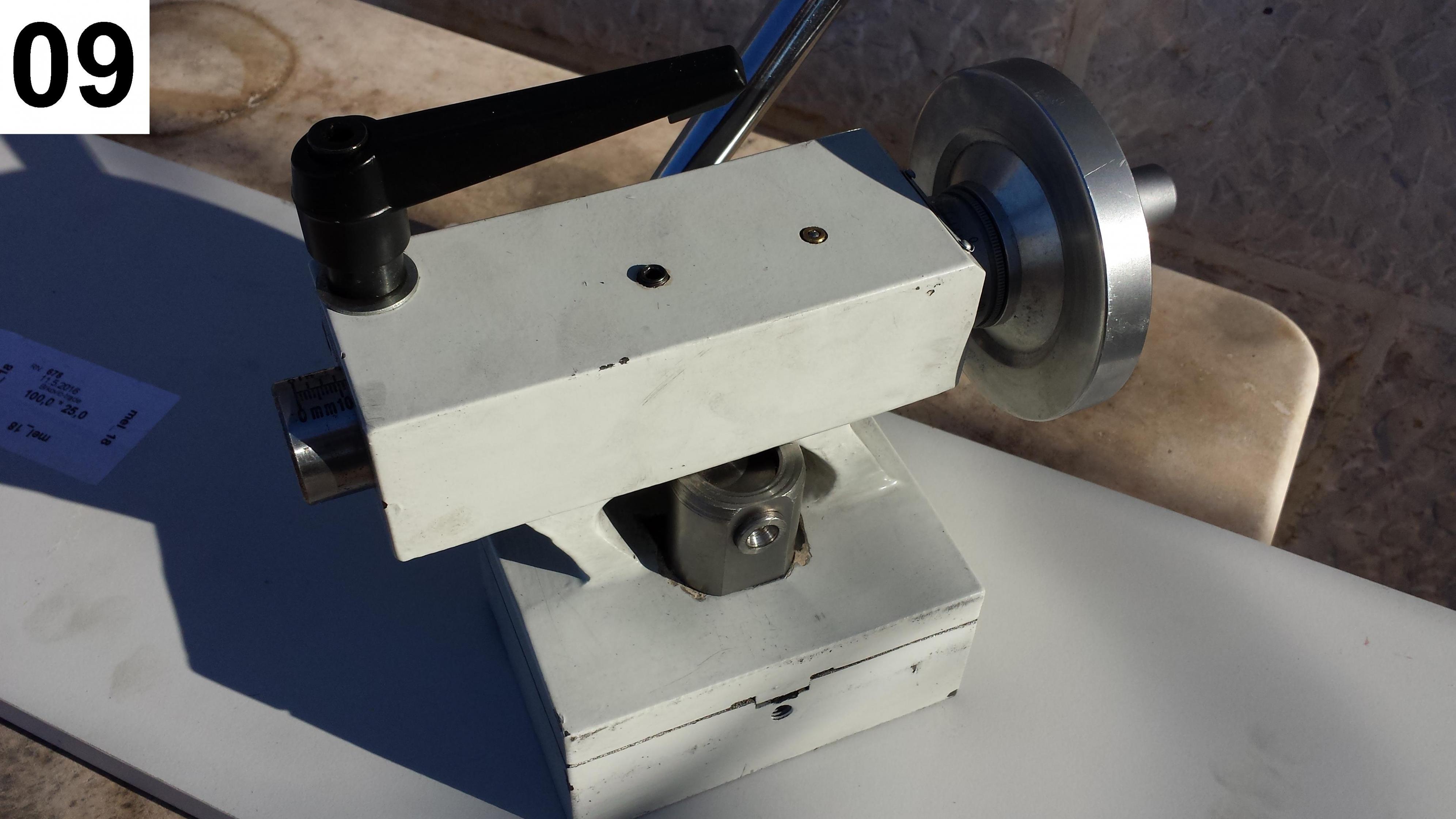

    Picture 09
    Front view of tailstock (unlocked position – piston down) Note that handle can not go more down as the bottom of the piston is already touching the tailstock.

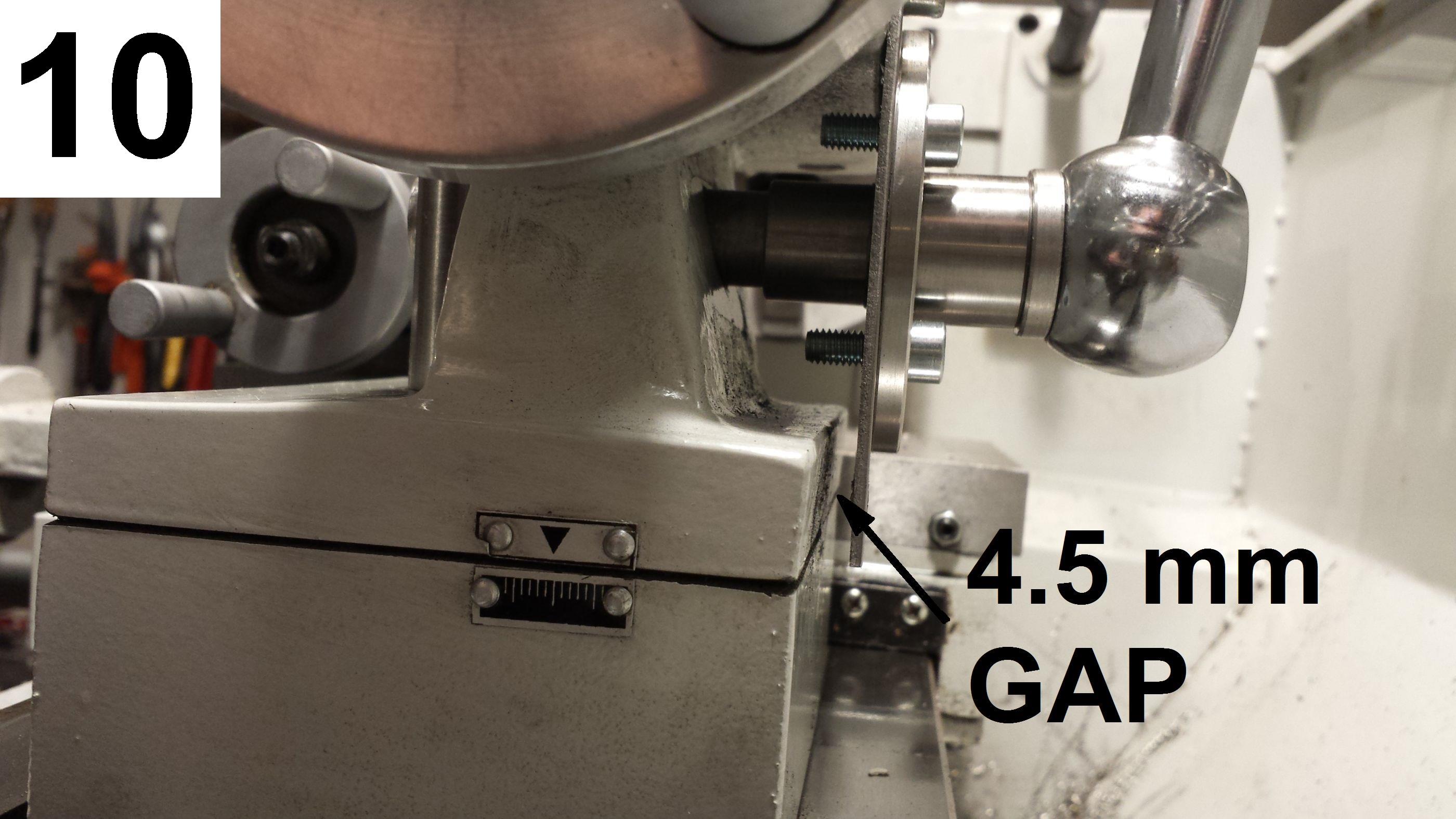

    Observe 4.5 mm gap and sloped part where shaft is passing through. I still think that whoever designed this tailstock did it intentionally just in order to turn away people from making this modification and to make it harder.

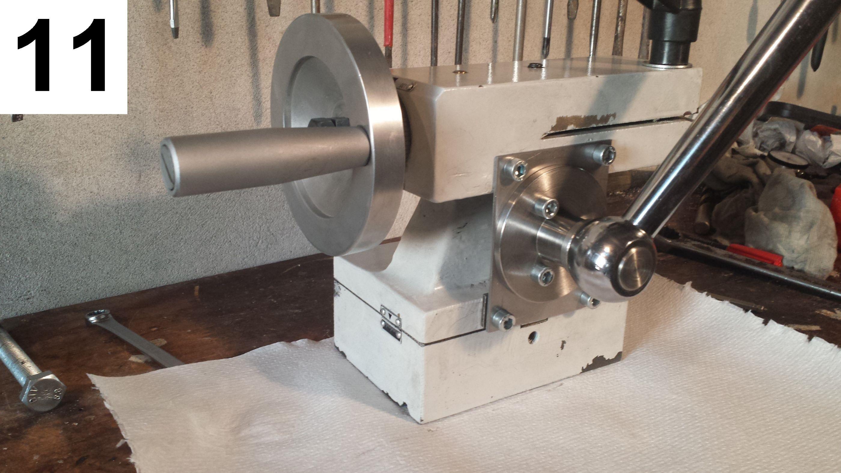

    Picture 11
    Back view. It is visible that piece of 3 mm flat bar is placed at the place of the gap. Also put 2 washers there. Didn’t have flat bar of 4.5 mm thickness and I was too lazy to fabricate it.

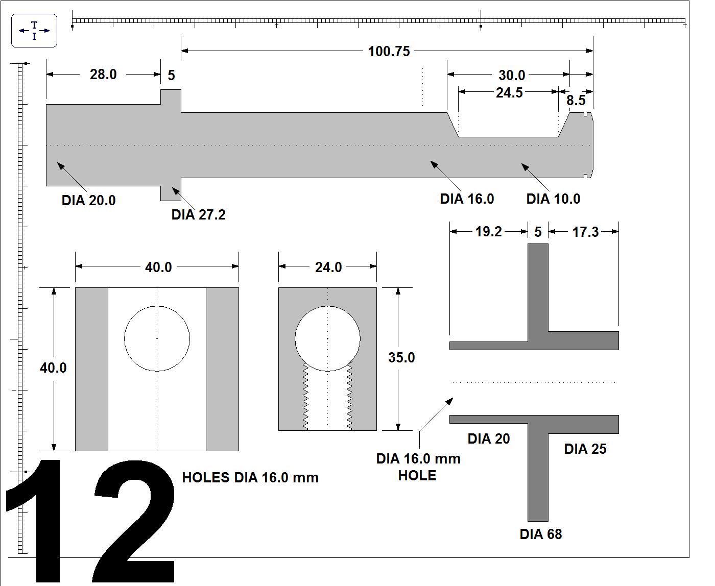

    Picture 12
    Drawing with exact dimensions

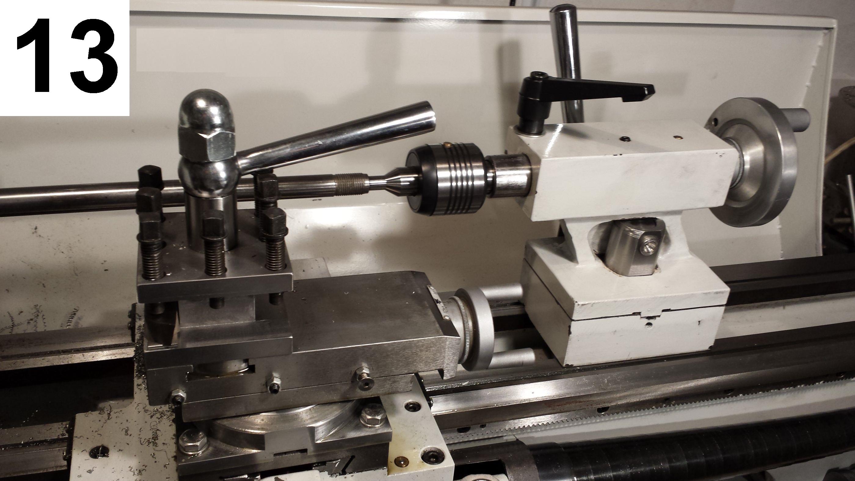

    Picture 13
    Cam Lock in use - locked position
