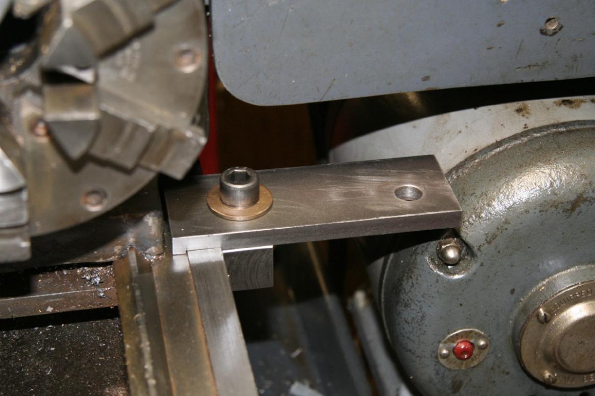

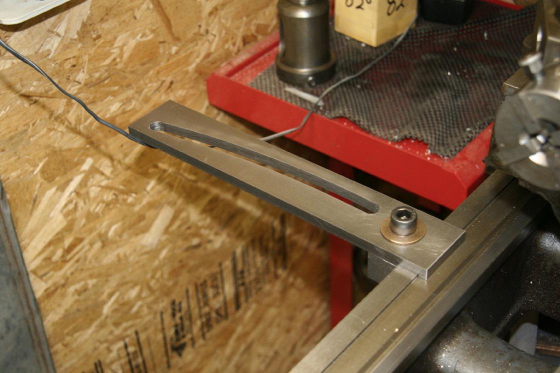

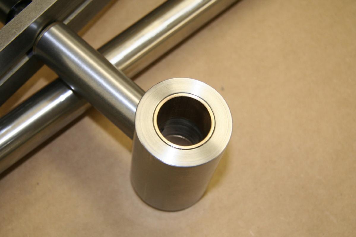

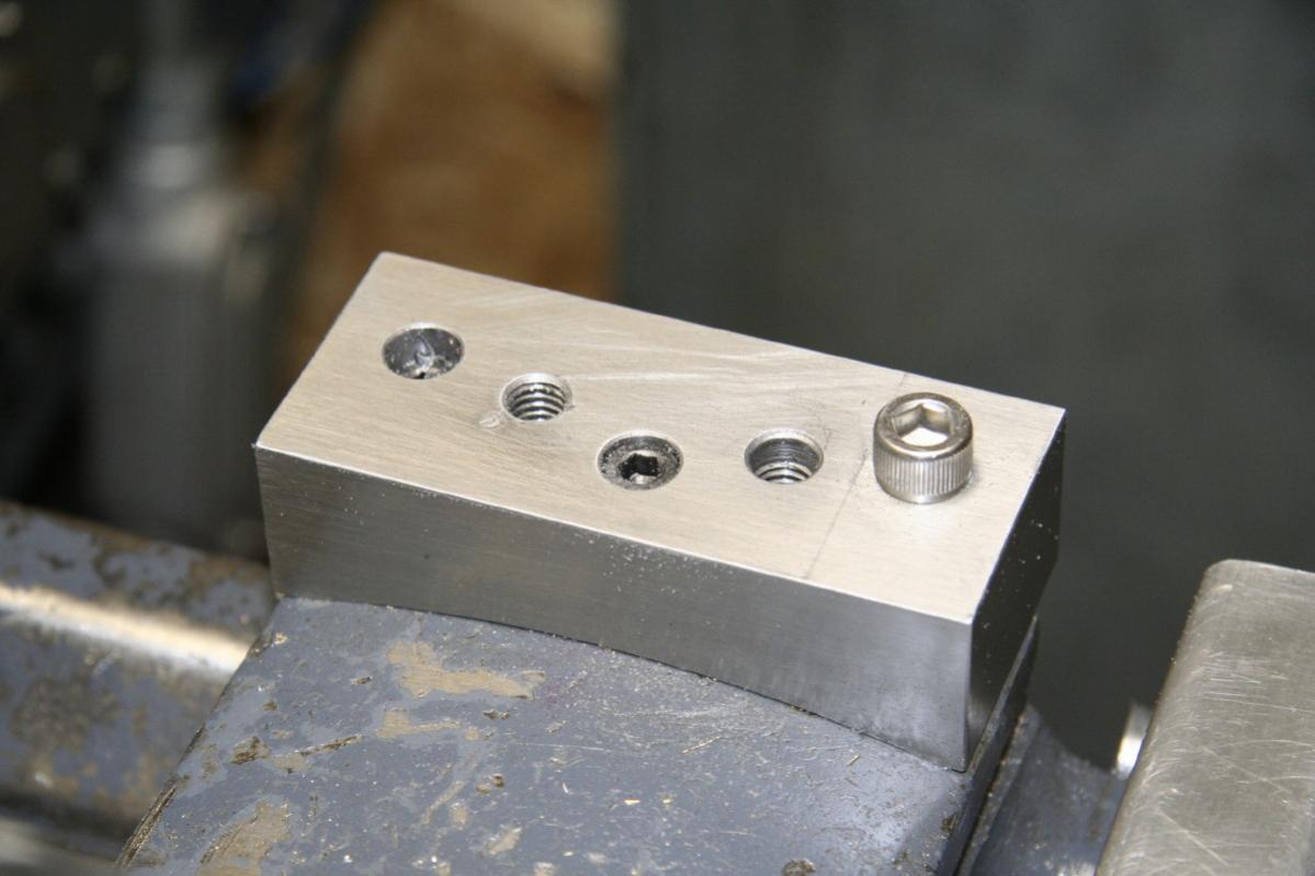

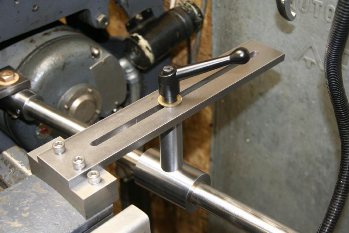

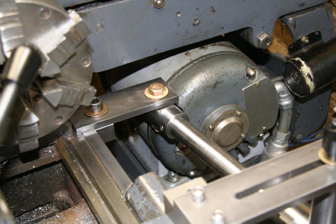

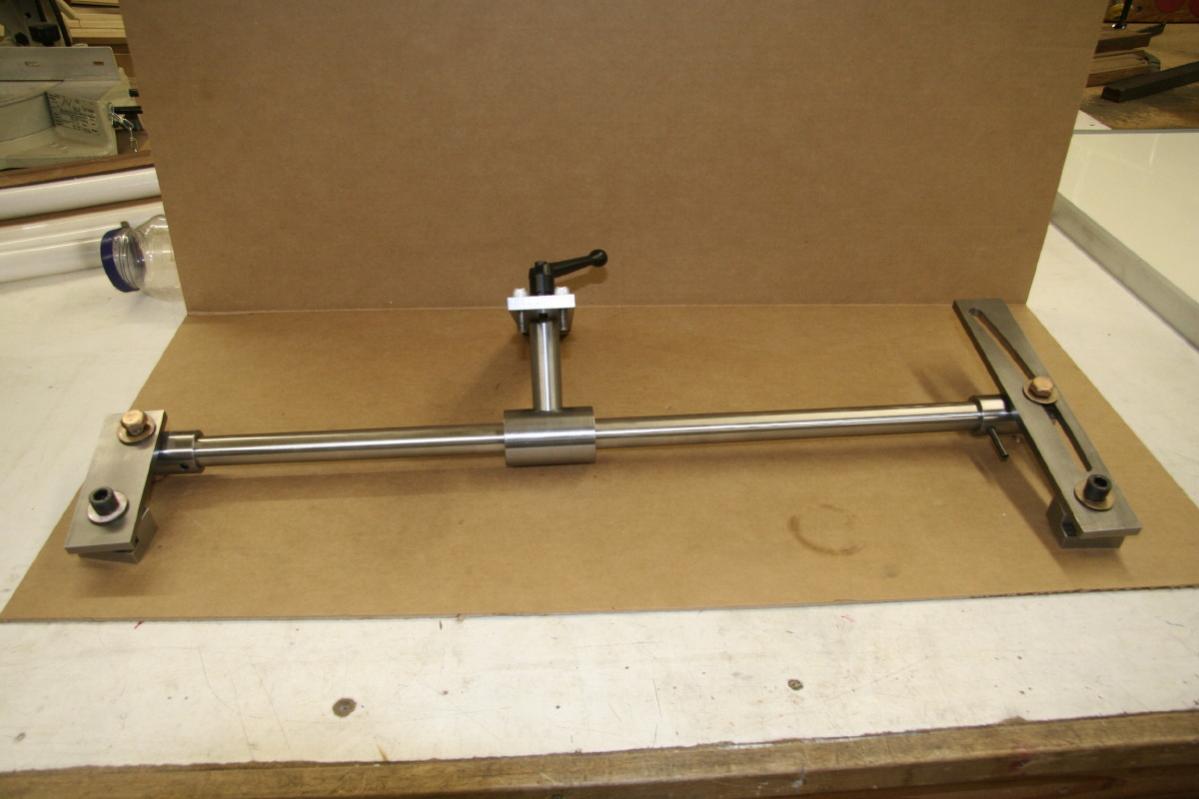

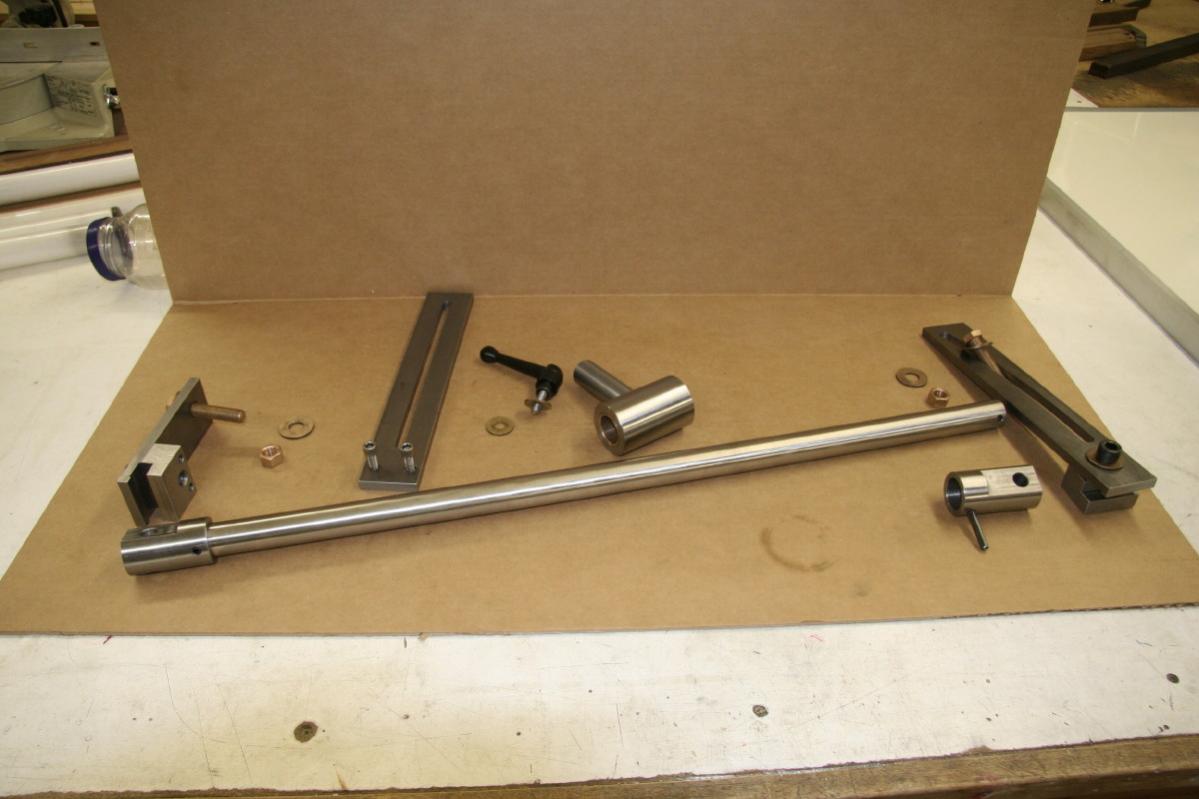

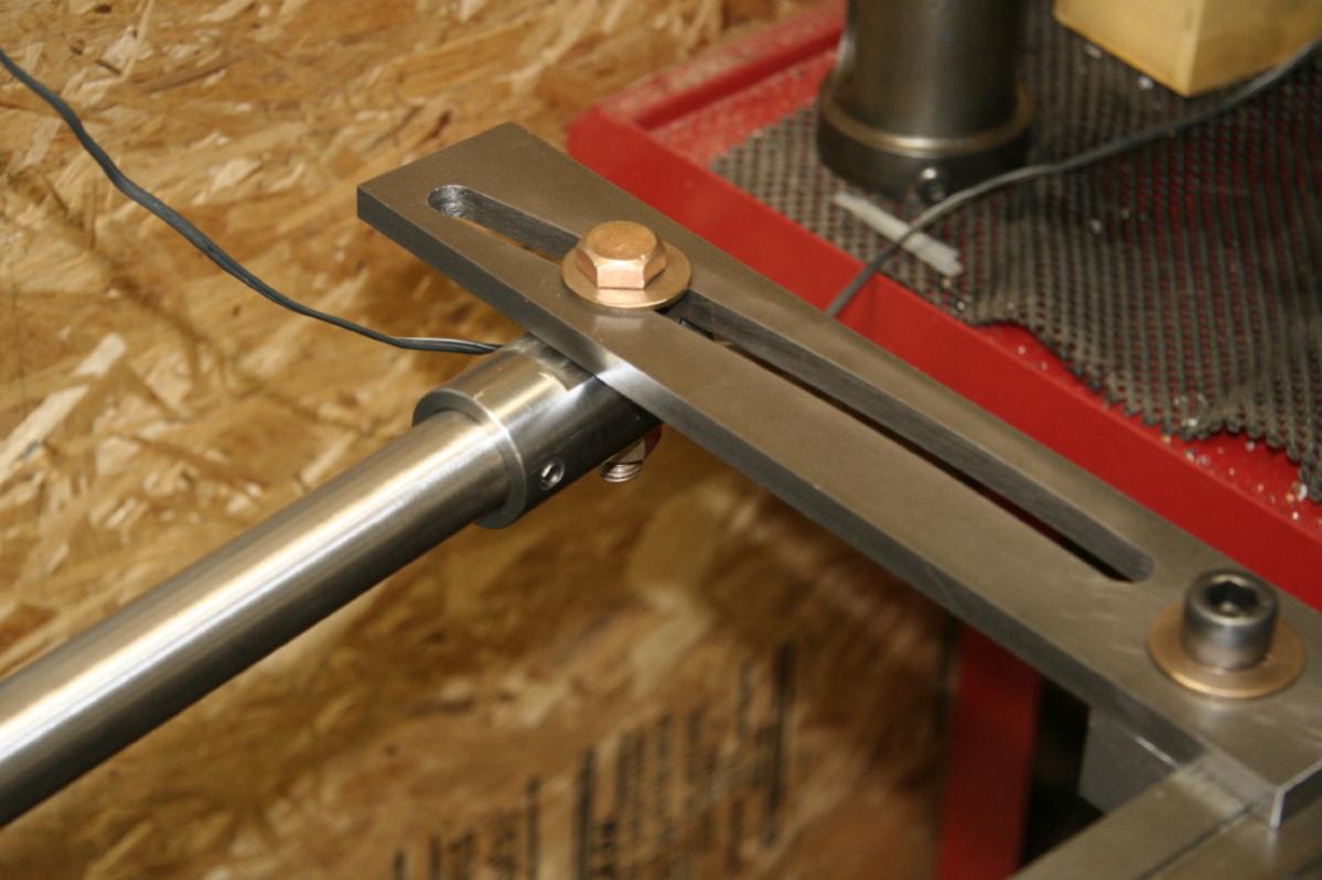

Taper Attachment for 11" Logan Lathe
My new Taper Attachment for my Logan 11' Lathe. Materials, 3/8" x 2" CRS, 1" x 1-1/2" CRS, 2" dia CRS, 1" dia. CRS ,1-1/8" dia oil Impregnated bronze, 1/2"-13 SHCS, 5/16"-18 SHCS, Stainless Steel heavy walled tubing. Works well less than $100.00 in material I had to buy just the CRS. All the rest reclaimed materials. Attachment 1438Attachment 1439Attachment 1440Attachment 1441Attachment 1442Attachment 1443Attachment 1444Attachment 1445Attachment 1446
