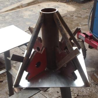

I decided that I would make a smaller version of my pipe stands.

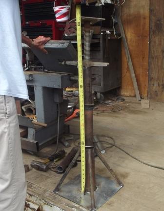

Problem #1 they needed to be 14" or less in height when collapsed #2 they had to be able to be used on bare soil without sinking #3 they needed to be able to be extended to a height of at least 32 inches

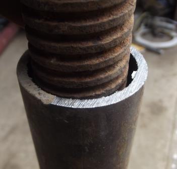

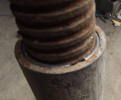

I started out with 12x12" 10 ga plates for the bases 10 1/2" long 2 7/8" oil field pipe for the main post. 2" sch 40 pipe 11" long for the intermediate pipe, 1 1/2" sch 40 12" long for the third pipe and 12" of scaffold jack screw for each stand 3/4" round rod for the support braces.

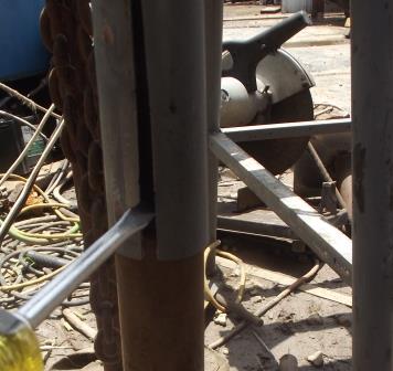

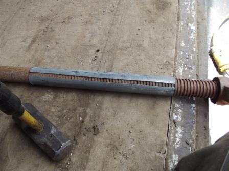

Also to tighten up the looseness between the various stages I used 1 1/4 " EMT and 1.94 16 ga purlin tubing

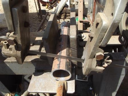

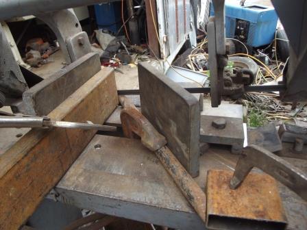

Rather that continuously switching the band saw vice to different angles I simply clamped some scrap at the desired angles to cut the braces
Attachment 10753
Those little fit up magnets are indispensable the angle iron pieces transfered just enough magnetic flux to hold the support braces as well so the entire weldement could be fit up and tacked at once

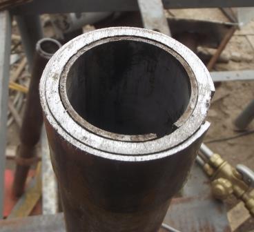

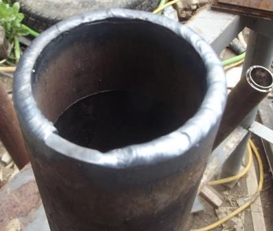

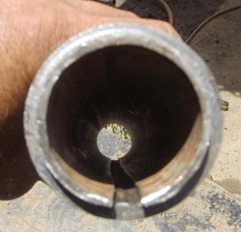

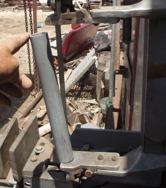

I split the EMT and the other thin walled tubing then spread them to suit the size needed
Attachment 10755 Attachment 10756 Attachment 10757 Attachment 10758 Attachment 10759 Attachment 10760

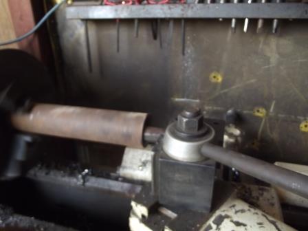

Attachment 10761 Attachment 10762

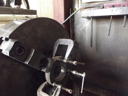

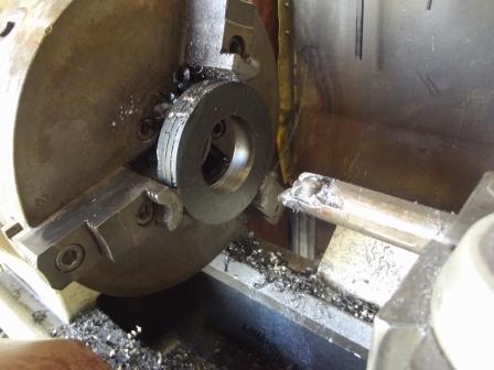

One of these days I need to make me a set of clamping top jaws for my chuck that way I will be able to bore multiple pieces such as this without either tacking them together or using little c clamps
Attachment 10763
Attachment 10764 Attachment 10765 Attachment 10766

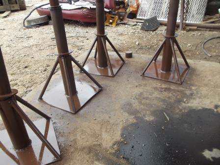

34 Inches would be about the maximum height I could go to 38 but they would be very unstable
Attachment 10767
Leather brown is not my color of choice but I have 2 cases of the stuff and need something that really doesn't matter what color to use some of it up on
Attachment 10768
