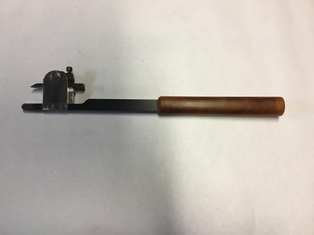

Tenon sizer

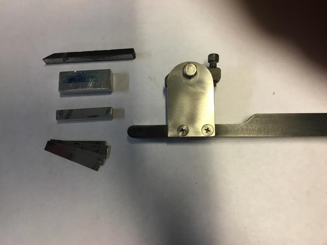

I make handles for a maple syrup equipment co. 150 to a batch and repetition is not my thing so I made a tool to make consistently sized tenons. The cutter is from a hanger queen plow plane and I just vary the shims to a hive the desired size. The blade is 3/8 wide so three passes on a 1 inch tenon and done.Attachment 26748Attachment 26749
