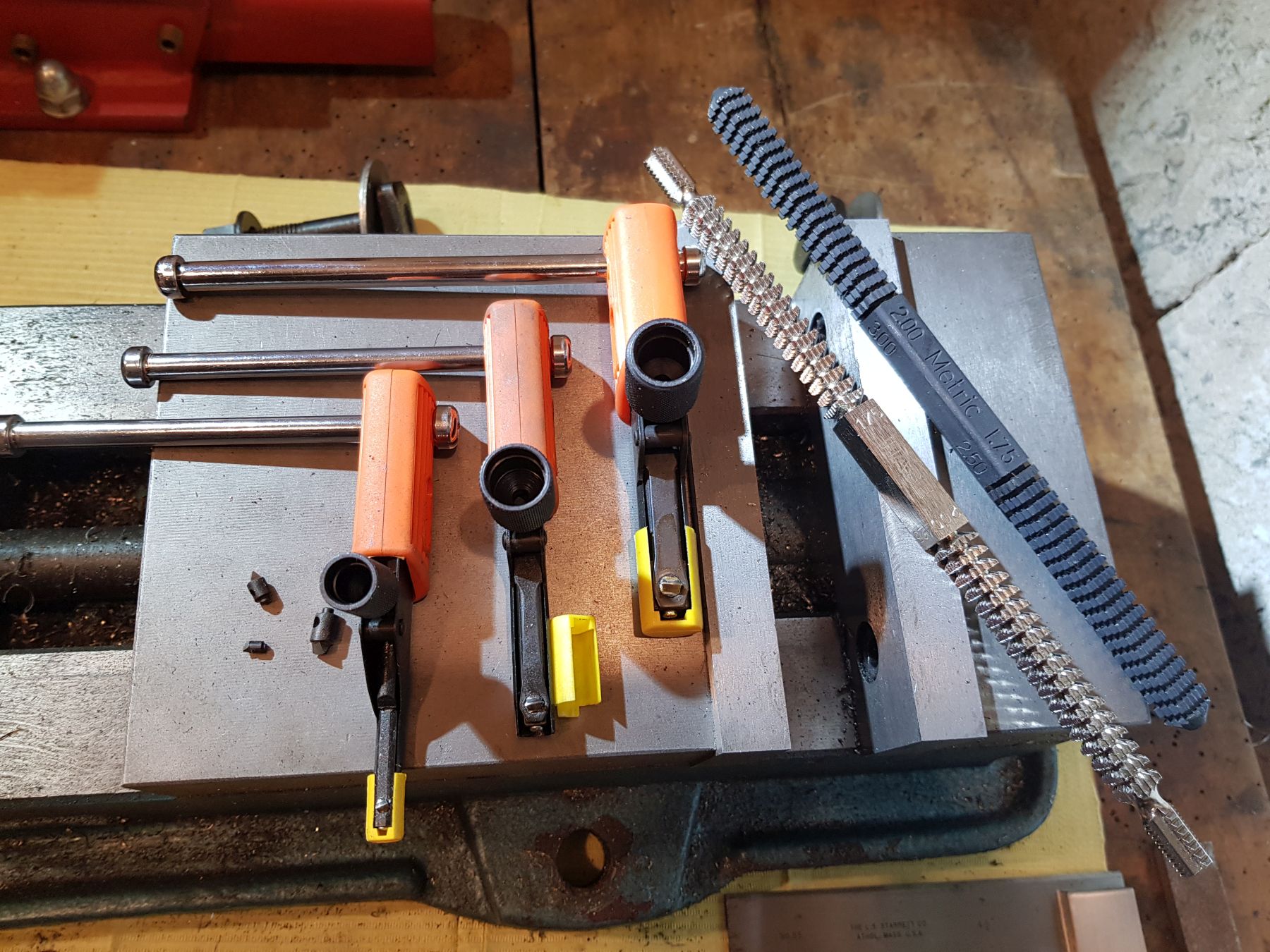

    Thread repair file

    Looks very usefull tool!

    These thread files have been around for longer than I have, still useful in some cases when a threaded part is protruding from a machine you do not need to dismantle but it has to be the right pitch. I find a triangular needle file and eye glass has got me out of trouble many times.

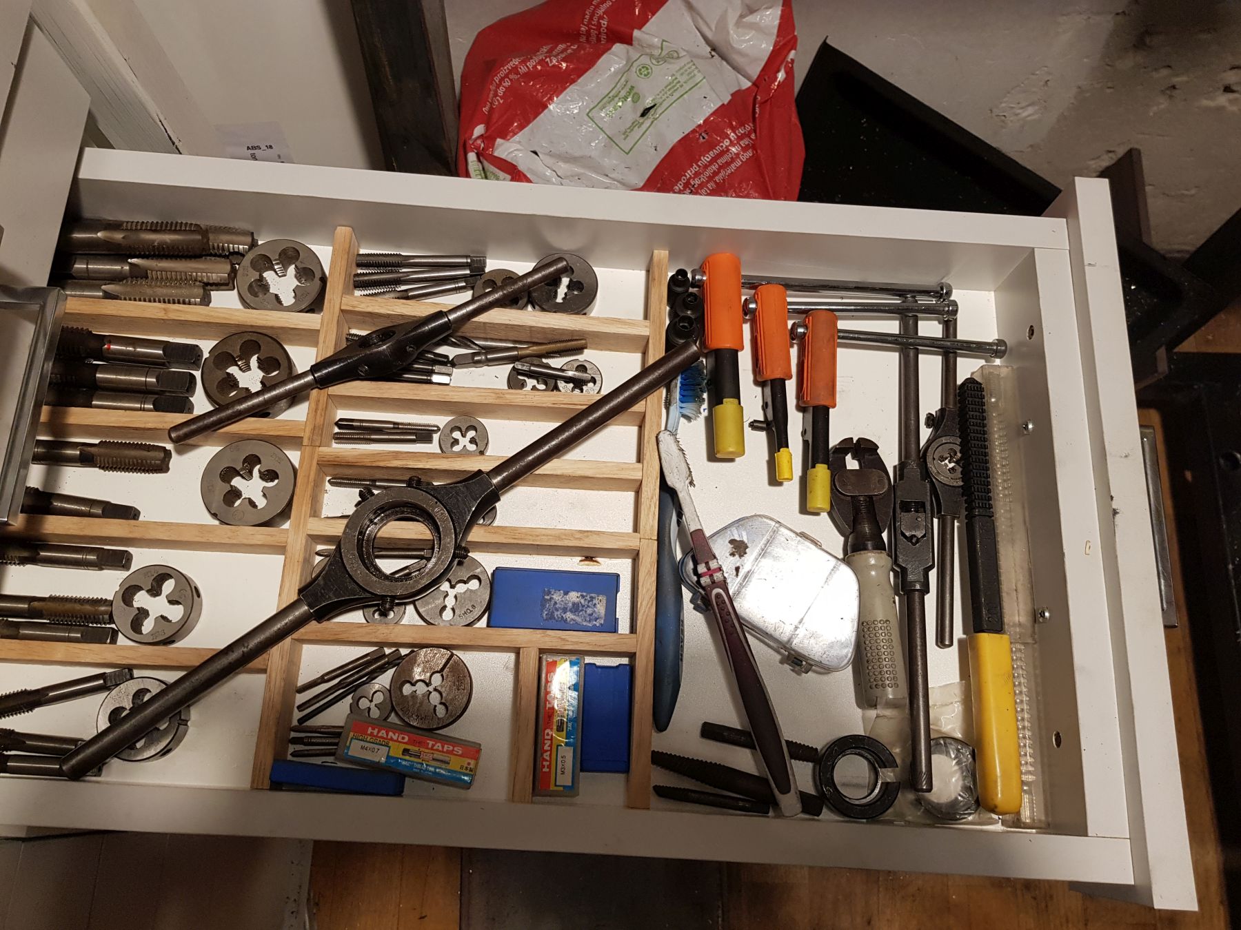

    Very useful tool.
    Inside my threading drawer I have good HASE thread restore file and also cheap Chinese one.
    But one of the best internal restore tool is NES thread repair kit. Have NES1007 3-Pc Internal Thread Repair 3-Piece Set 5/16" - 13/16, M8-20, which I also keep inside that drawer and this is the reason why I don't have plastic case anymore. I got it as a present, otherwise I wouldn't buy that expensive stuff. Used it several times and must say that this one is much better than thread file.
