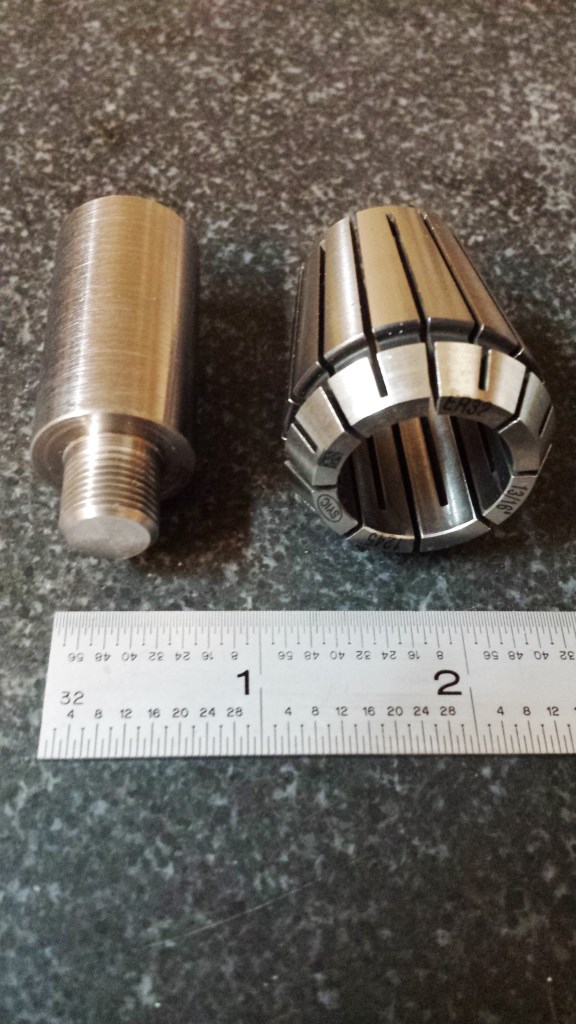

This threaded mandrel fits into a 13/16 ER32 collet (one of the largest sizes of ER32 collets)

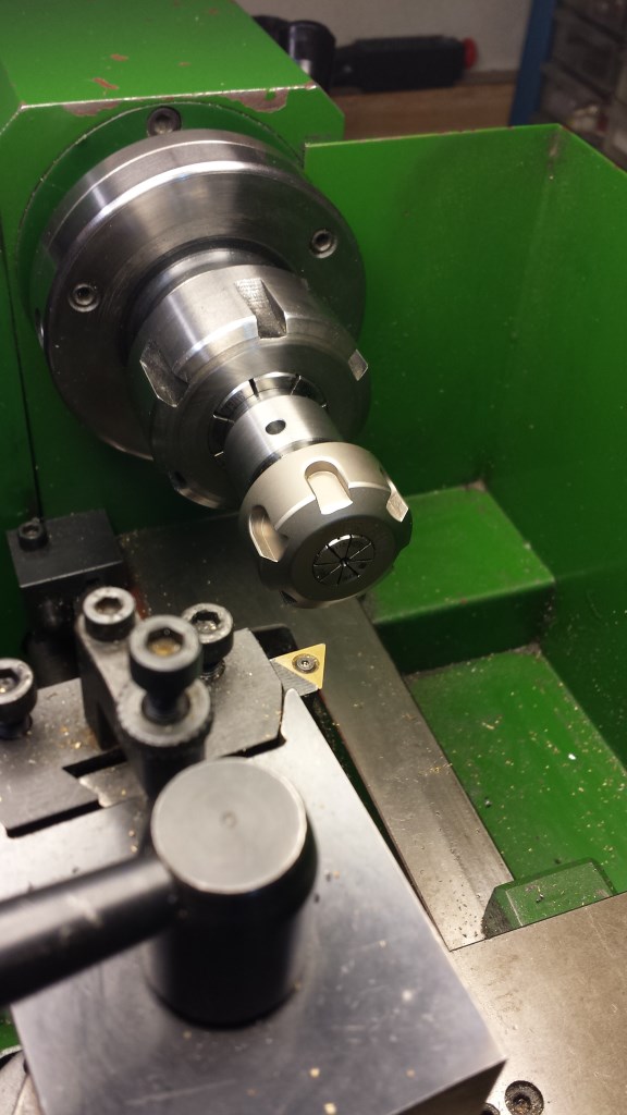

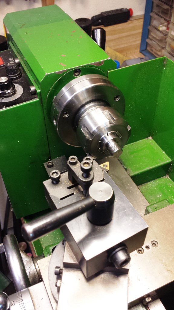

Mandrel installed into the 7" swing mini lathe collet chuck
Attachment 9625

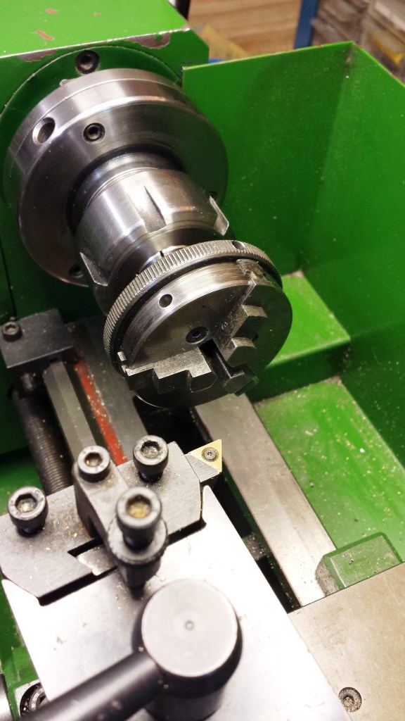

Unimat chuck installed on the mandrel
Attachment 9626

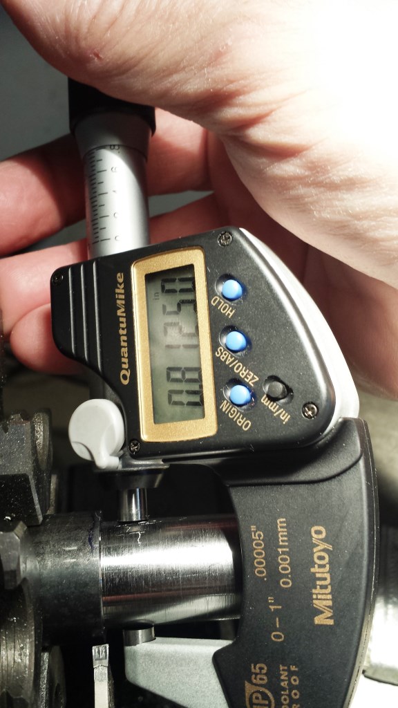

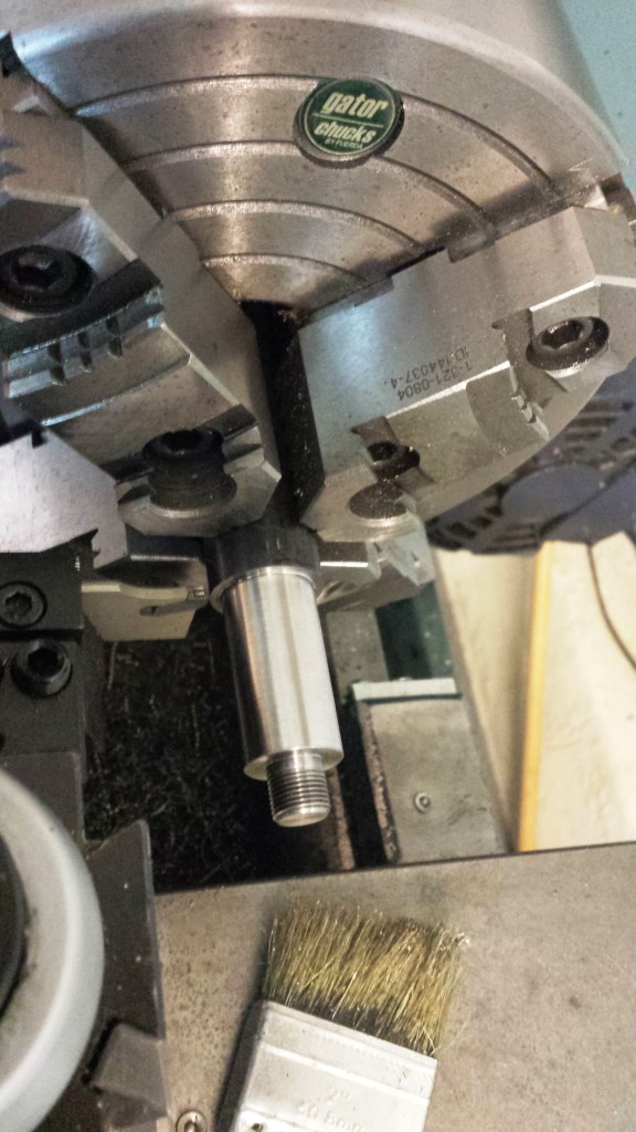

Two construction photos machining the mandrel to exactly 13/16" diameter using my 12" swing geared-head lathe. I consider the machining performance of this 12" swing lathe is very good after making several adjustments and mechanical improvements (see my other postings for the lathe).

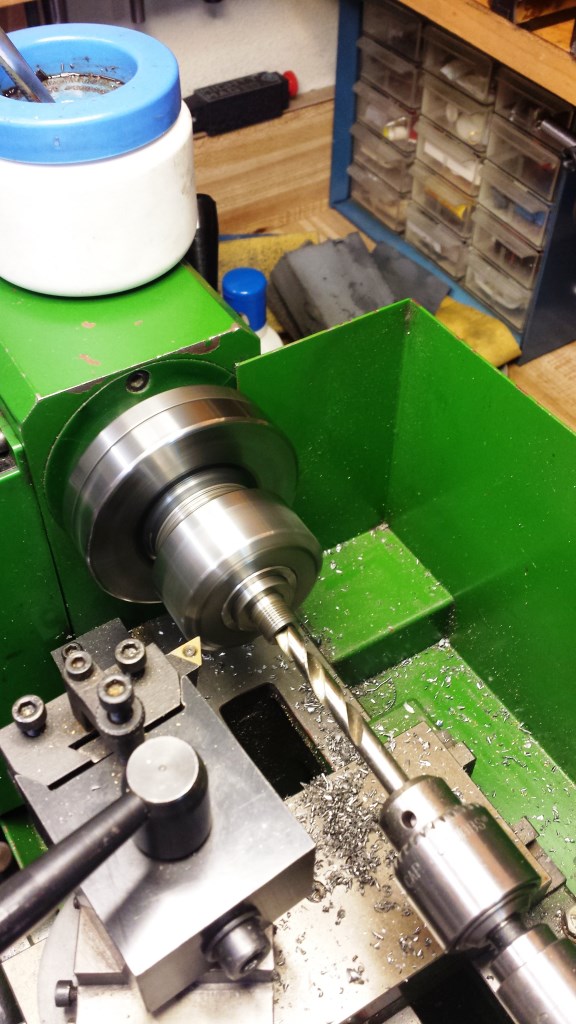

Started to use the Unimat chuck on the mini lathe and found the mandrel required a thru hole just like the spindle of the Unimat SL 1000 lathe.

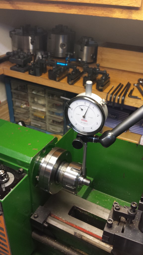

Before starting to drill with a center drill, the mini lathe ER32 collet chuck, 13/32 collet and threaded mandrel were adjusted for a TIR of 0.0005" (which is about as good as it gets with this circa 1993 mini lathe with its original headstock bearings). The collet chuck allows up to 0.003" TIR adjustment by loosening the three spindle clamping bolts and nuts (but keeping still very snug), and use a soft faced hammer tap the collet chuck housing until the chuck runs true as measure with a dial indicator with 0.0001" graduations. Then systematically tighten the three bolts while checking TIR with the DI. This sounds easy but it does take a light touch with the hammer and several iterations to reduce the TIR measurements.

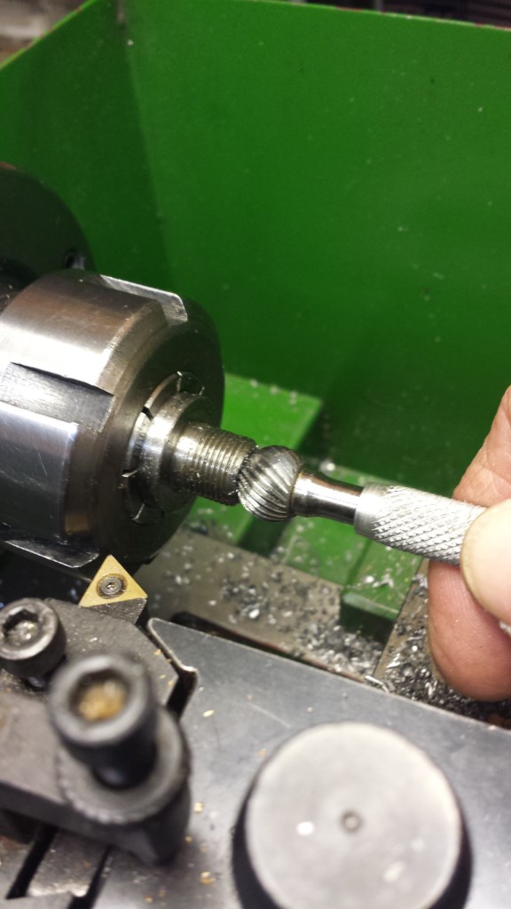

Attachment 9690

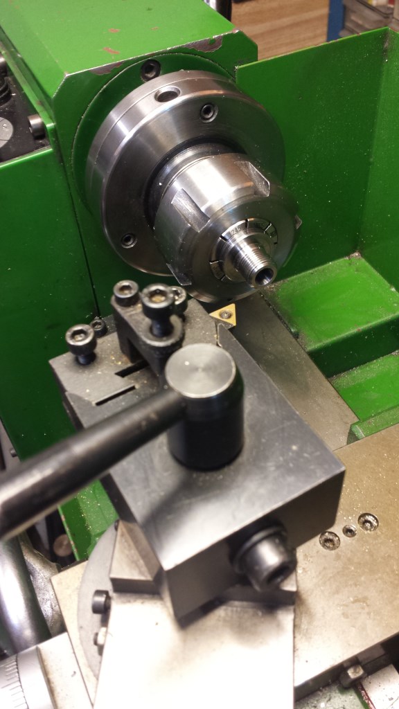

The thru hole was drilled out to a final ID of 9/32" (~0.281") to match the Unimat spindle thru hole.
Attachment 9691
The newly drill hole was deburred by hand.
Attachment 9692
The photo of the finished mandrel with a the new thru hole.
