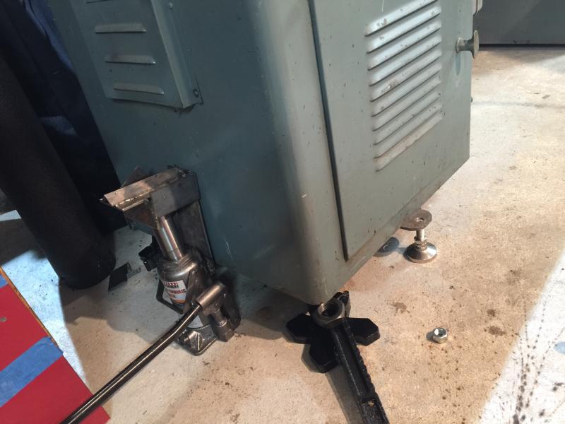

TOE JACK DOWN AND DIRTY BUT IT WORKS LIKE A CHARM FOR LIFTING A LATHE!!
Attachment 8711Attachment 8712Attachment 8713Attachment 8714Attachment 8715Attachment 8716Attachment 8717

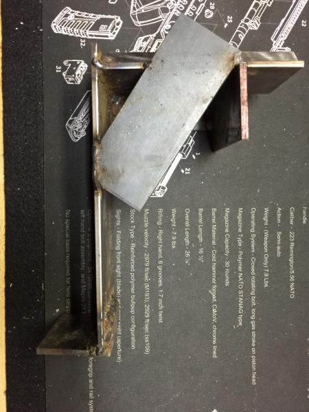

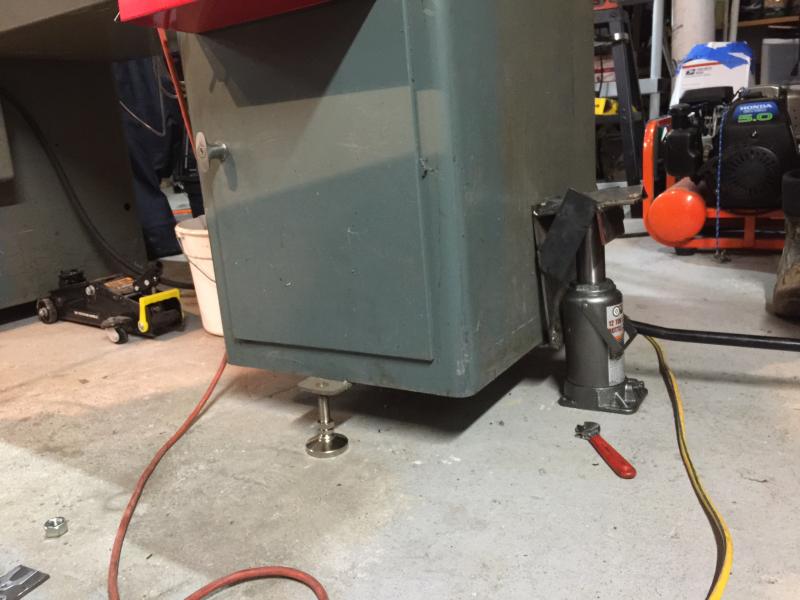

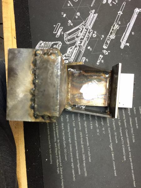

SO I ordered my leveling feet, for my logan 6565 14"x42" (2600lbs) and kinda set them off to the side for awhile to think, I was going to try and lift the machine with an engine hoist but that didnt seem like the best nor the easiest idea and it wasnt gonna be cheap since I had to buy one.. I finally came up with this idea and it actually worked FLAWLESSLY!! All I can say is if you have a lathe or mill to move this is the way to go rather its leveling feet or machine skates. Hope this helps a few others
