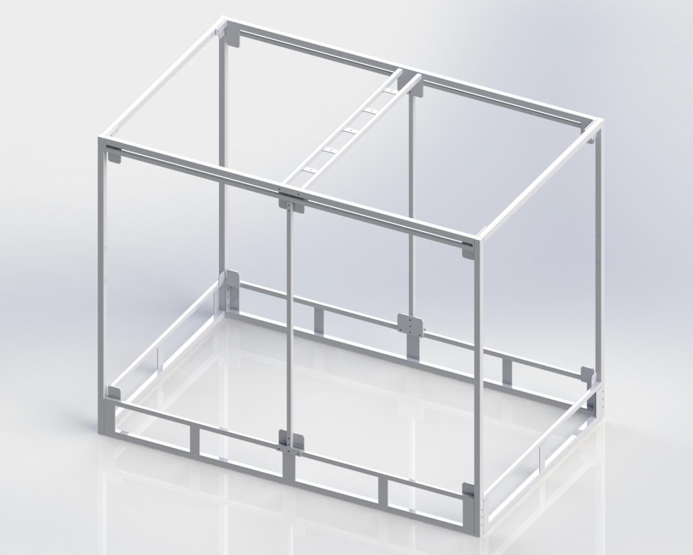

Decide to make a 'Tomato-Hot' to keep out the critters and used SolidWorks CAD software to make some concept renderings.
Attachment 1662

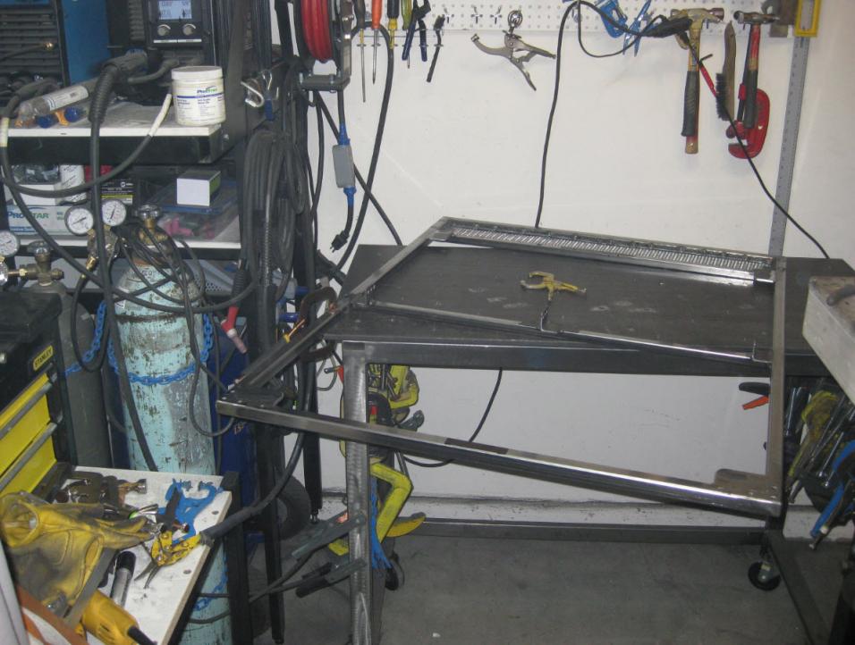

Cut & welded all the parts together in the Workshop and then bolted it together.
Attachment 1663

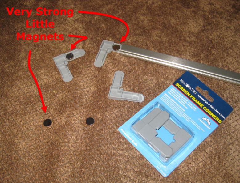

To make it easier to remove the screens and pick tomatoes, I used a Dremel tool to grind out an area in the plastic to put very strong (but small) Neodymium Magnets inside the corner connectors.
There was no need to glue the magnets, because once the corner connectors were pushed inside the Aluminum framing material, they were secure.
Attachment 1664

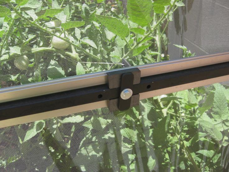

Used a piece of flat-bar steel with a center hole drilled in it, and a 1/4″ bolt, plus two ceramic magnets to create the side screen frame latches.
Attachment 1665

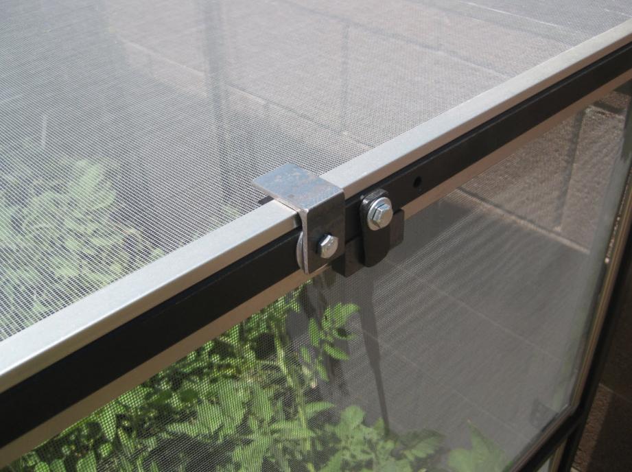

The Upper Side Latches are similar to Side Latches with a piece of angle added.
( Still need to powder-coat the Upper Angle Latch pieces )
Attachment 1666

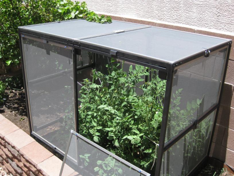

The hut has worked as intended ~ Handled a few heavy wind storms ~ No break-ins from the unruly Chipmunk & Bunny mobs ~ Harvested about 30 tomatoes so far this year.
Attachment 1668
