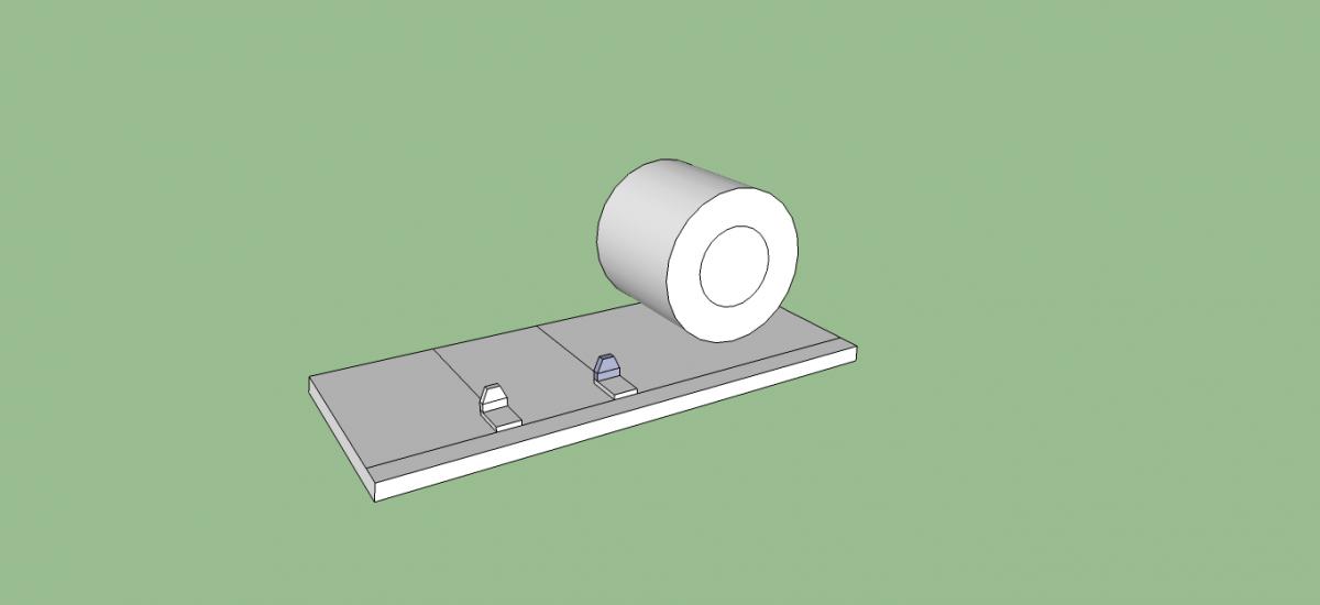

    Brilliant, like it very much, have one question, if you have done four flat profile wheels for the rubber tracks to run on. How will you stop them from slipping off when you rotate the vehicle.
    Keep the pictures coming
    Adrian
    In the rubber will be installed metal elements, so do not slipping during rotation.

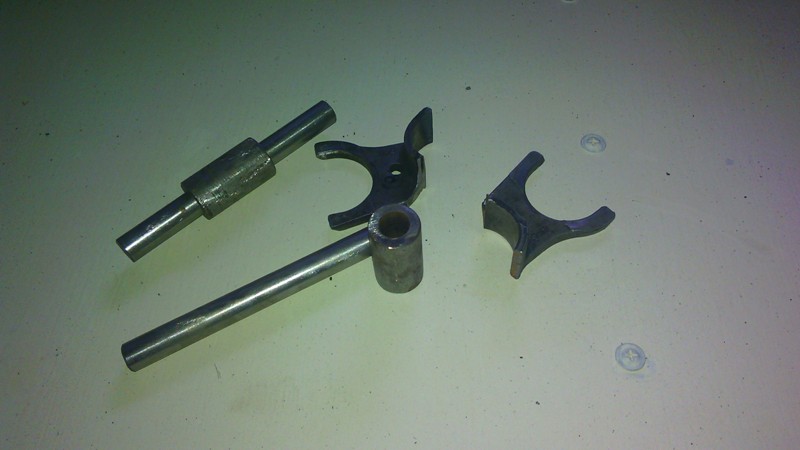

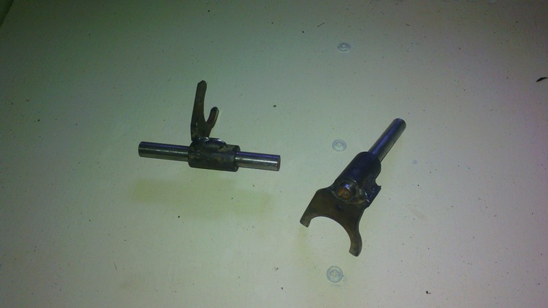

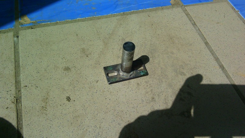

    Made Fork mechanism for shifting gears.
    Tracked mini dumper-img_20160613_102833.jpg Tracked mini dumper-img_20160613_111030.jpg
    Tomorrow I plan to make the locking enabled speed. Gearbox mini dumper will have 2 speeds.

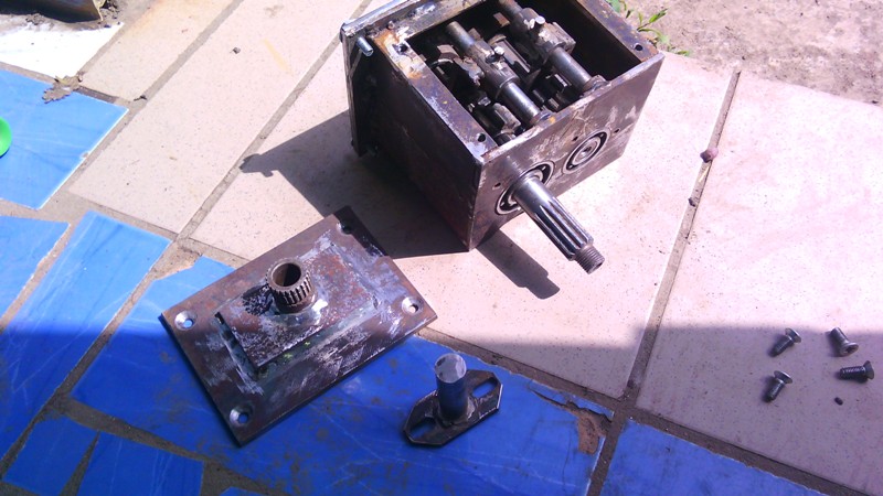

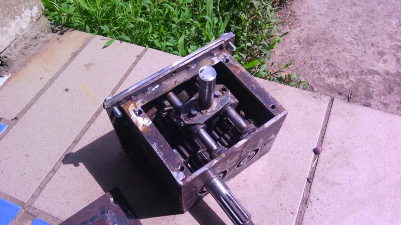

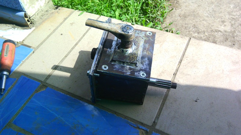

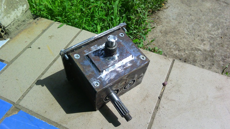

    Finished the gearbox.

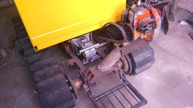

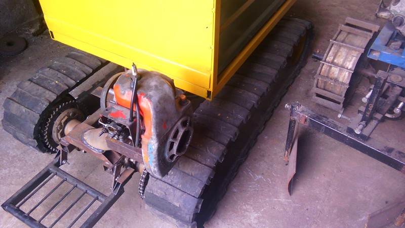

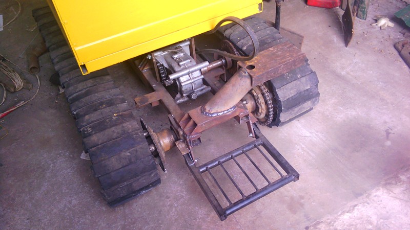

    Made attachment to the engine. Gasoline 2 stroke engine, 100 cubic centimeters, 5 horsepower. This engine 1984, I set a new piston and cylinder, and later set a petal valve and a modern carburetor. I know it's not a good solution, but I do not have another engine.
    Tracked mini dumper-img_20160728_190900.jpg Tracked mini dumper-img_20160728_191000.jpg Tracked mini dumper-img_20160728_191102.jpg

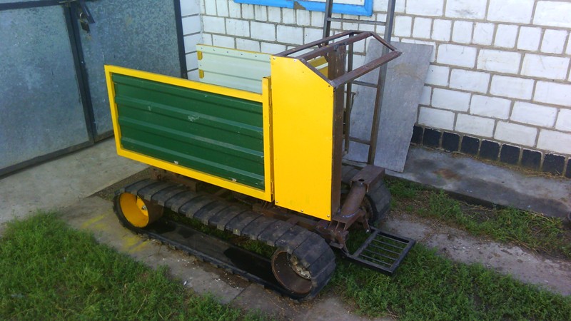

  13. #20
    Supporting Member Vyacheslav.Nevolya's Avatar
    Dec 2015
    Ukraine
    471
    118
    Thanked 1,241 Times in 338 Posts
    Vyacheslav.Nevolya's Tools

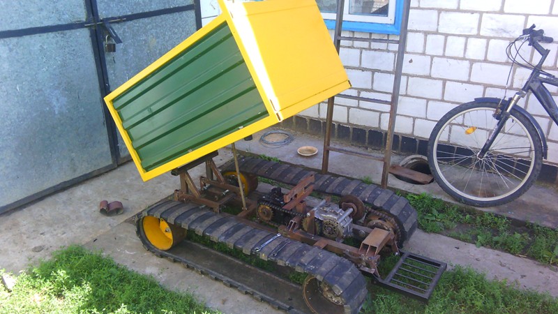

    I started doing paneling
