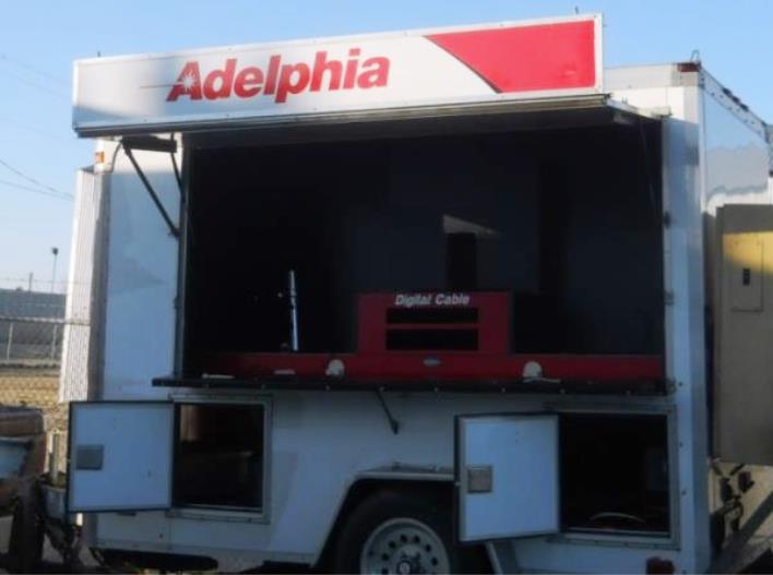

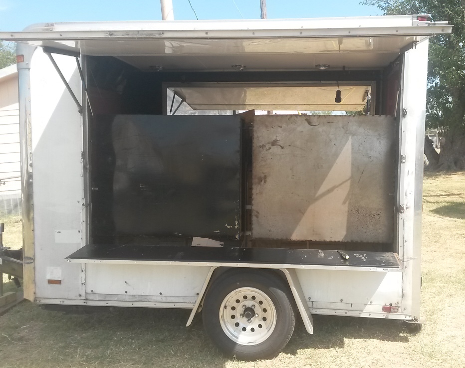

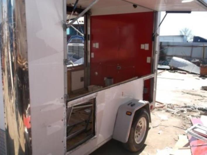

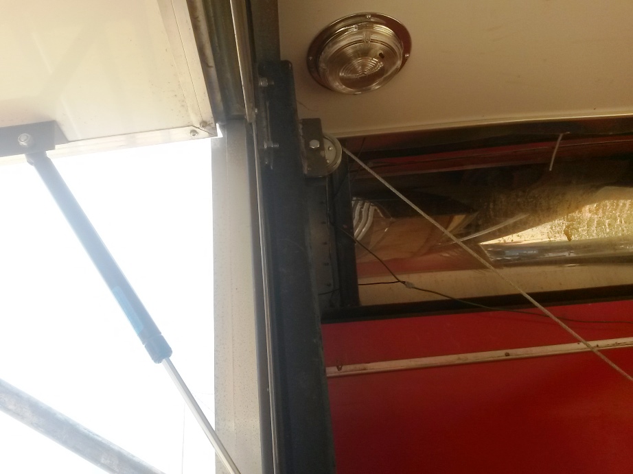

A couple years ago I converted this box trailer for a friend of mine
It started out as a digital cable display trailer
Attachment 20395

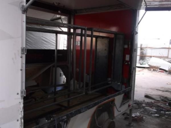

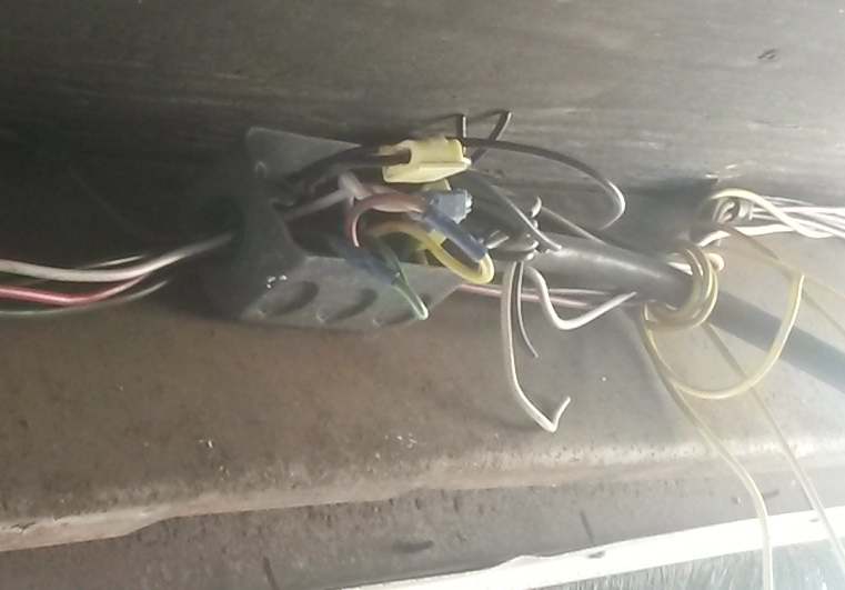

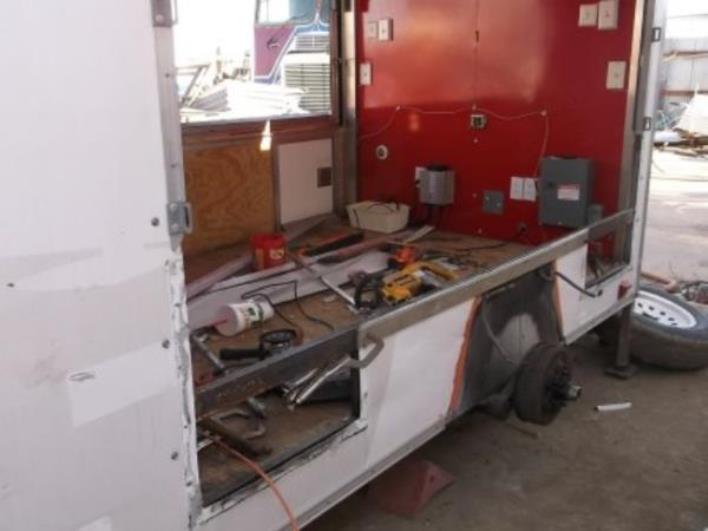

I started by removing all of the interior shelvs
Attachment 20397

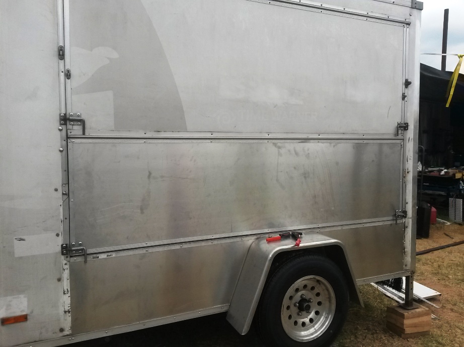

Then I cut the side down to the fender
Attachment 20396

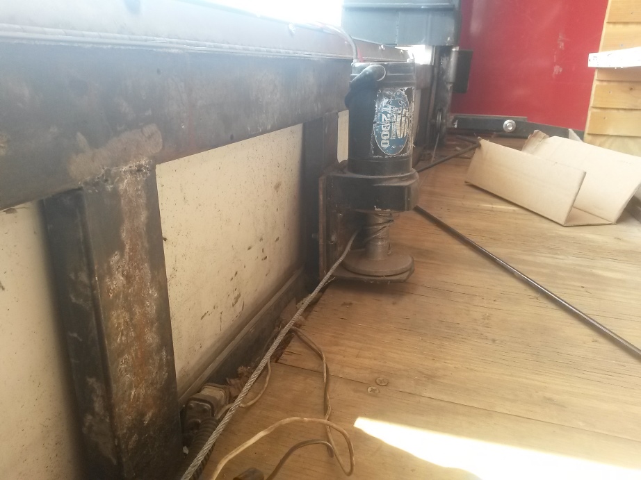

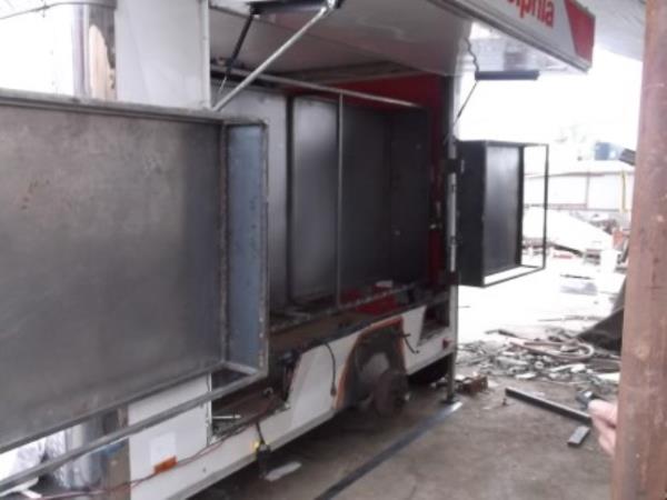

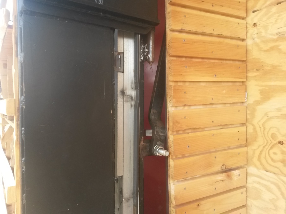

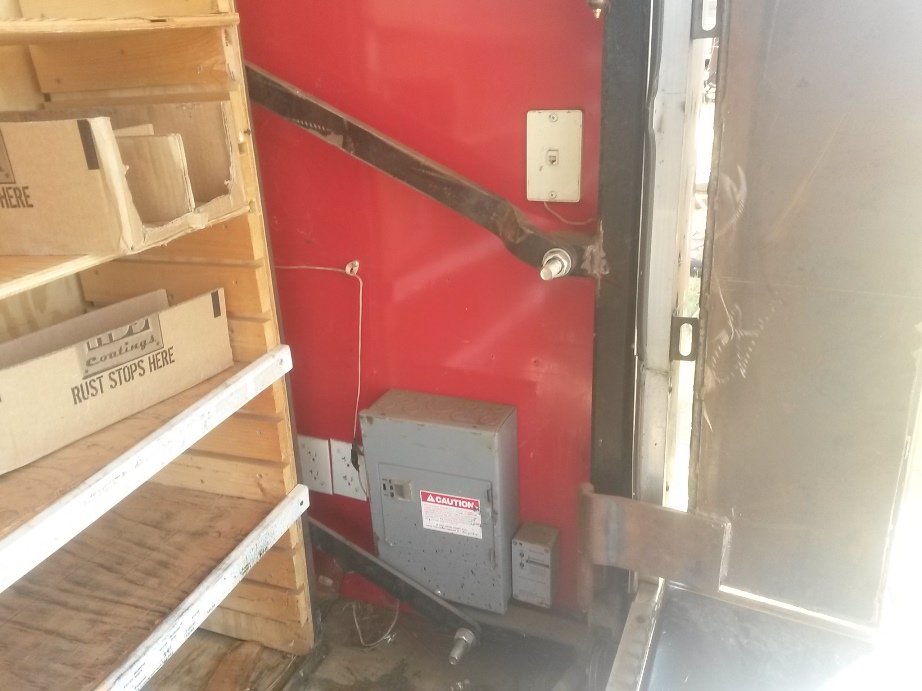

Then I made a large steel shelf unit and 2 smaller ones the large one is mounted on a 4 link system and raised with a winch this brings the shelf from its at rest position near the middle of the trailer up and out against the side the small shelves are on hinges which allows them to fold to the inside against the large shelf keeping any product from being able to fall off during movement
Attachment 20398
Attachment 20399

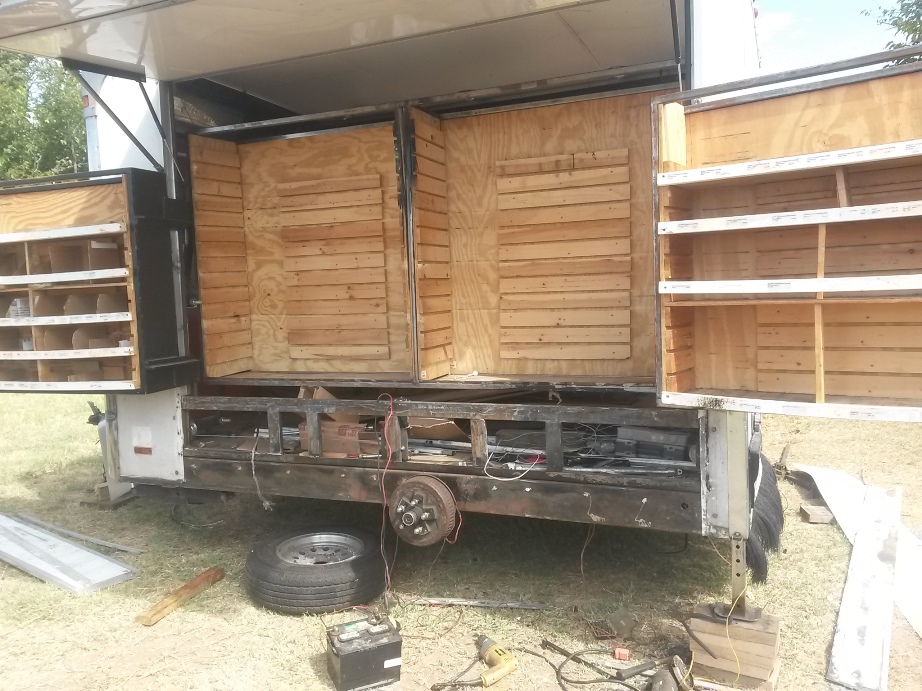

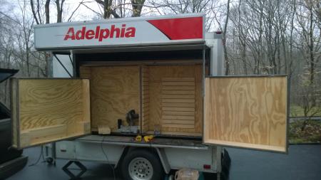

Later the frames were covered with wood
Attachment 20400

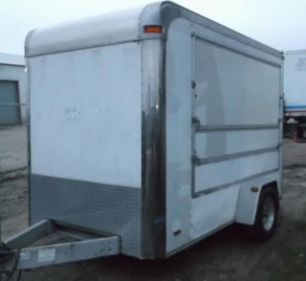

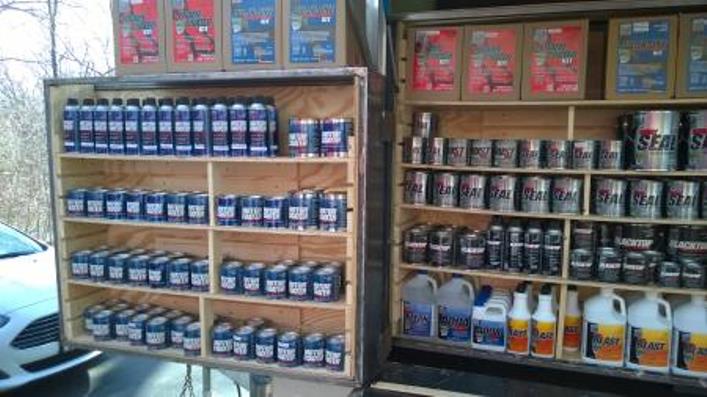

the finished trailer looks like this going down the road
Attachment 20401

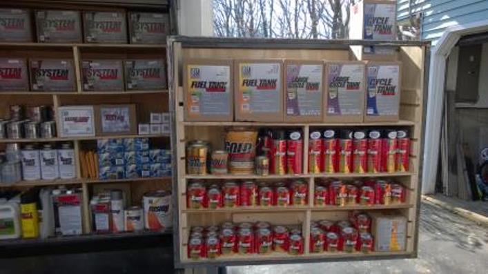

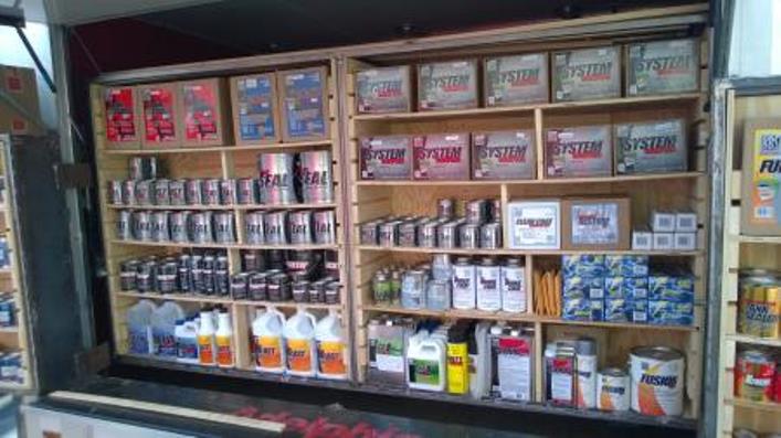

but in as little as 5 minutes it looks like this
Attachment 20402
Attachment 20403
Attachment 20404
