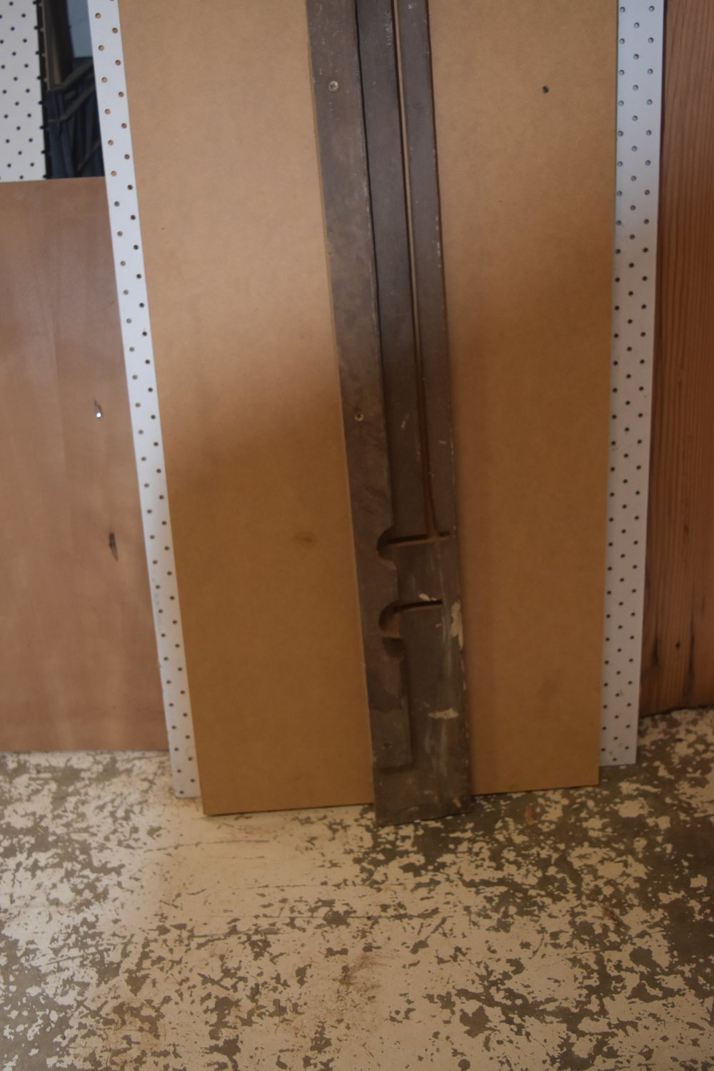

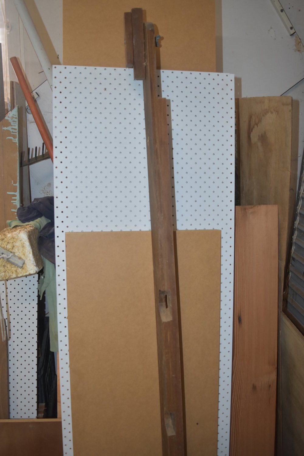

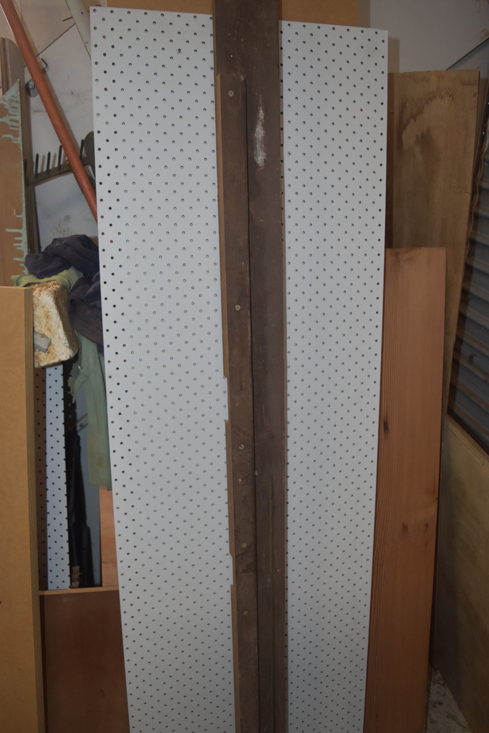

My original table was fold away ( & very heavy) & more than 4 foot square and the fence was about 6 ft (i.8 m) long. I donated the the table to a mens shed but I think I may still have a Pic of the fence. I may be able to locate & somehow upload here for you to have a squiz, but have never done an upload here=bit of a beginner in the new IT. Do it all the time for gumtree ads.

Attachment 23926Attachment 23927Attachment 23928 Hope these work as I couldn't find preview or multiple attachments.

they could be clearer however two router bit holes exist & both are a little over size for my largest panel bits ( about 3 in or 76mm)at that time.the closest hole to the T attachment was for routing at 90 deg to the T slot (beading, edgeing etc). The other one has a slot beside it running down the fence to allow multiple adjustments for jobs loke daddos/grooves in full or large sheets. A bolt ran through the table & that slot to allow the adjustments and contained the fence with a wing nut and mudguard washer. I used inspiration from a combination of models from Tay (spelled Tage) Frid and another by Wallace Kunkell (I think that was his name) and developed my bench for my needs at the time.
