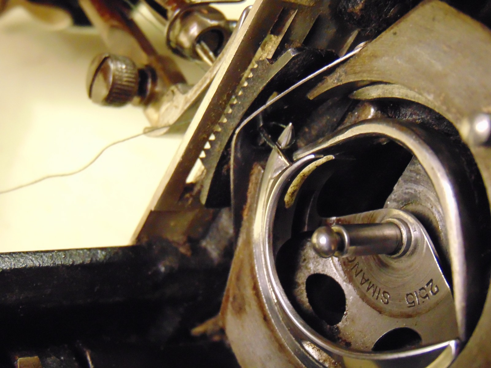

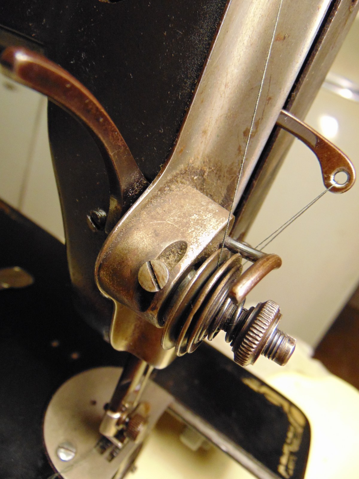

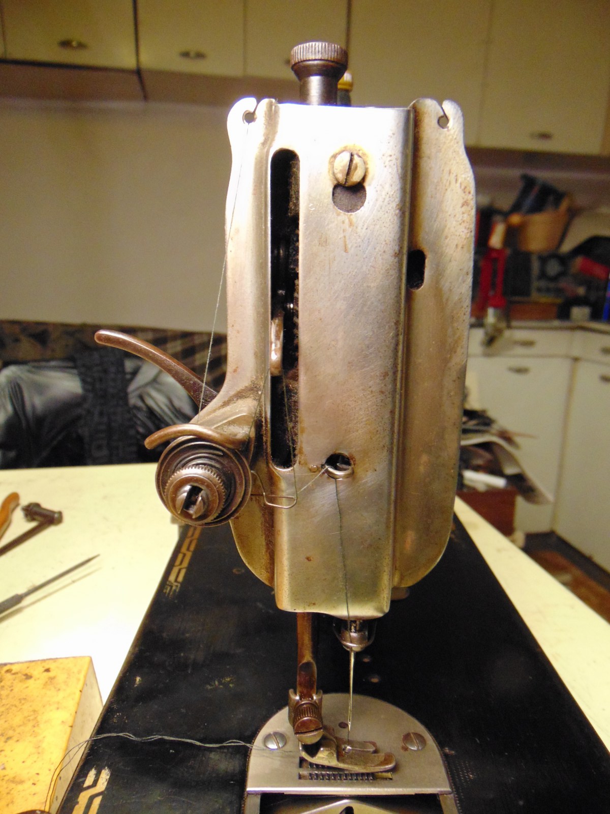

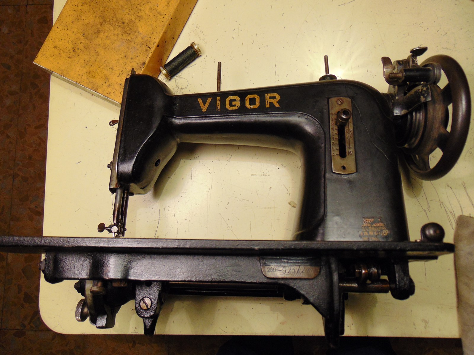

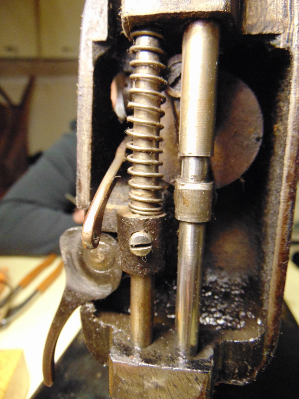

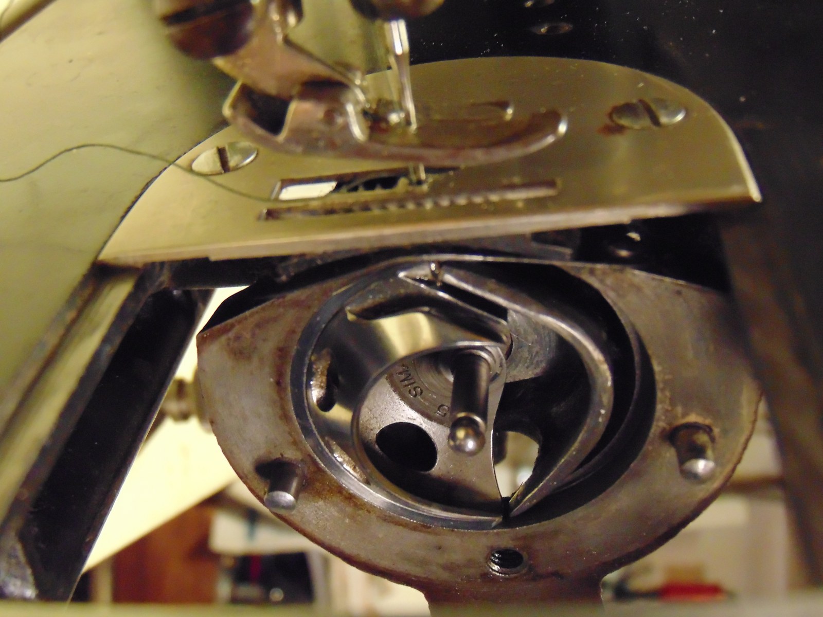

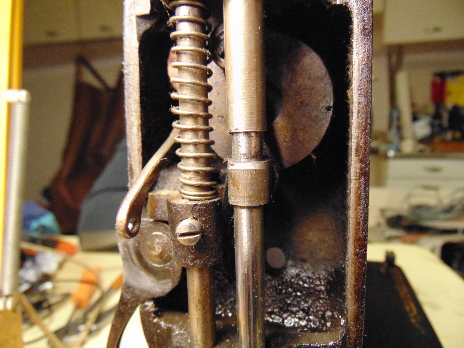

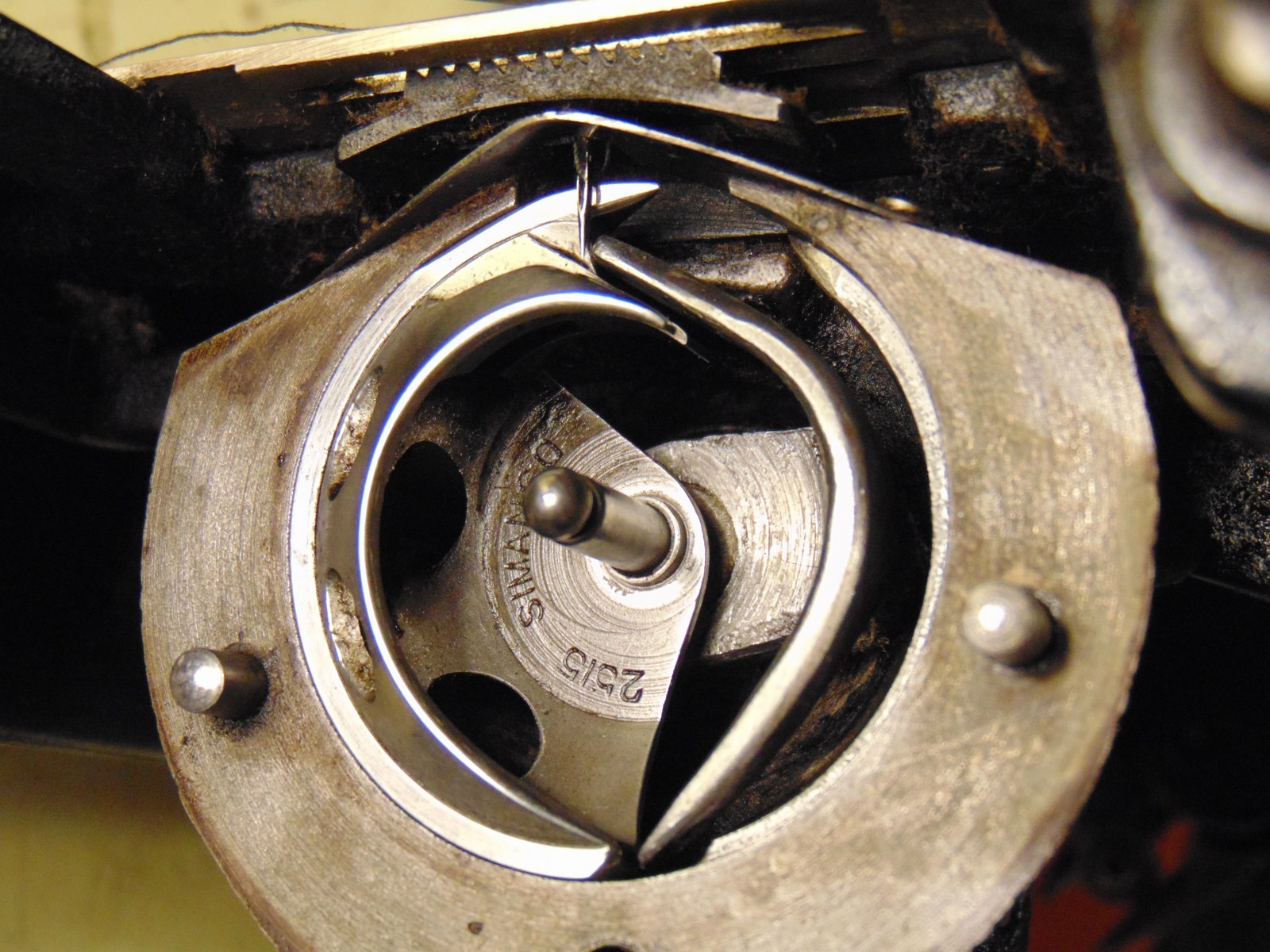

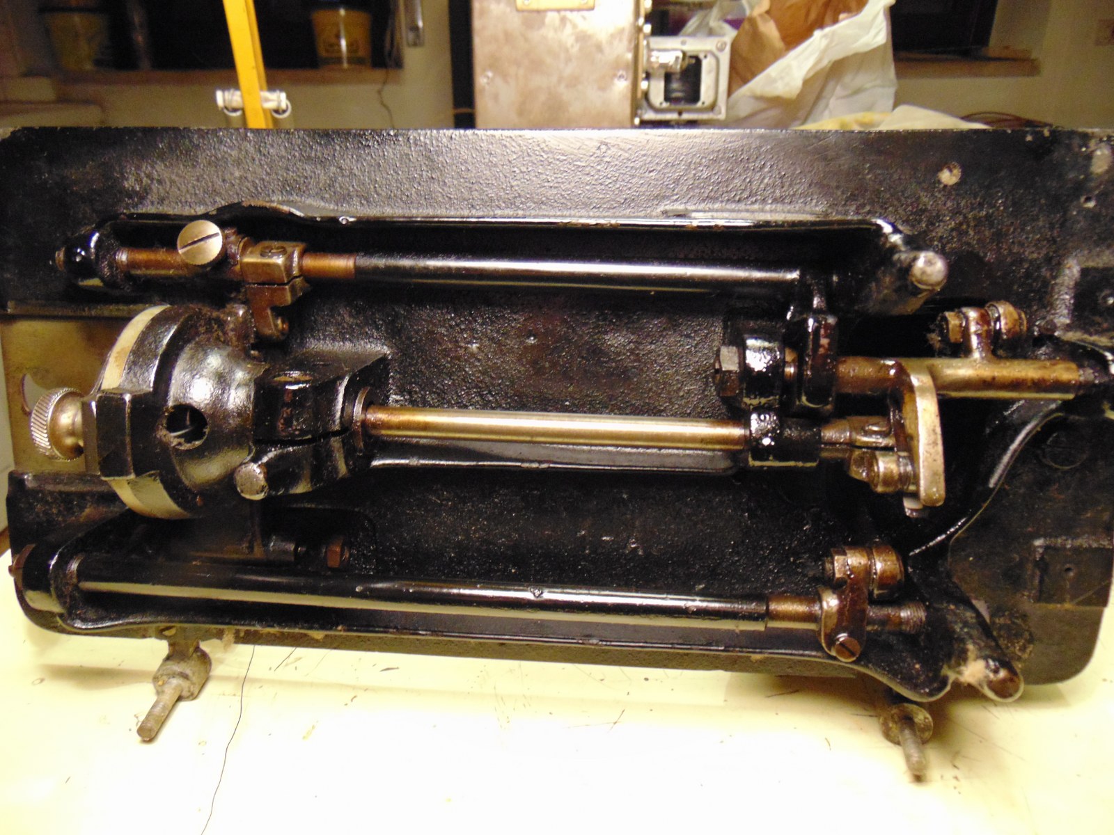

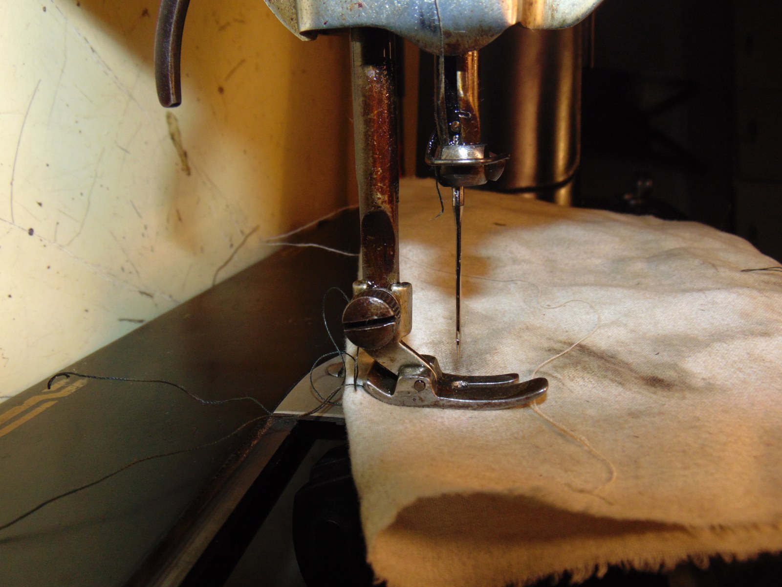

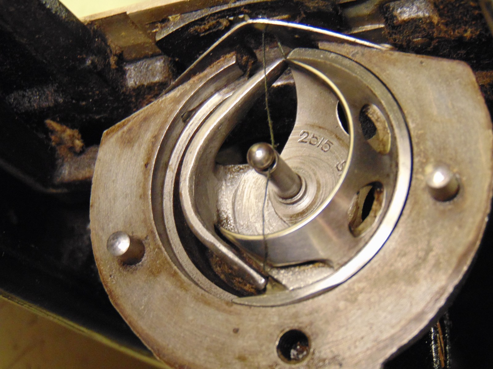

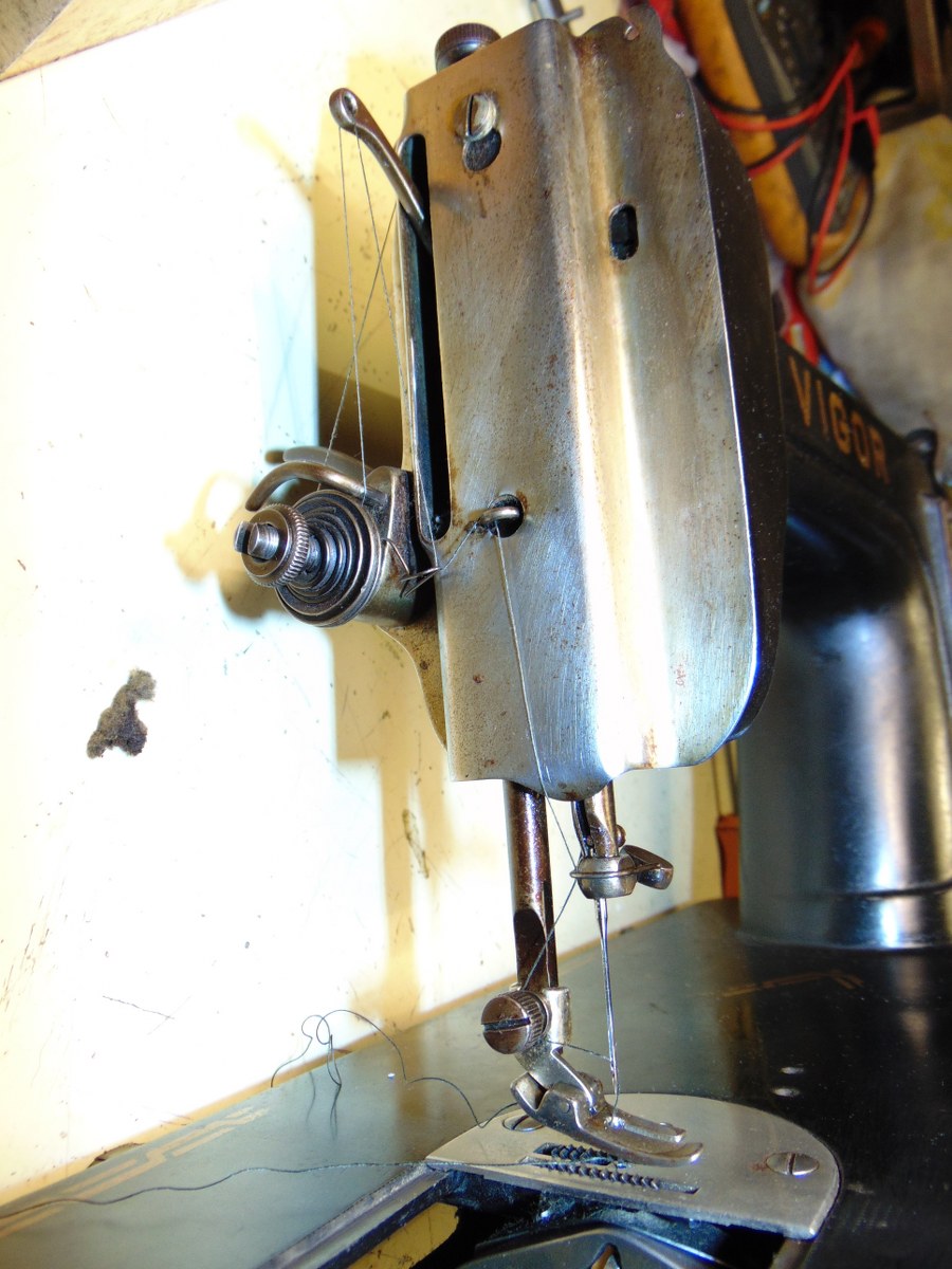

    I have an old Vigor sewing machine (maybe from 1920), in good external condition.
    I cleaned and oiled the links, the action is smooth but the machine is still not working.
    I'm not so sure about the path of wire, nor if the shuttle is ok
    When I try to advance the wire doesn't make a turn around the shuttle and makes a tangle, causing wire breakage. Maybe it's a timing trouble, or worn parts
    Have some advice? I'm a noob of sewing machines, but I want to learn how to use
    Saluti
    Stefano
    Trouble with old sewing machine-dsc02022_1600x1200.jpg Trouble with old sewing machine-dsc02023_1600x1200.jpg
    Trouble with old sewing machine-dsc02025_900x1200.jpg Trouble with old sewing machine-dsc02026_1600x1200.jpg
    Trouble with old sewing machine-dsc02028_1600x1200.jpg Trouble with old sewing machine-dsc02030_1600x1200.jpg
    Trouble with old sewing machine-dsc02032_1600x1200.jpg Trouble with old sewing machine-dsc02033_1600x1200.jpg
    Trouble with old sewing machine-dsc02034_1600x1200.jpg Trouble with old sewing machine-dsc02035_1600x1200.jpg

    Hello Stefano
    I think I can help you with the sewing machine. I used to work with a carpet binding machine which looked very similar to this one.

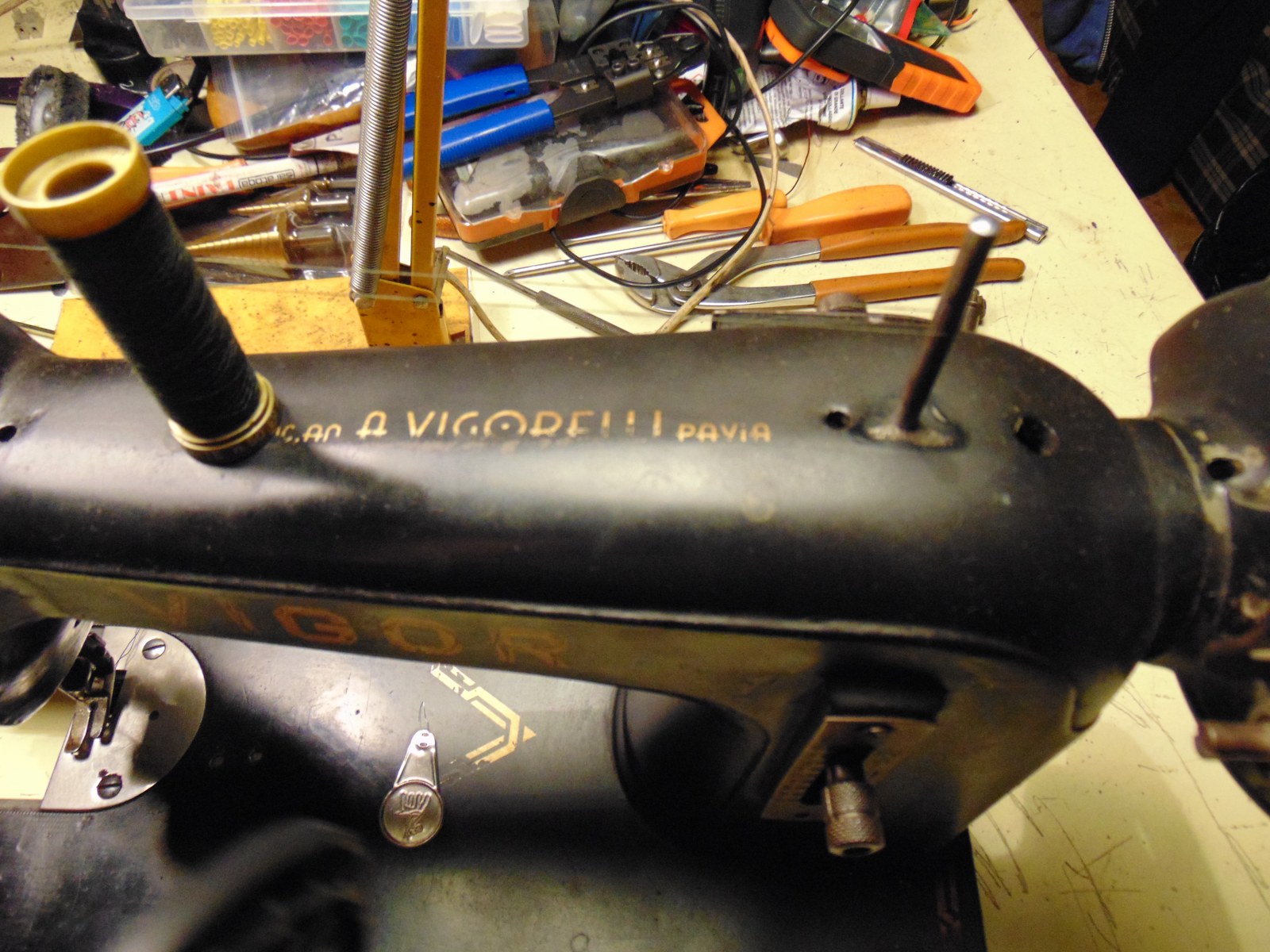

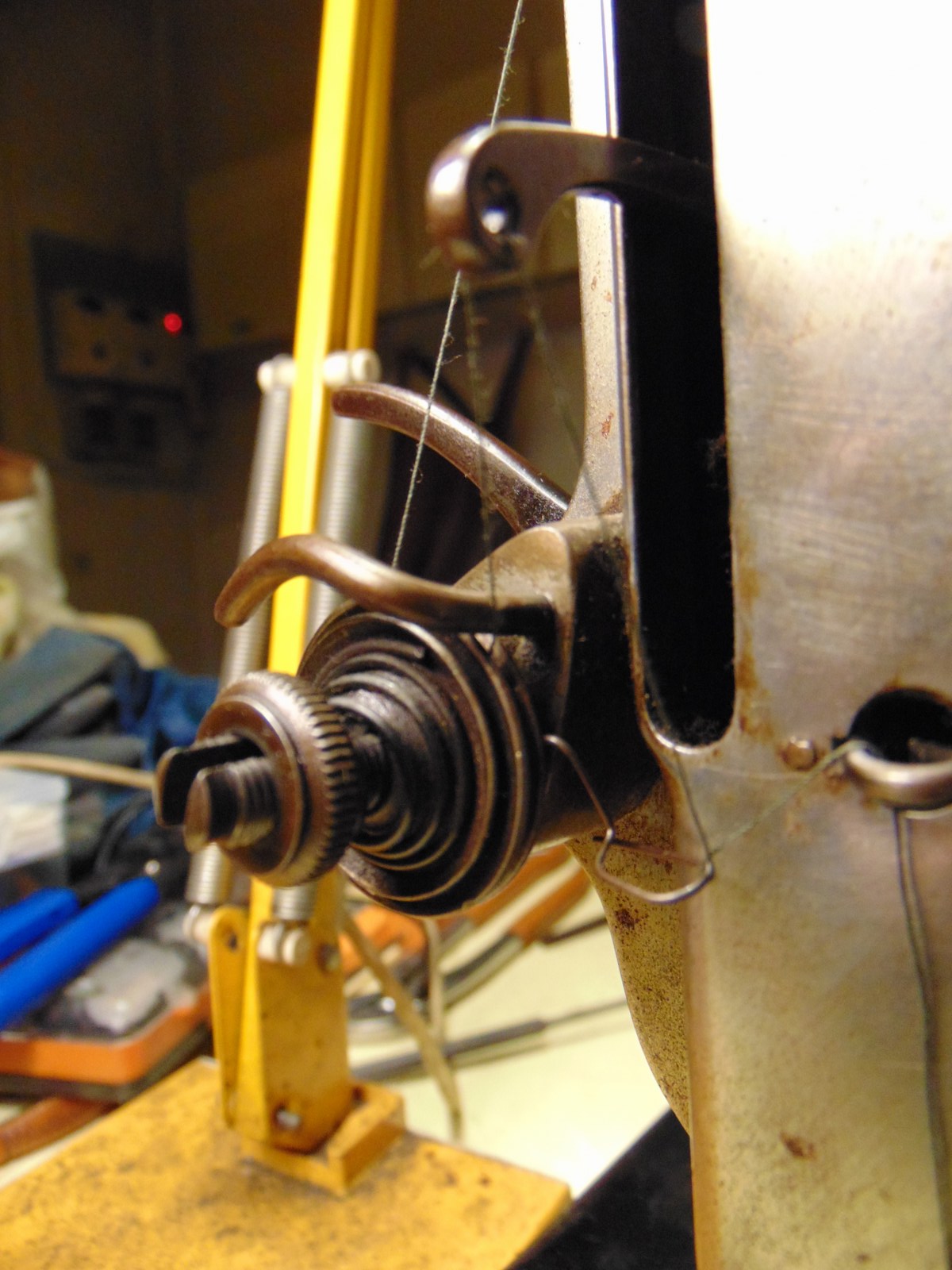

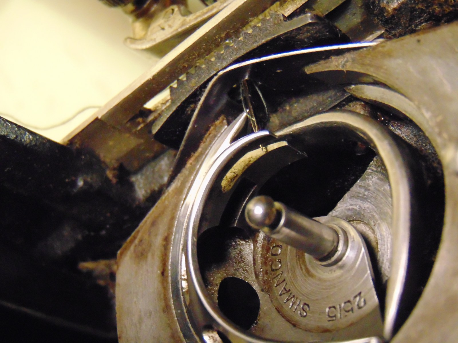

    First the threading is not correct. Go from the spool on top of the machine to the guide on top rear at the left end as in picture #1. From there down between the tension disks from the back and up inside the curved guide Then go through the thin spring. Next go through the tension lever that goes up and down (from the back to the front), then down through the guide loop on the end plate.The thread then goes down through the guide on the top of the needle and straight down to the needle passing through it from left to right.

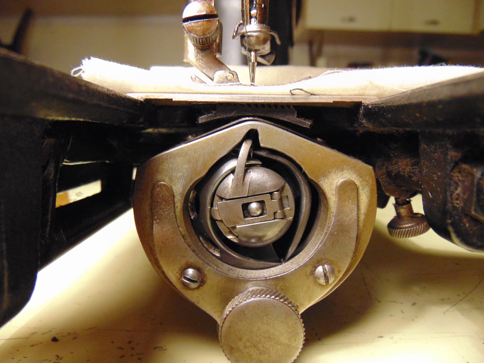

    When the needle goes down through the material it must go low enough so that the eye of the needle goes below the the point of the shuttle (shuttle hook). Looking at picture # 7 and assuming that the needle is still coming down and that the shuttle hook is still moving to the left then all is good. The shuttle has to rotate further to the left and the needle must come down more. (The space between the needle and the hook in this picture should be about the thickness of a strip of paper … almost touching)
    .Picture #8 shows the needle and shuttle in the correct positions assuming that the needle is starting up and the shuttle is starting to rotate to the front. The material you are sewing holds the thread as the needle starts to go up. This makes the loop of thread beside the needlet that the shuttle hook has to catch as it comes forward.
    Picture #10 shows this correctly.
    The shuttle must now rotate to the left until the loop in at the bottom as in picture # 11. This is when the tension lever above quickly jerks the thread up the rest of the way around the bobbin holder and up through the space in the shuttle race and then up tight against the back in the material. If the timing is not correct (needle does not go far enough down or the shuttle hook does not go far enough back) then you will not get a stitch.

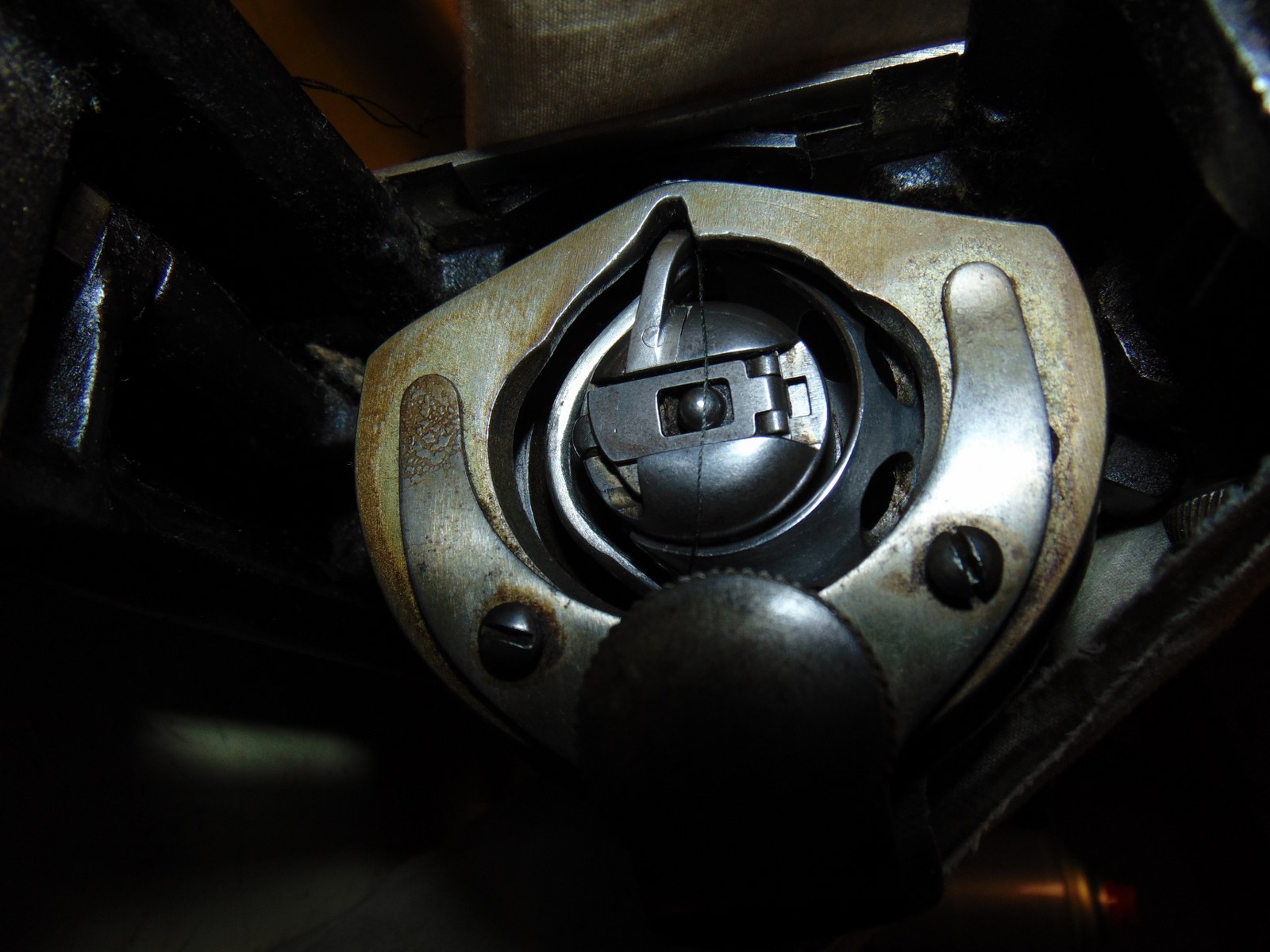

    I tried a couple of video, uploaded on youtube

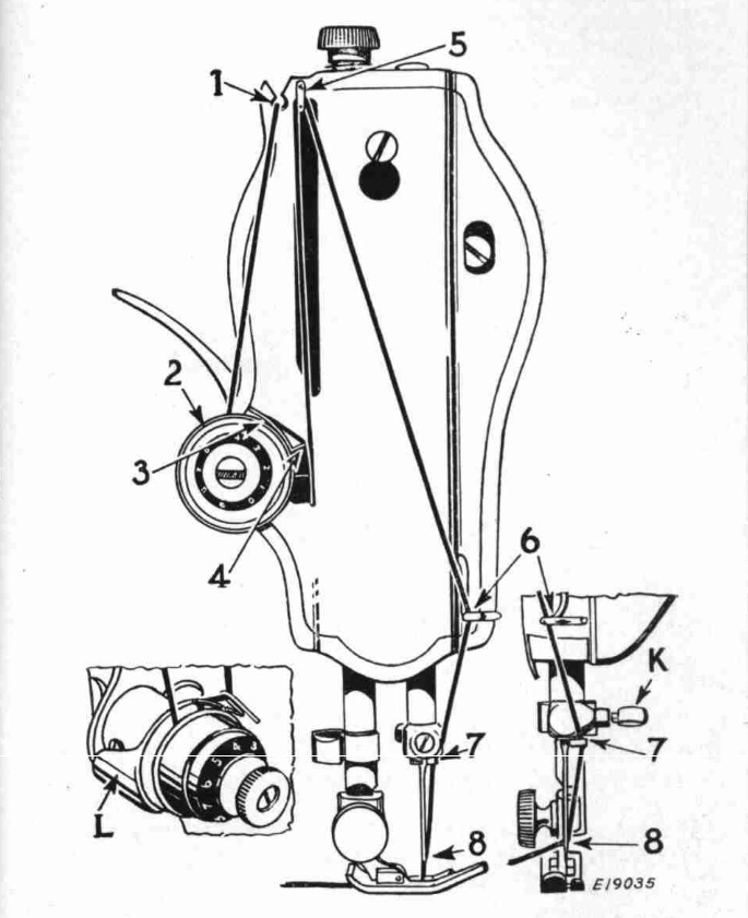

    In the Singer manual of 19-91 model (it seems close to my machine) I found a schematic for wire and I tried to replicate with your advice.

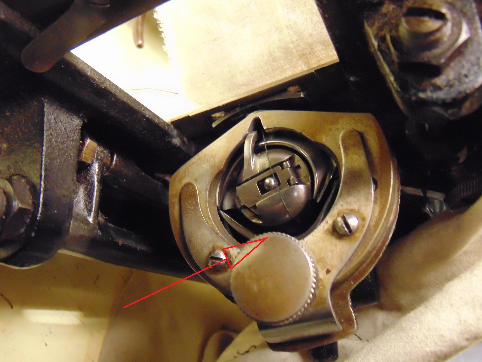

    I don't know if it's normal, but the bobbin case and close parts have some movement.
    Singer schematic

    I think you are pretty close on the threading. In picture #5 stay behind the curved rod guide when you go between the tension disks the over it and then simply under the small spring (not around it). This is before you go through the tension lever that goes up & down. The small spring is there to keep the thread behind the curved rod when the tension lever goes downward.
    The movement in the bobbin area is normal & OK…. There has to be enough room for the thread to pass around the bobbin case and up through the space between the shuttle driver race and the tail of the shuttle.
    Do you have a loaded bobbin in the bobbin case? The bobbin looks like two small disks with a tube between them. It is wound with thread in the apparatus up near the hand wheel. The bobbin is small enough to sit inside the bobbin case, and the thread on the bobbin is passed under a flat spring on the flat side of the bobbin case. When you load the bobbin case in the machine, pull about 2 inches of thread out and let it hand loose on the right side of that little finger on the bobbin case.
    In the pictures from your first post, #7 and #8 show the shuttle hook rotating to the left (back of the machine) and then coming toward the front and catching the thread loop. This is correct. If you put the machine in this position again, hold the end of the thread to the right of the needle, and watch as you turn the hand wheel. The shuttle hook will catch the loop pulling it to the right or forward, go half a turn and it should slip off the end on the hook. At this instant, the tension lever jerks the thread up and it will catch on the mounting shaft of the bobbin case. Normally it would slip over the bobbin case thereby completing one stitch ( a single loop around the bobbin thread).
    Before you start sewing, and before you put material under the needle, hold the end of the thread to the right of the needle and turn the hand wheel around once. This will pass the thread around the bobbin once. When you then slide something thin under the foot, it will lift the bobbin thread up to the top side. Now hold both threads, put the material under the presser foot and let it down. The machine should now sew!
