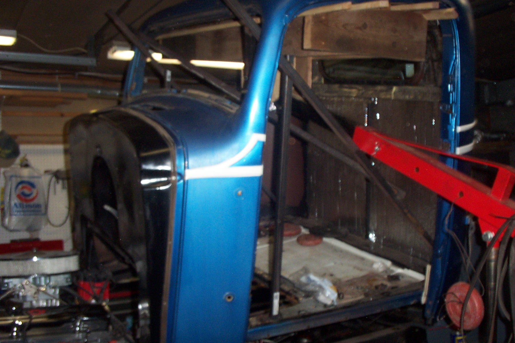

I think I saw this posted on this site so I made one for myself. It works great if anyone is looking for a way to lift off their cab. This site has some simple solutions that save time.
Attachment 7911

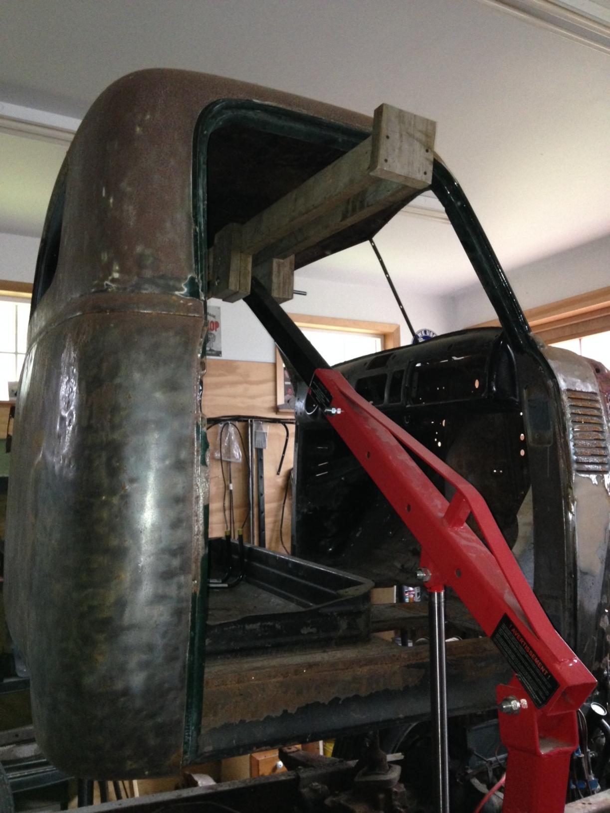

You did I posted one a couple of years ago. Yours is a little different than mine ,but it looks like it will do the job.

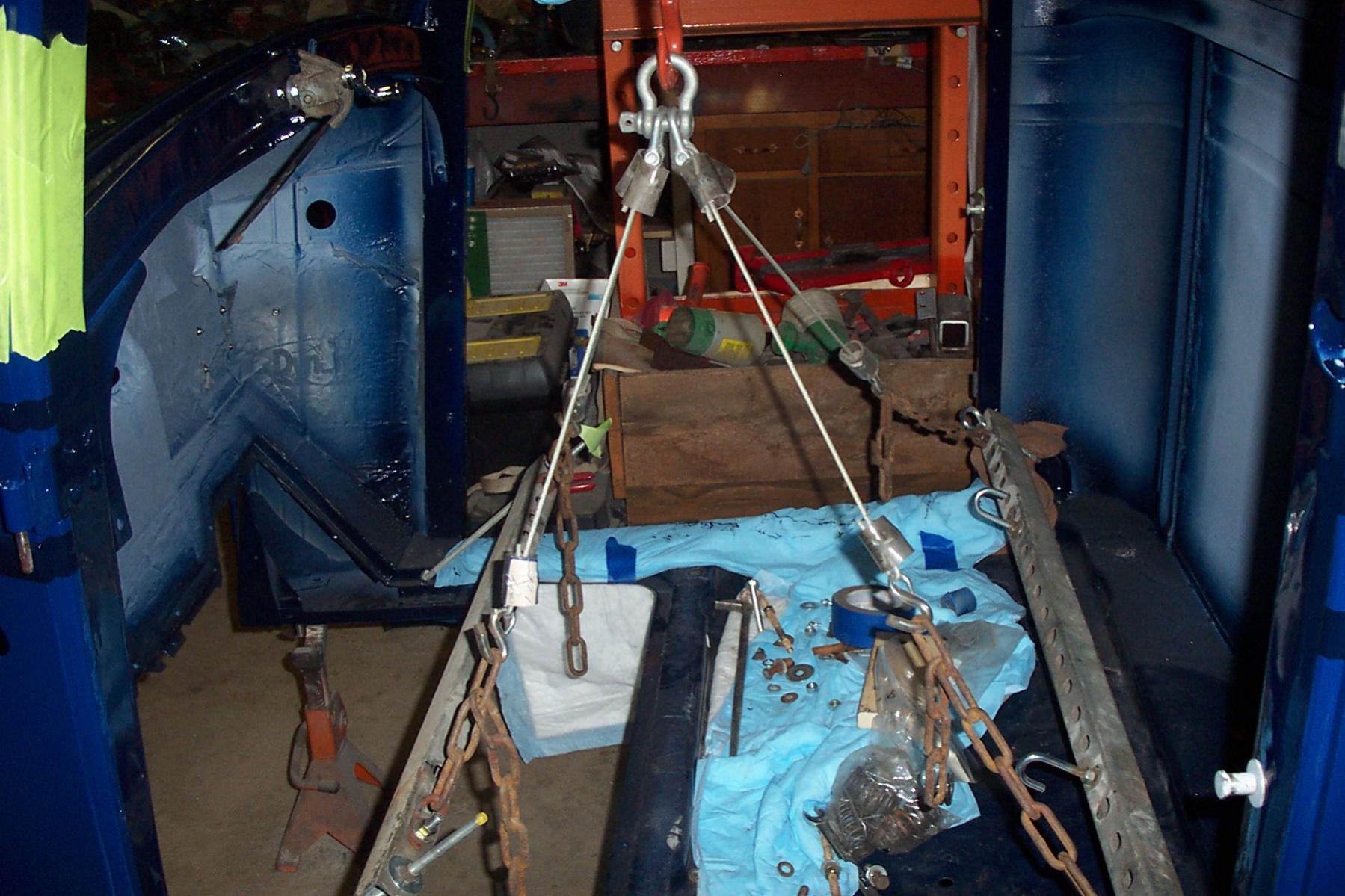

After my cab was painted I was afraid of scratching the paint so I picked it up with a engine sling fastened to the floor.
Check out my build on Hotrodders.com chief36chevy’s photo journal.
Attachment 7963Attachment 7964
