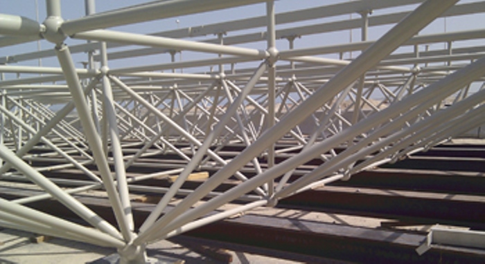

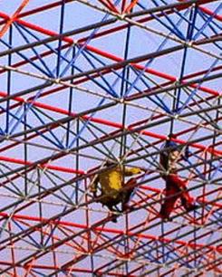

    A light weight and one of the strongest roof systems there is would be a space frame structure. The company I was with before retiring build among other things lots of steel structured buildings some of our space frame designs clear spanned 200 ft by 300 ft on 3 sides made up of a labyrinth of small pipes all bolted together no single connection carrying more than another once complete

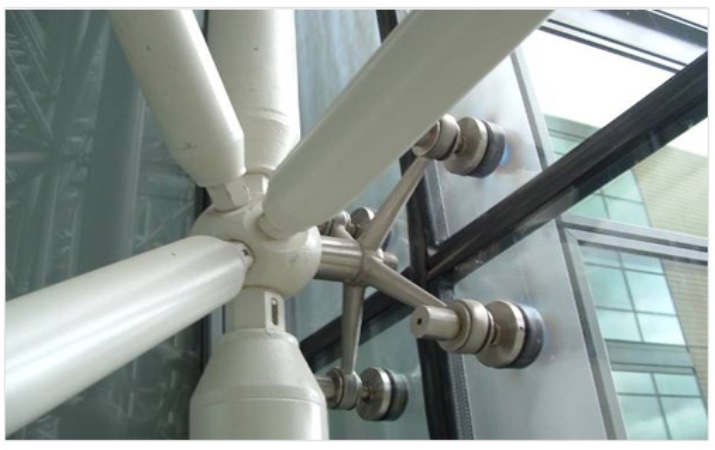

    and to secure glass panels we used stainless steel spiders
    the pic also shows how the system connected together

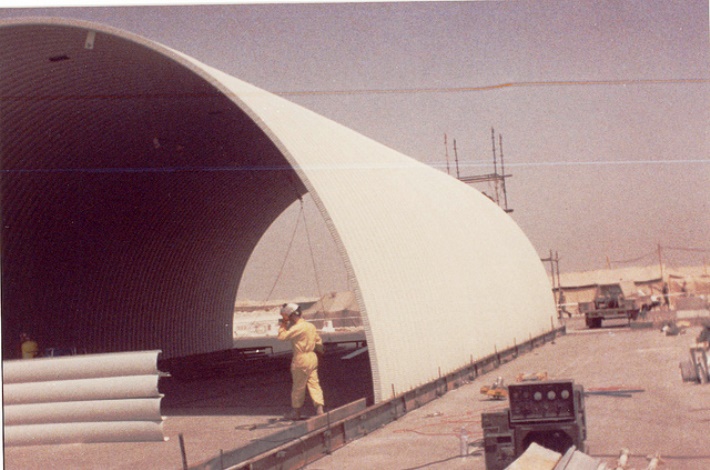

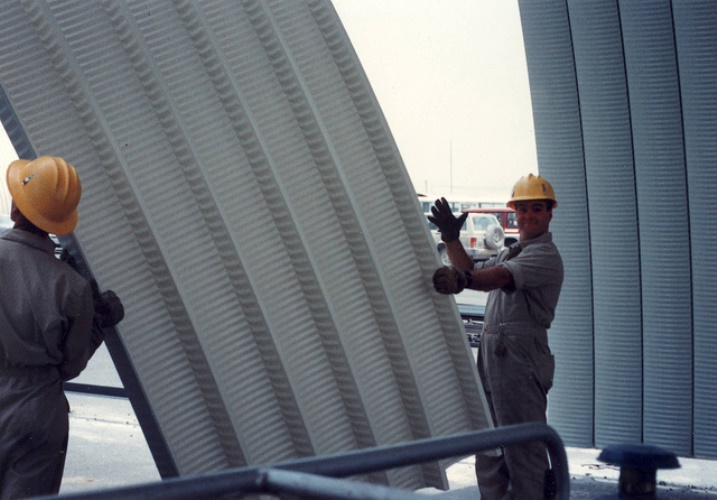

    And for the lightest fastest structure to erect the award has to go to K span.
    anything under 30 ft wide by 18 ft tall only needs a 3/8" thick by 6 inch wide curved steel rib placed between every 10 feet of roof panels 60 ft by 30 to 35 ft tall buildings needed 3/4" thick by 10 inches added every 30 ft along with the smaller ones. the panels were made on site in a mobile form rolling machine from coils

    The last shot looks a larger version of a Quonset Hut. Quick and easy construction made it popular and necessary during WW2. The name comes from their place of manufacture, Quonset Point, RI.
    Yes actually just the newer version except instead of taking corrugated sheets and curving them or using High edge rib standing seam heavy galvanized metal the K span is made from stupidly thin gauge metal that comes in 24 ft wide coils a 1000's of ft in length rolled to shape and curved in the same machine right on location
