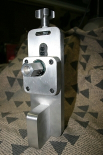

    My latest tool project is a bead roller for forming a bead on the end of a tube. I need to use this tool to make new engine coolant tubes for my racecar. It could also be used to make intake tubing for turbo applications.
    I saw the design concept on the net, and made my own version.

    Hi Altair, the dies are not connected in any way, the process relies on friction on the inside of the tube to turn the tube. I have not yet experienced any negative issue with this arrangement but if I do I may bead blast the internal die for more grip.

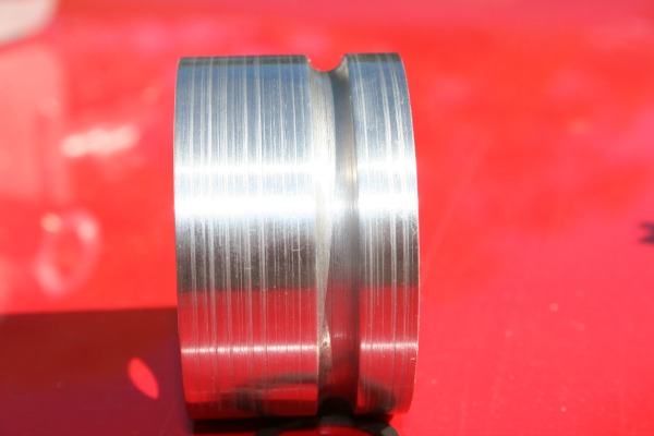

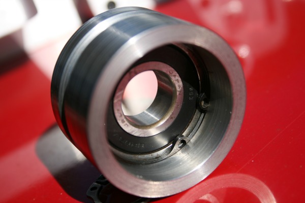

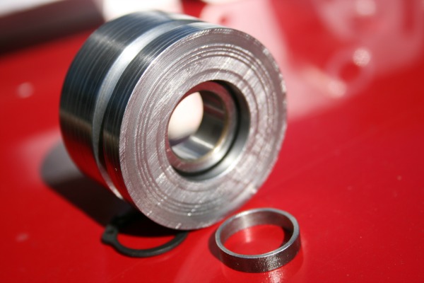

    Hi Nitrous, thanks for checking out my tube beader. You are correct in that the only driven element is the bottom die.
    I have taken some pictures of the upper die and other detail.
    Tube Bead Roller-tube-beading-die1.jpg this is the backside of the die with spacer ring
    Tube Bead Roller-tube-beading-die-2.jpg this is the front side of the die, 6203 bearing
    Tube Bead Roller-tube-beading-die-3.jpg profile of the die

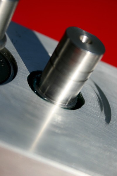

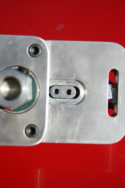

    Tube Bead Roller-tube-beader-top-die-axle-detail1.jpg rear of die axle detail
    Tube Bead Roller-tube-beader-top-die-axle-detail2.jpg front of die axle detail only the outer circlip groove is used, the inner one was a mistake.
