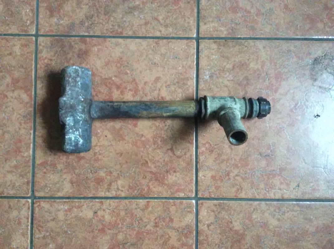

Tuyeres
Attachment 26870
I have used this type of tuyere for several years, although it’s not usually going for more than a couple of hours, and the fuel is charcoal. It is a bottom blast, supported on bars below a layer of ordinary Victorian house bricks. So long as the air flow is continuous, it does not block up. The stop end can simply be unscrewed if ash accumulates, but I don’t usually need to do this while forging. I have also used coke. Charcoal produces very little slag. The benefit of an old sledge hammer head is that slag does not stick to it, even using coke.

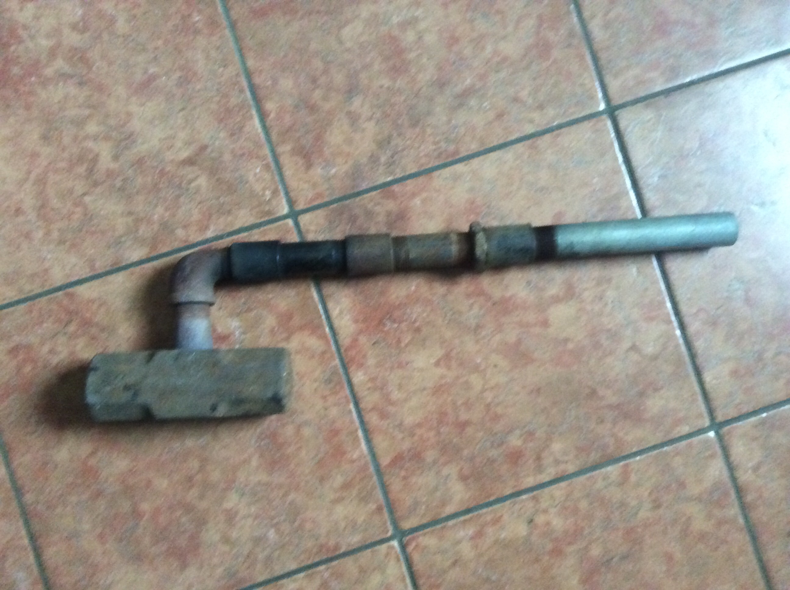

Attachment 26871
Now I want to experiment using a side blast, which is why this tuyere has no stop end.
A note of caution. To fit the pipe to the hammer eye, I had to heat it. It is better not to use galvanised pipe, because of zinc fumes-which can kill! The tubes are not galvanised, although they appear to be, in these pictures.
It is a tube into a forge or furnace through which air passes, which makes the fire burn hotter. The air is forced, using bellows, or an air pump.
