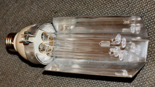

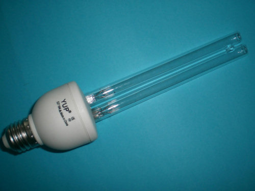

I found a CFL germicidal UV-C lamp at a surplus place. It is a CFL15UV/MED and it appears that these lamps or bulbs are readily available. They have self-contained electronic ballasts so they need only be screwed into a standard E-27 117-volt household light bulb socket to operate.
Attachment 14126
They produce germicidal UV-C radiation at 254 nanometer wavelength. The UV output of this 15-watt bulb is about 3.6 watts. If this output is directed into an area of 8” x 10” (about 500 cm2) with 60% efficiency, the resulting irradiance is 7200 microwatts per cm2. A 15-second exposure would be a dose of 108,000 microwatt-seconds per cm2, easily enough to kill mold spores.

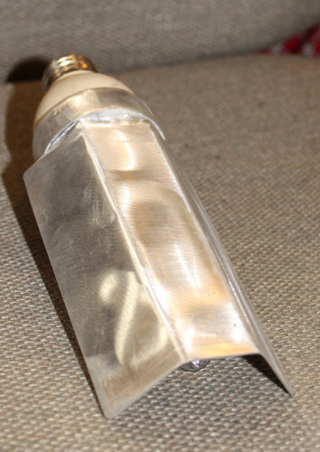

To accomplish this, and to protect my eyes and skin from the UV radiation, I needed to make a reflector and housing. I made it of polished aluminum. It fastens directly to the lamp itself. The socket with power cord then screws onto the lamp.
This is an aluminum-brazed assembly. The material is 18-gage (.040”) aluminum. I used an oxyacetylene torch to do the brazing.
