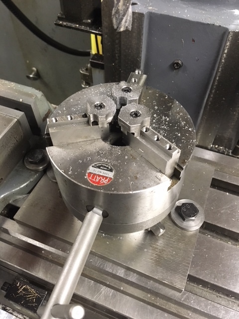

    Hi All
    This is a really easy way to cut an eccentric shaft with little effort. No difficult clocking of a 4-jaw to get the correct throw. But you do need a 3-jaw that can be fitted with soft jaws.
    This is the method I use:

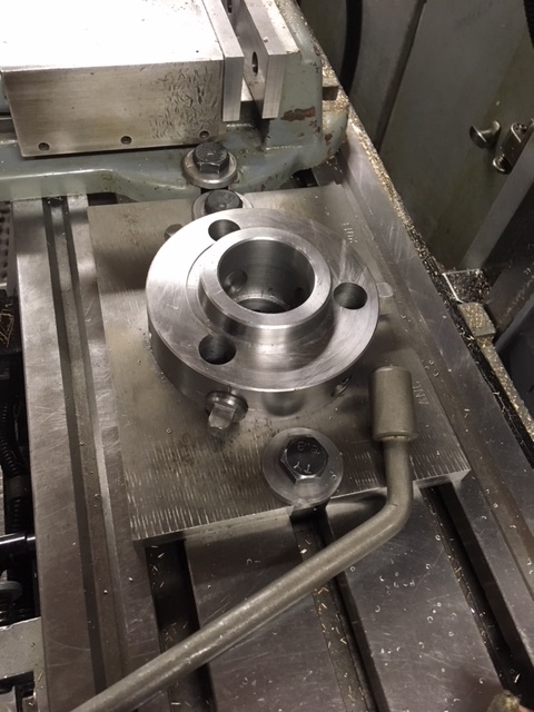

    D1-4 Milling auxiliary plate used to locate the 3-jaw while machining the soft jaws. This is clocked to get the spindle concentric to the plate. Once concentric the table is moved to the desired off-set. (You do not need the auxiliary plate just clamp your chuck to the mill table and clock)

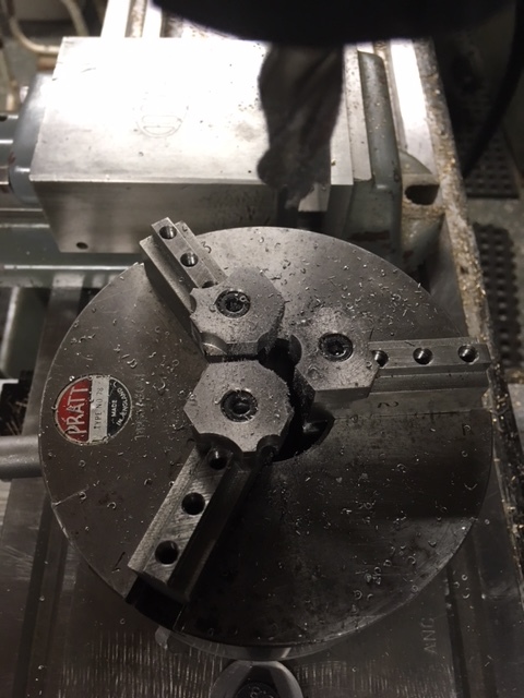

    Using an end mill, the same size as the shaft diameter to be held is used to cut the jaws. The jaws are moved in using the chuck key and the end-mill is simply raised and lowered using the quill like a drill to cut the jaws. The jaws are moved in a small amount using the chuck scroll after each cut until there is enough of a diameter cut in to the soft jaws to hold the shaft diameter.

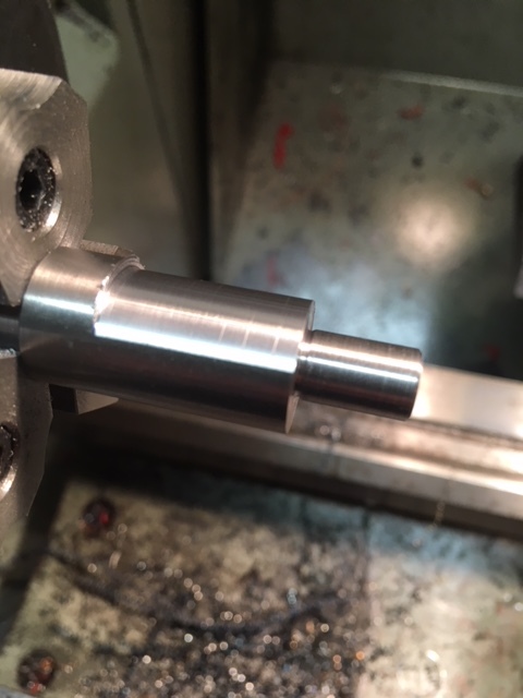

    With the chuck remounted in the lathe the eccentric diameter can be machined. The photo shows the first few cuts made.

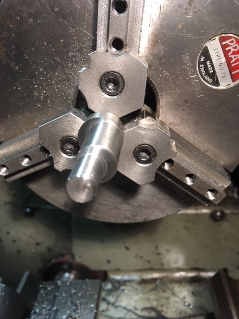

    Eccentric diameter machined to required diameter. This photo also shows the offset diameter machined in to the soft jaws.

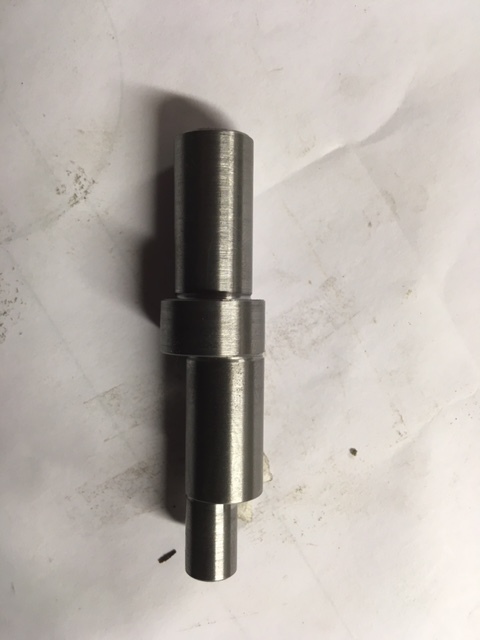

    Completed shaft
