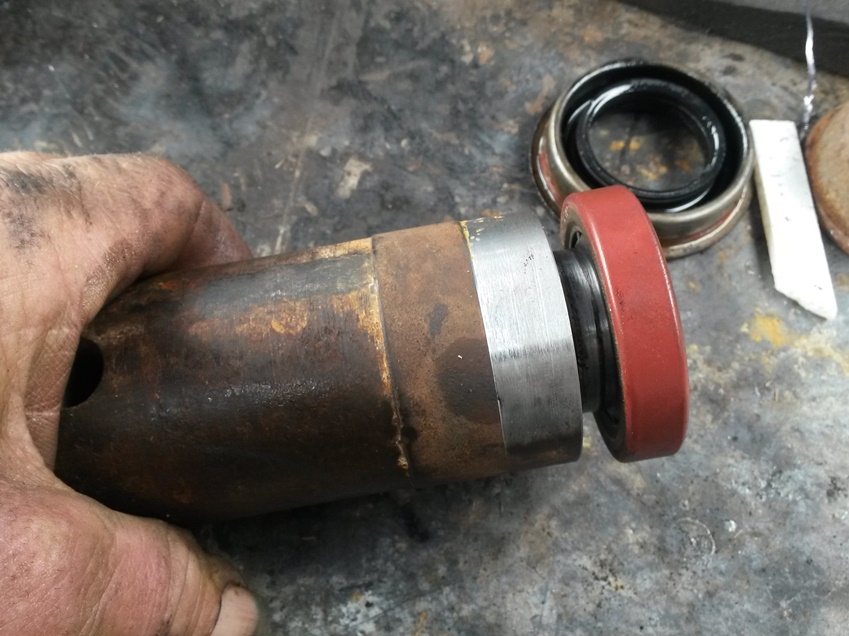

Here's the tip when installing an oil seal that has a spring under the lip it is always best to have an install tool which emulates the shaft which is going to be running in it. The reason for this is not all, but in some of the seals the spring can be dislodged when installing if there is no sealing surface present. For this reason alone I like to use a tool which protrudes through the seal itself while I am installing it.

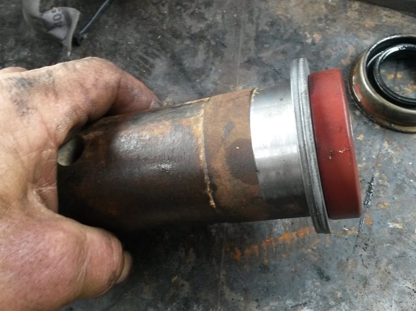

Since my tool that I made was machined so it could set the bearing deep in the housing to its stop it would only work to install the seal if the seal had a flange like the original factory seal. My replacement seals did not.
My solution rather than machine anohter tool I decided to simply use a couple of left over thick shims that came in the master rebuild kit. this limited the install tool to striking against the housing and insureing that the seal was installed to the proper depth and square
Attachment 24769
Attachment 24770

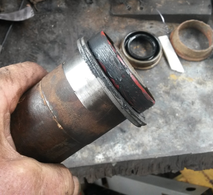

Another thing I do is to use a thin amount of sealant on the seal housing. My reason for doing this is sometimes the part that the seal is being installed in can have some damage to the surface the sealant helps to prevent leakage between the seal and the part.
Attachment 24771

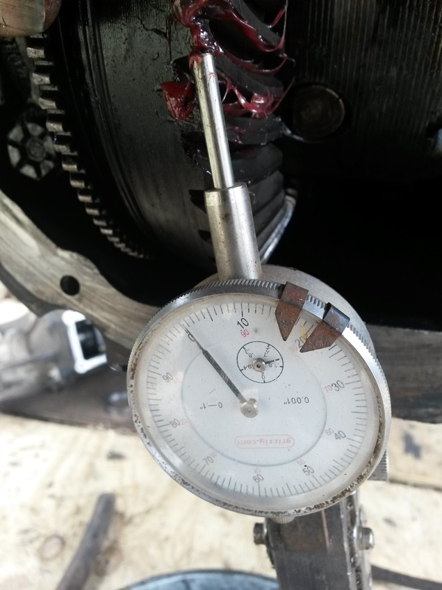

For setting the preload as mentioned in another thread and not shown since I didn't get a picture of the process. What you need to have is a torque wrench with a dial that reads in inch lbs. the factory specs for this diff were from 20 to 28 in.lb

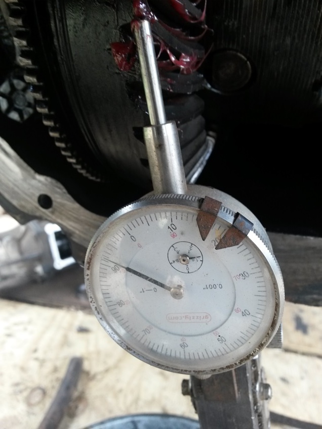

while the ring gear to pinion gear backlash was to be .008 to .012"
Attachment 24773
Right in the range
Attachment 24774
Should be no problems with this rear end for the life of the pickup.
