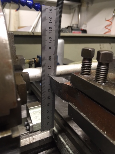

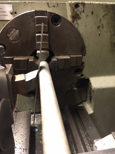

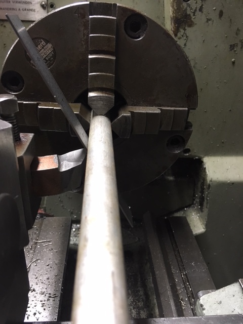

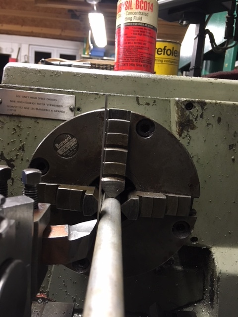

    Quote Originally Posted by thehomeengineer View Post
    Hi All
    I have seen a lot of lathe centre height setting gauges. (which I might add are nicely made) I usually set my tools against the revolving centre or dead centre from the tailstock. If I need to set a tool half way in to a job which is supported by the tailstock I use the following quick fix. I use a steel rule and simply set this between the work piece and the tool to be set. If the rule leans forward the tool is to high and if the rule leans back to low. So, when the rule is upright the tool is on centre height and therefore, the cutting edge must be at a 90-degree tangent to the centre line/height of the machine. Simply and very quick.
    photo showing rule between component and rule
    Attachment 22297
    Tool to high
    Attachment 22298
    Tool to low
    Attachment 22299
    Tool at centre height
    Attachment 22300
    Thank you for viewing
    The Home Engineer

    I can't recall EVER clicking 'Thanks' on so many posts in a thread. Because each is a valid point. Some lathes haven't a machined area on cross slide, making a gauge stand ineffective. That is a logical starting point for what to do instead. The vertical scale is most widely used; but like most tools just isn't the ticket for all situations.
    As one getting paid to run projects, has a lot to do about what is done when. One lathe runs a turret toolpost, heights are shimmed. Not bad for insert or brazed tools; PITA for HSS regrinds. My common approach is to set tool #1 with a scale.......then to scribe it lightly across the material. That scribed line is used to reference other cutters. If boring, I'll scribe the face as well. Using a height post here would triple+ time to complete a setup.
