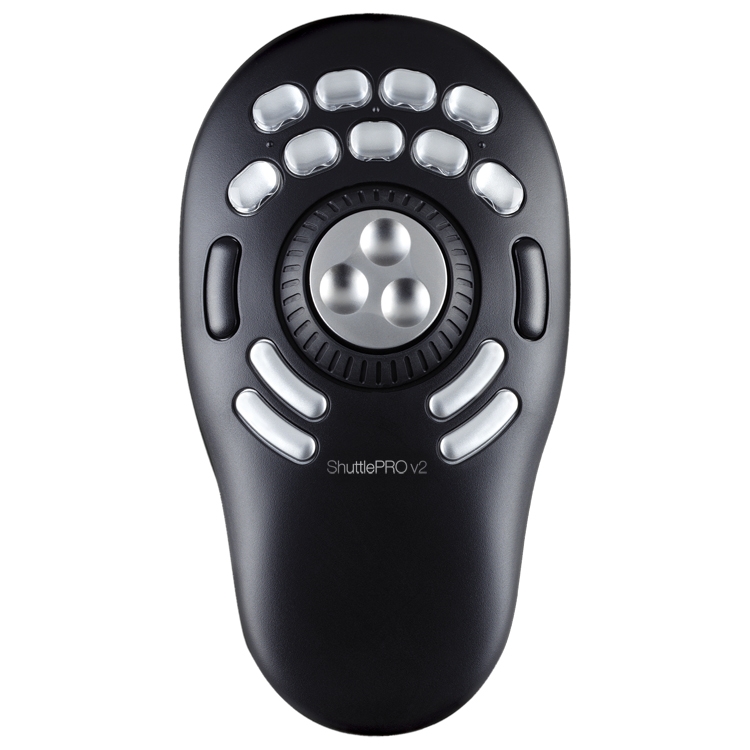

    Shuttle Pro 2
    Good job Rick.
    I've been using the Shuttle Pro 2 for the past 5 years and find it great to use as well but it costs around $100 here in Australia so for a cheap option the Xbox controller looks pretty bulletproof. I like the shuttle function on the shuttle pro and you can insert names under the keys to define what each key does and the driver has all the options available in Mach3 to assign to any key.
    Attached is a picture of one. It has a cord attached that is about 1.5m long so gives you a bit of room to play with and It's just another option out of the many you can use
    Rich.

    I like the compact design and the ability to put labels in the keys. My cord is of similar length and has let me move the table around while lying on the floor under the machine. Very handy.
