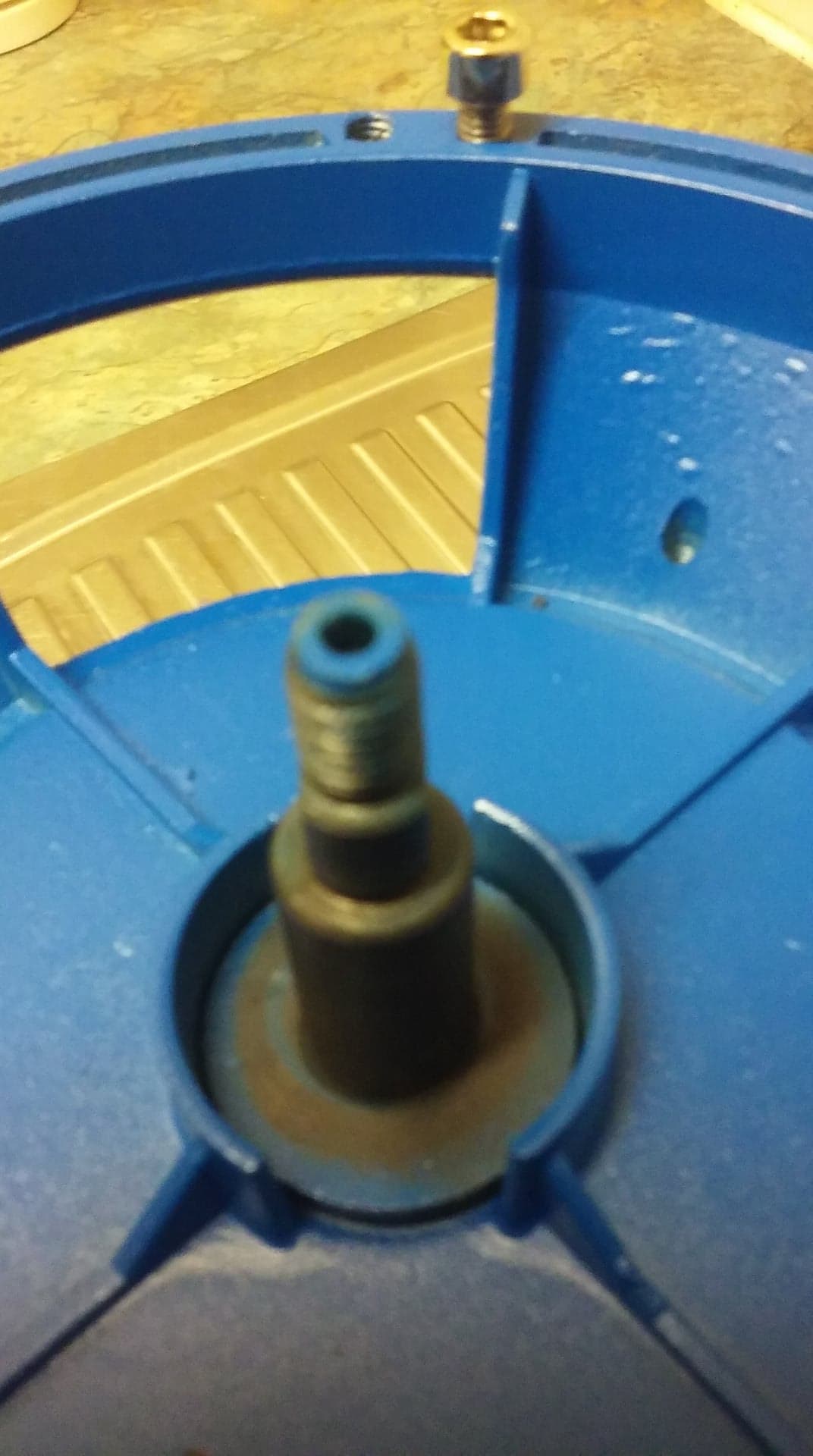

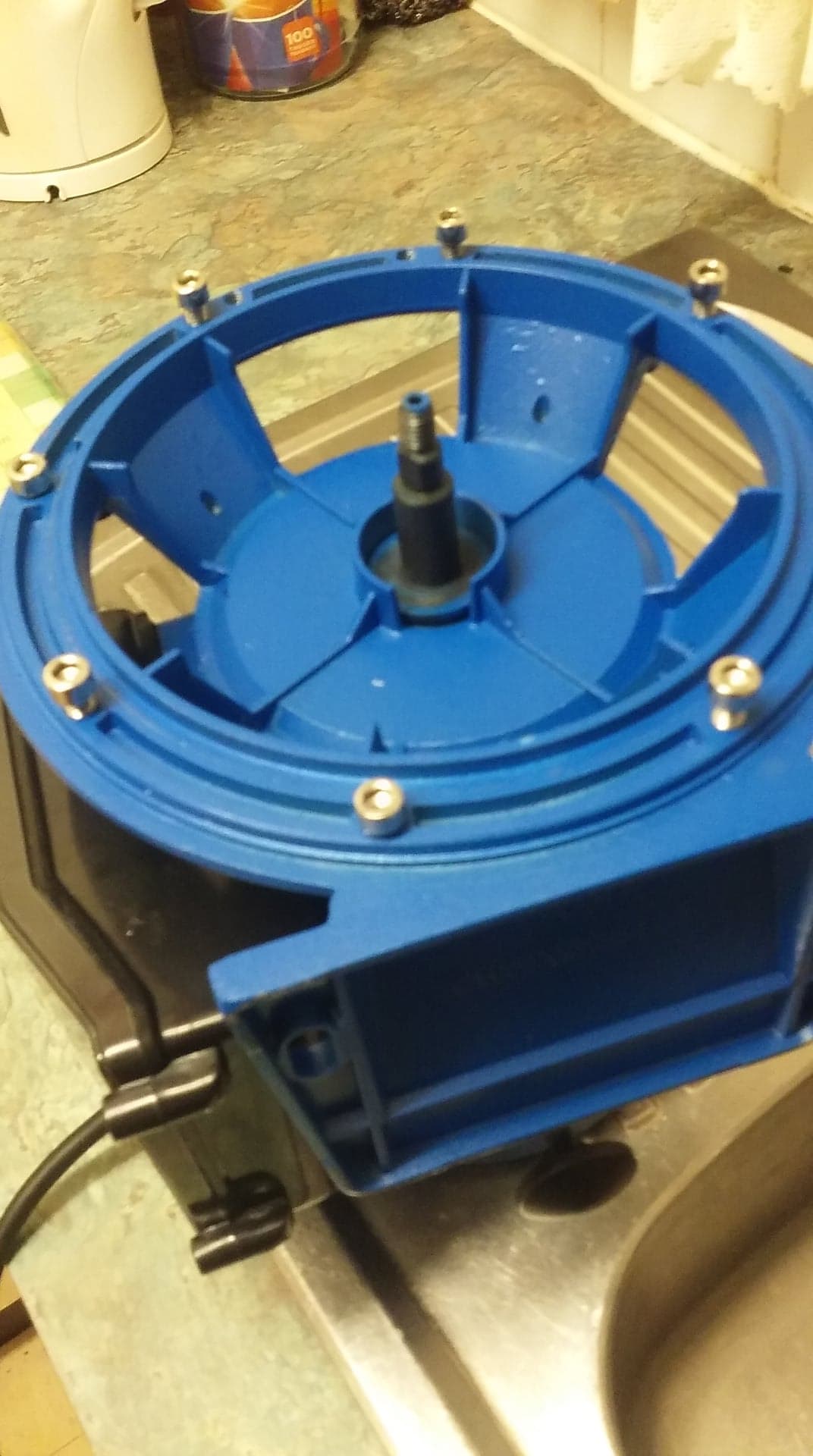

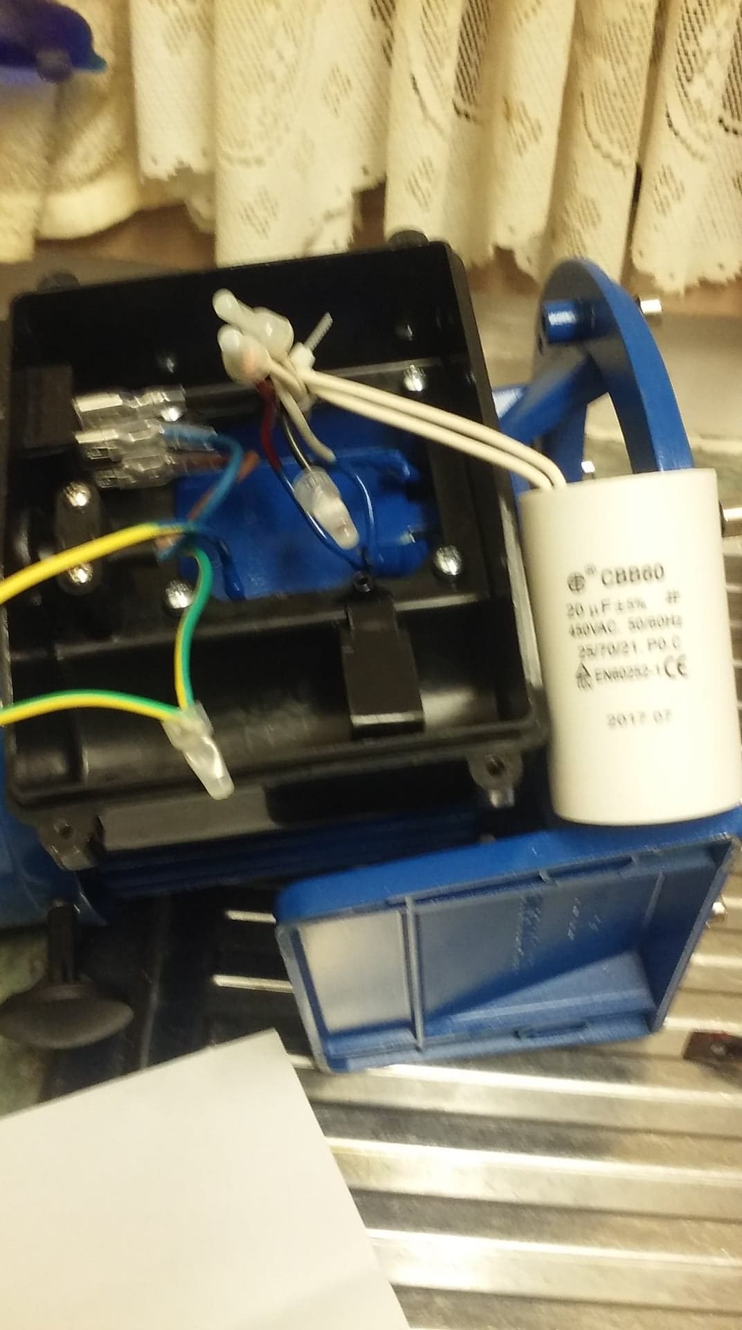

    Stripped down the motor some more and the shaft is 14mm then up to the 2 flats ,measuring over the flats looks to be 8.1mm and over the rounds it looks to be 10mm and then the thread v belts-42221607_515770605513286_8079687778540978176_n.jpg v belts-42156897_286304858871311_2964122738182062080_n.jpg I also pulled the switch box apart to see if there was any identification inside (there wasn't ) v belts-42272316_549602768809237_1094022384693805056_n.jpg

    A fun little trick that manufactures love to play on the consumer is to state the HP (wattage) rating of their motors based on the start up amperage. then call it peak hp.
    I'm no EE but I have found that this is often times about 2.5 to 3 times the actual full load running hp @ 85% efficiency. This is not to say that a 12 to 1500 watt motor will not put out over 3 hp for brief periods of time because it will and then some or at least until there is significant thermal rise then it will rapidly degrade.
    Your motor has a 14 mm shaft that has been turned down to a smaller size this would be consistent with a manufacture knowing their product is going to be used at around 1/2 or less the rating they state on the motor for most of the time.
    Just like the manufactures of hydraulic power units for automotive lifts most motors will have a rating of 2.5 to 3 hpthe actual HP of the motor according to NEMA rating would only be 2 HP. The shafts will be machined very similar to your's in size or have a slot cut across the end the little pumps will have an out put of 3.3 CC per revolution . but they will have the max pressure setting at 3000 PSI which at that flow rate would require double the amount of power the motor is rated for. They also know that the motor is capable of this output for a brief period of time and the average amount of time required per cycle will be within the limits of the overload protection. Some will install a larger run capacitor and post a 4 HP rating on their motors.
    Without actually installing a flywheel on your motor and running a friction load test while monitoring the amperage draw and temperature rise there is no real way of knowing the true power output of your motor. but I suspect that it would be somewhere in the range of 14 to 1500 watts @ 85% efficiency continuous. and 40°c thermally protected.
    All Correct Frank (imho), and the last paragraph is where I would start...find out what you actually have. Somewhere back when on HMT, I wrote a small dissertation on Vacuum motor HP ratings and what you actually get and why the hype. Thing that bothers me about this motor is it doesn't have a data plate...at all (not a good sign to me)! A design like this needs to have all the components matched for the tasks at hand...especially the yoke and oscillation rate. Working forward from the motor to see what capacity sanding it can actually accommodate, by trying to stay in the 85% continuous efficiency ball park using whatever shaft/sheaves and couplings sizes to keep it in the zone.
