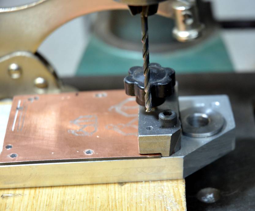

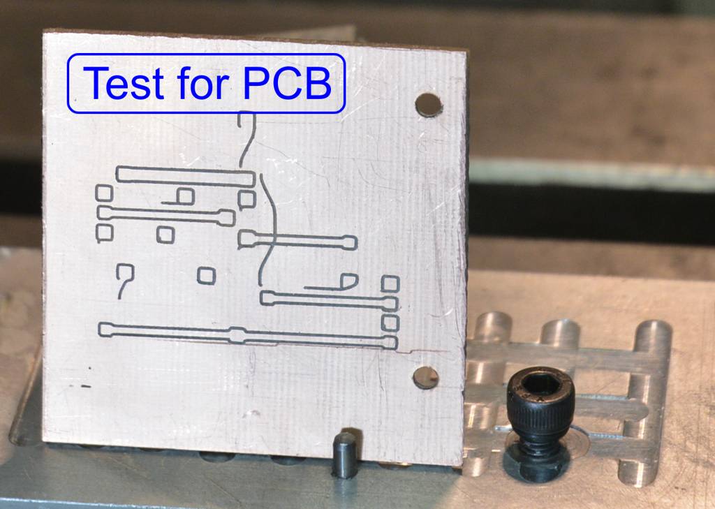

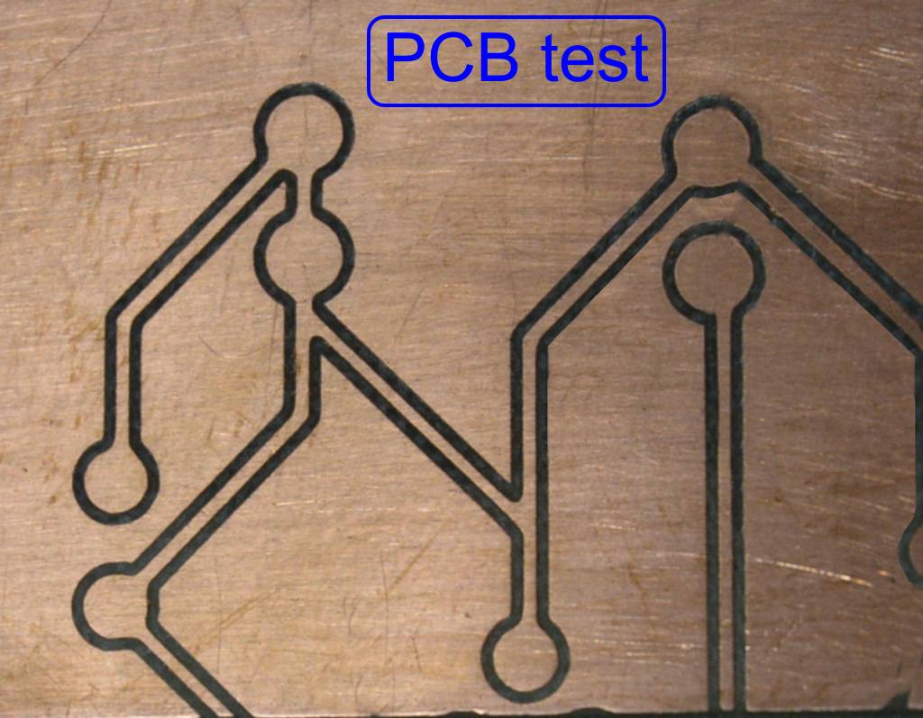

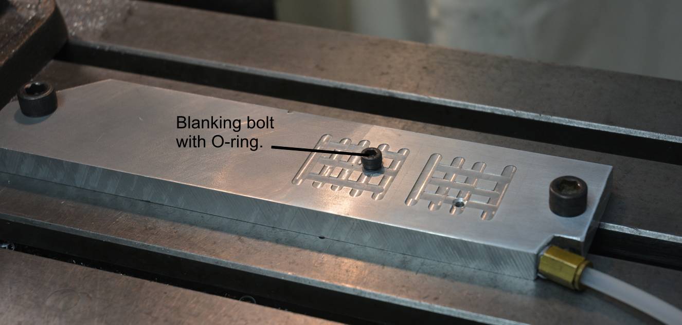

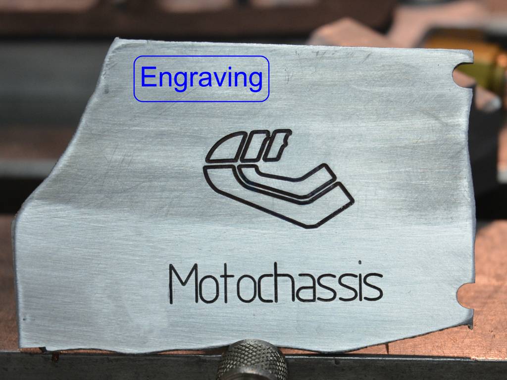

    I present a description of a small vacuum chuck that I made for holding pieces of PCB for isolation milling as well as pieces for engraving.
    Vacuum chuck for PCB milling and engraving.-engraving.jpg Vacuum chuck for PCB milling and engraving.-firsttest.jpg Click thumbnails for full size.

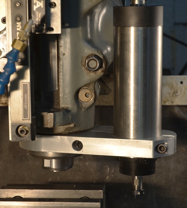

    Above we have a couple of test examples. The milling was done with a small D bit in a high speed spindle clamped to the quill.

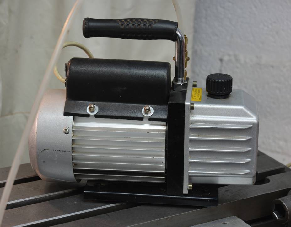

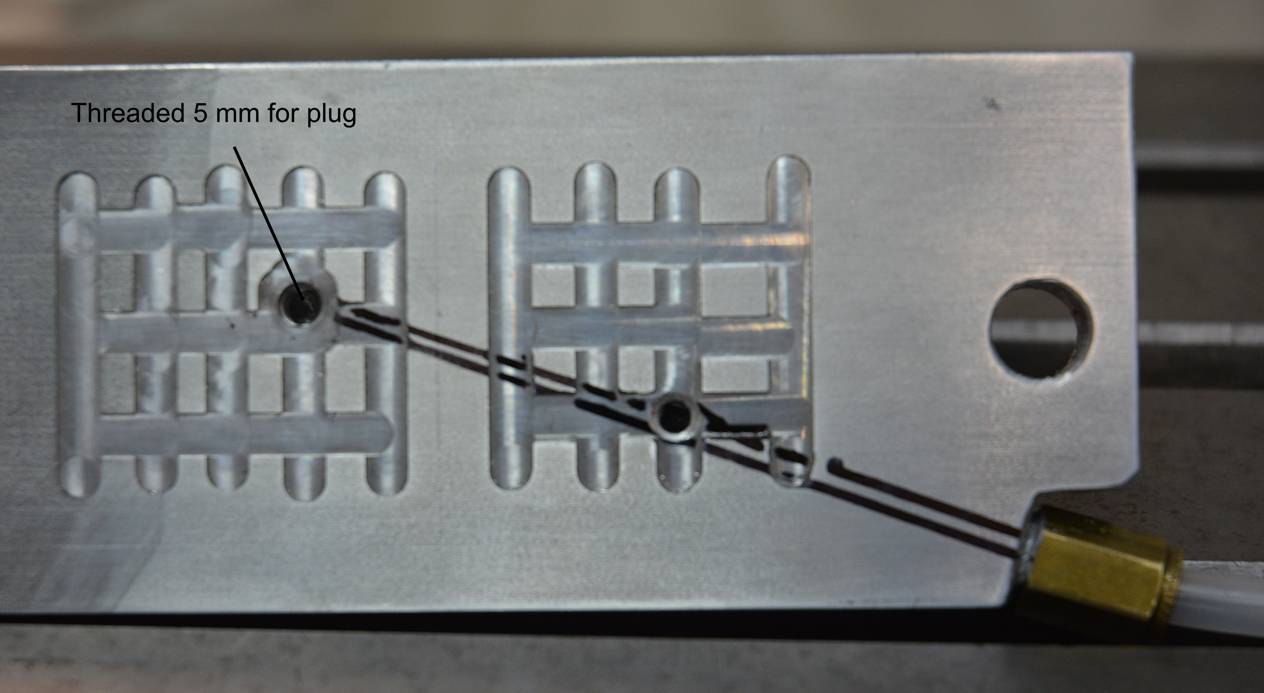

    In that I describe the manufacture of the chuck as well as discuss the vacuum needed and ways to get it. The process of milling some pieces is also shown. Don't forget to like, share and subscribe to the video channel to ensure notice of forthcoming videos.

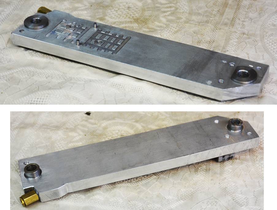

    In the meantime here are a few stills.
    Vacuum chuck for PCB milling and engraving.-vacplate02.jpg Vacuum chuck for PCB milling and engraving.-vacplate03.jpg
    Vacuum chuck for PCB milling and engraving.-vacpump.jpg Vacuum chuck for PCB milling and engraving.-drill-jig03.jpg
    Vacuum chuck for PCB milling and engraving.-pcb-test.jpg Vacuum chuck for PCB milling and engraving.-alignment-bushes.jpg
