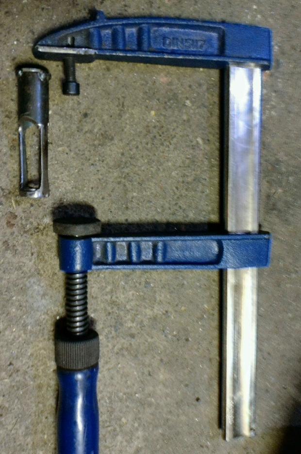

Head can be swapped according to spring size. I drilled and threaded lower part for slotted pipe. Much faster to install springs than with levering tool.
