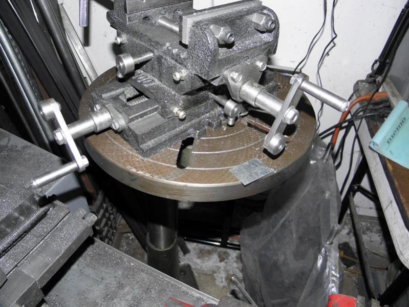

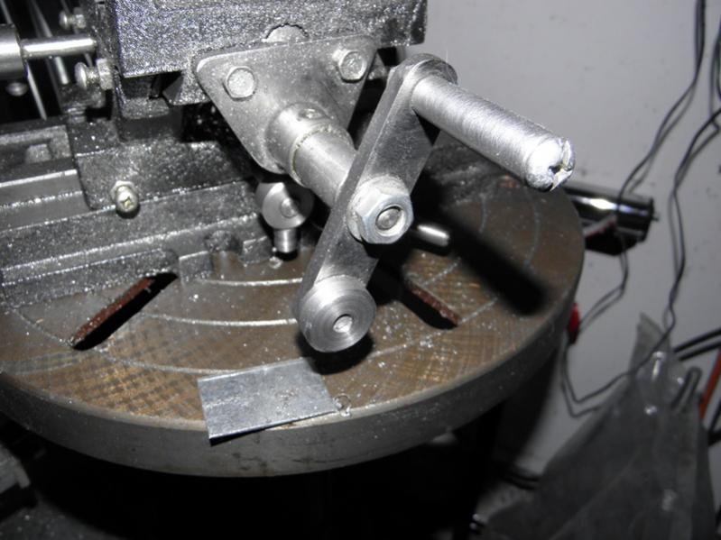

Vice Handle Modification HF. I modified the handles,jaws,triangular screw anchors and stop thumb wheels.

I have the same, can you explain why you did so ? The handles for instance ?

Hi Christophe, I don't like sloppy lead screws so I replaced the mounting triangle plate then I made weighted turn handles for easier turning, the jaws were marring my work pieces so I put aluminum jaws on, and I wanted to lock the vise so I installed long shaft thumb tighteners for repeatability. :O)Attachment 2207
