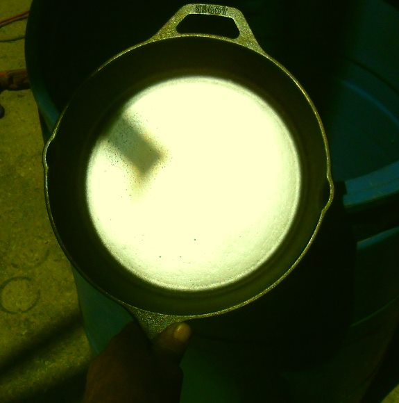

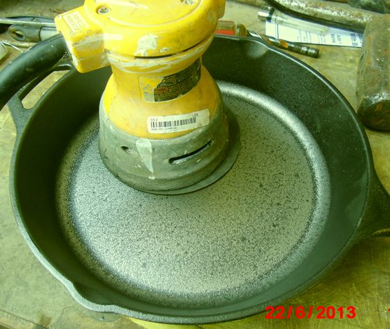

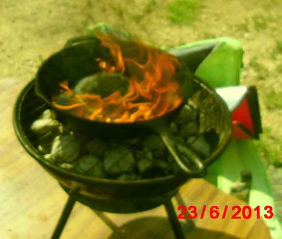

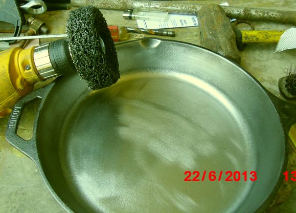

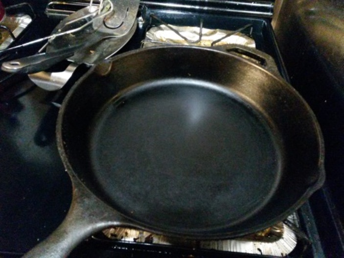

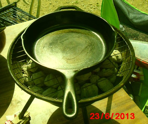

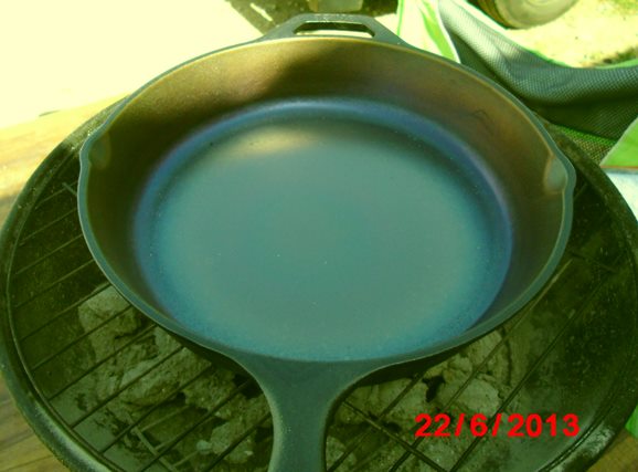

First off I used a sander to smooth the inside I kept sanding until I was using 400 grit making the inside look like a mirror then poured in cooking oil and heated on an outside grill until oil had completely burned away. I polished it and did this again a couple of times
Attachment 18931
Attachment 18932 Attachment 18933 Attachment 18934 Attachment 18935 Attachment 18936

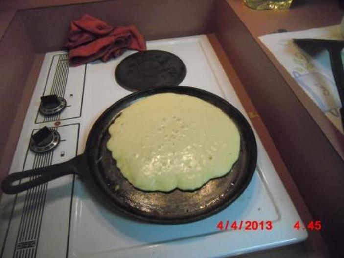

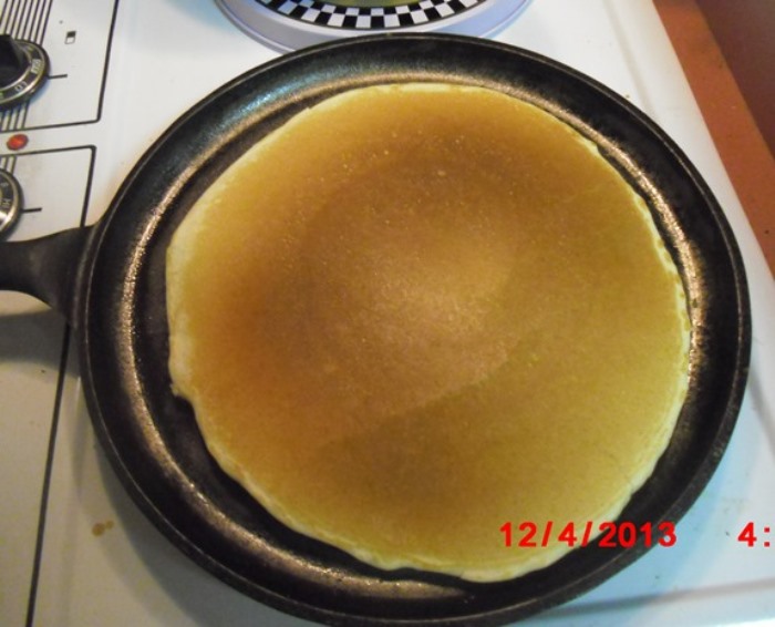

And the flat skillet
Attachment 18938 Attachment 18939
4 years later
Attachment 18937
