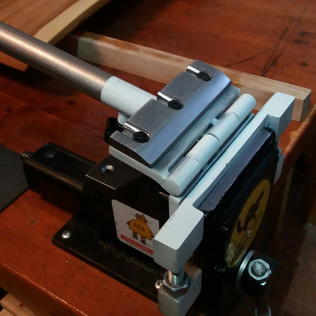

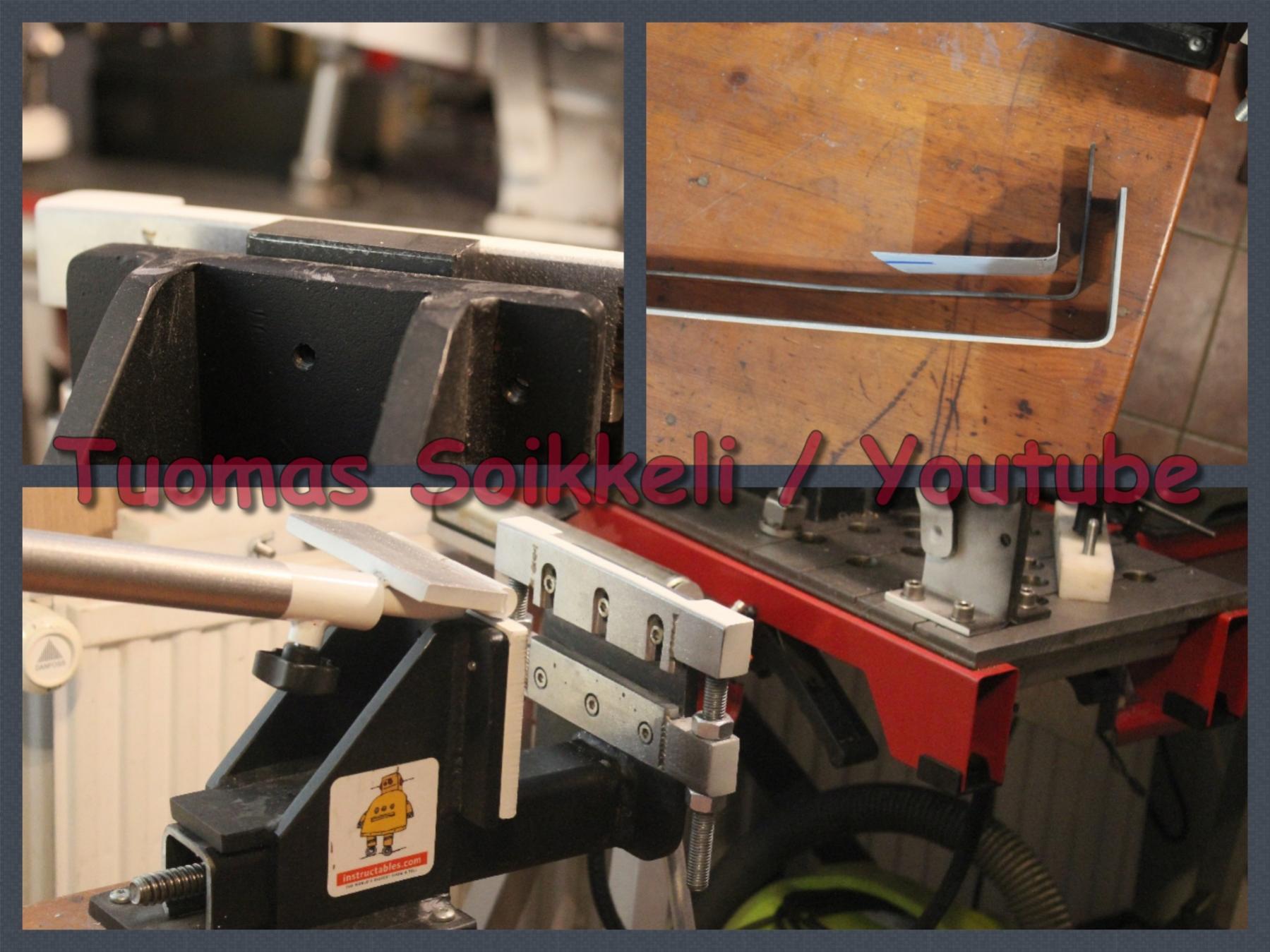

Improvement nro 1
Height adjusted front jaw. Gives more support when filing, and allows better view to the object. Specially with thin materials.
Allows to adjust bending radius unportable.
Attachment 21877
Video coming later.
Improvement nro 1
Attachment 21877
Video coming later.

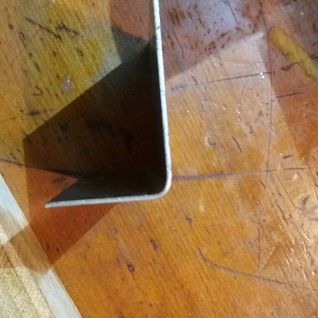

One more add...
Attachment 22062
Now i can adjust the position of the point that leans against workpiece. This gives more symmetrical result.
Attachment 22063
