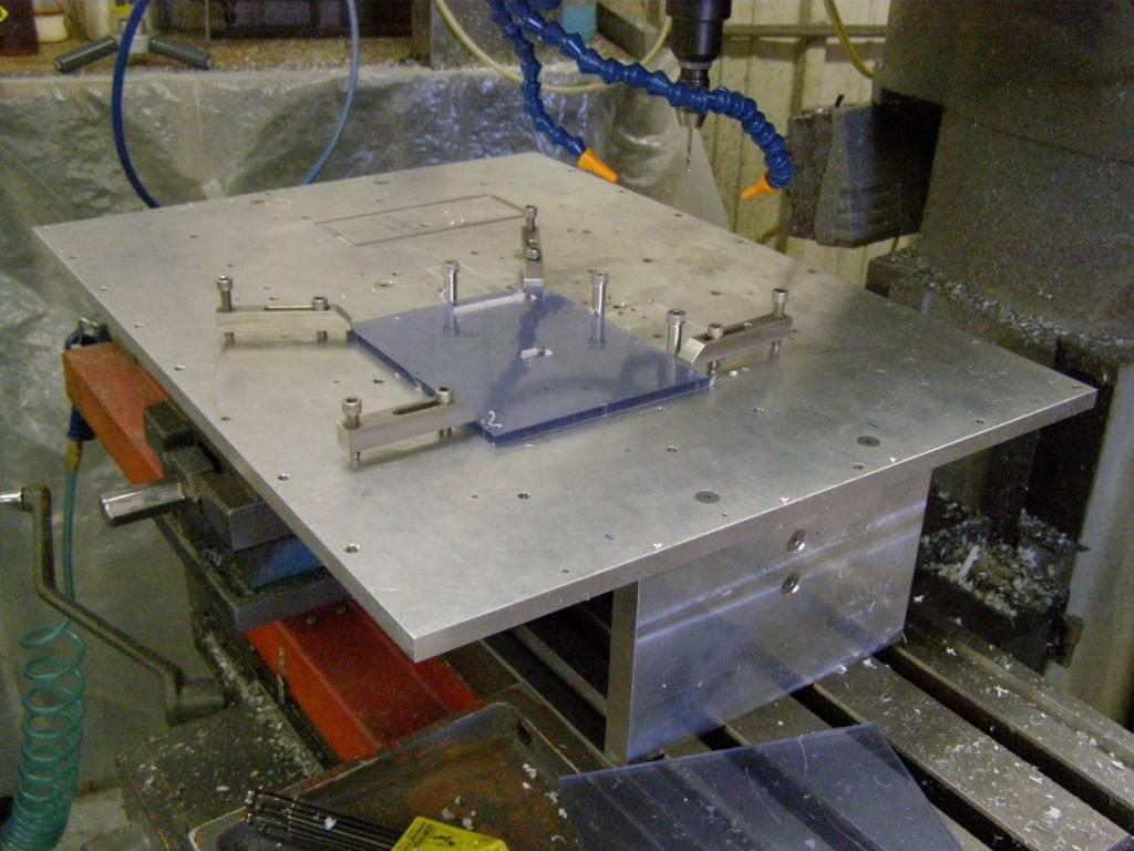

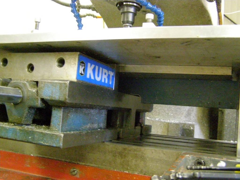

I often find myself needing to machine flat parts that don't easily fit in the mill vise. I came up with a platform the straddles the vise and held by the vise. It has 1/4-20 tapped holes and the parts are located with shoulder bolts and held with toe clamps.
