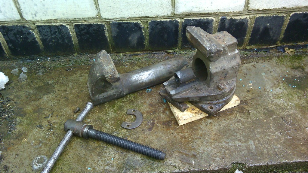

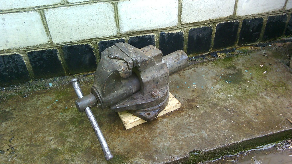

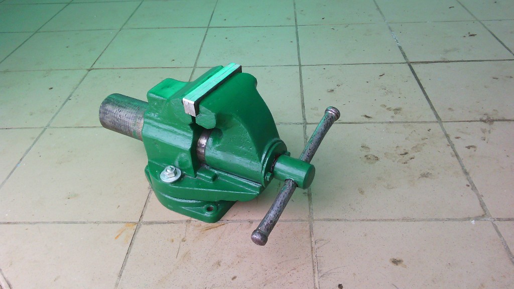

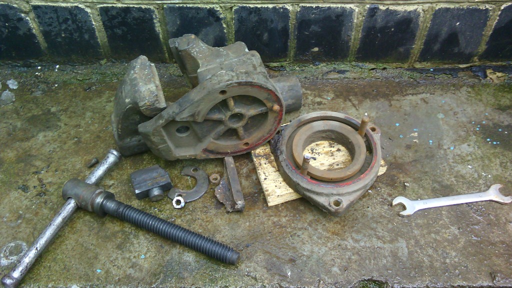

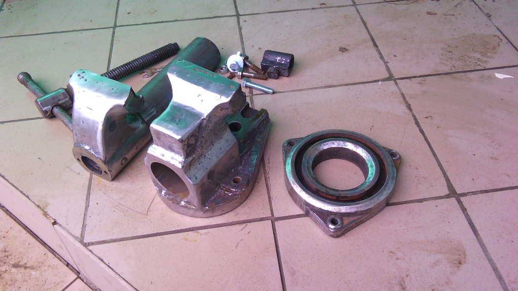

I found this old vise and decide to give this tool a new life.
Attachment 21029 Attachment 21030 Attachment 21031
Attachment 21032 Attachment 21033

Nice job and looks like a strong vice that will last, even with the abuse we all inflict on this important item within the workshop. I think the vice is one of the most used tools in my workshop gets used for all kinds of jobs: a press, bender, light anvil, and not forgetting a vice lol. A good quality vice clamped to a strong bench is a must. Well worth the effort in restoring this one, vices are not cheap.

That is one beautiful vise. Now it ready for a life of good care.
