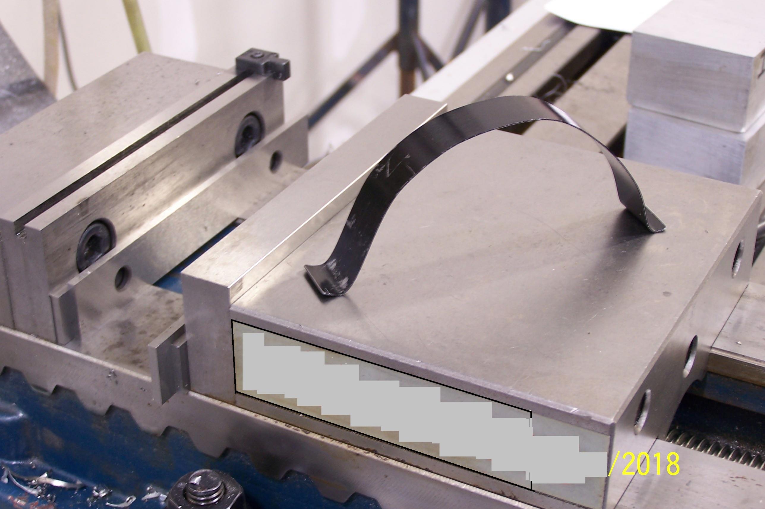

I commonly retain them with an arched spring, using steel tape found on palletized shipments.
Attachment 22778

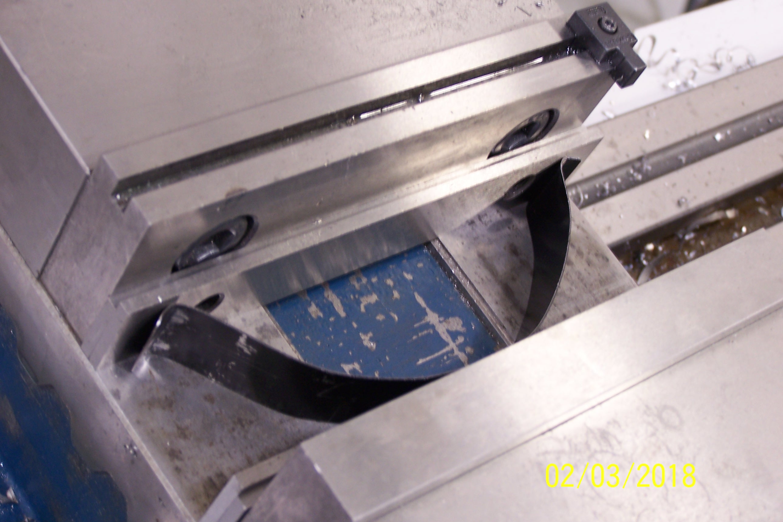

Common sizes are 1/2", 3/4" and 1" wide, add a couple leaves when more pressure is required.
Attachment 22779

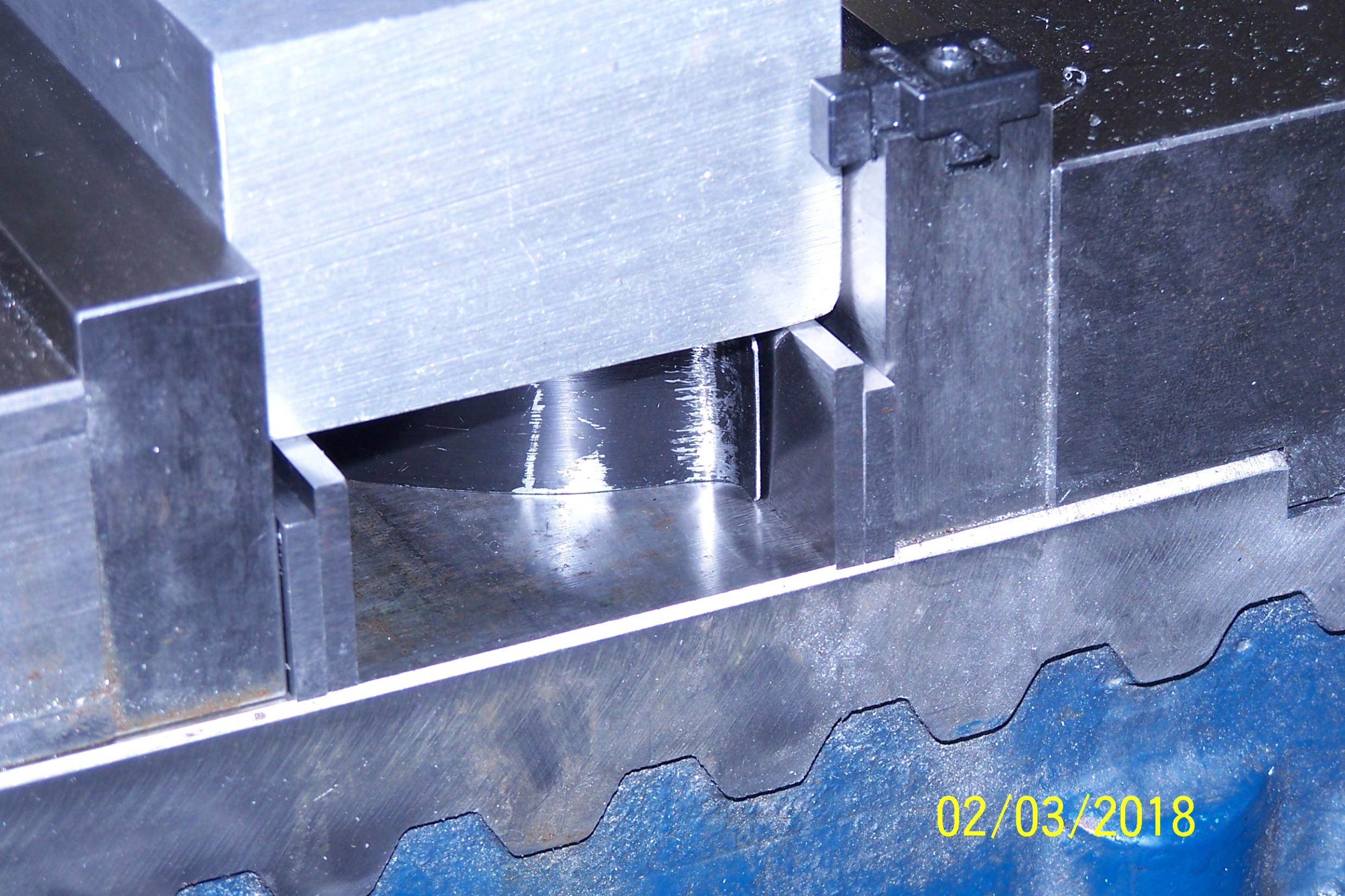

Notice the trick for sawn material, to avoid the burr at the lower edges.
Attachment 22780
Narrower parallels on the outside give plenty of burr clearance. Saves a lot of time in multiple parts, first off by saving at least one de-burr on each.
