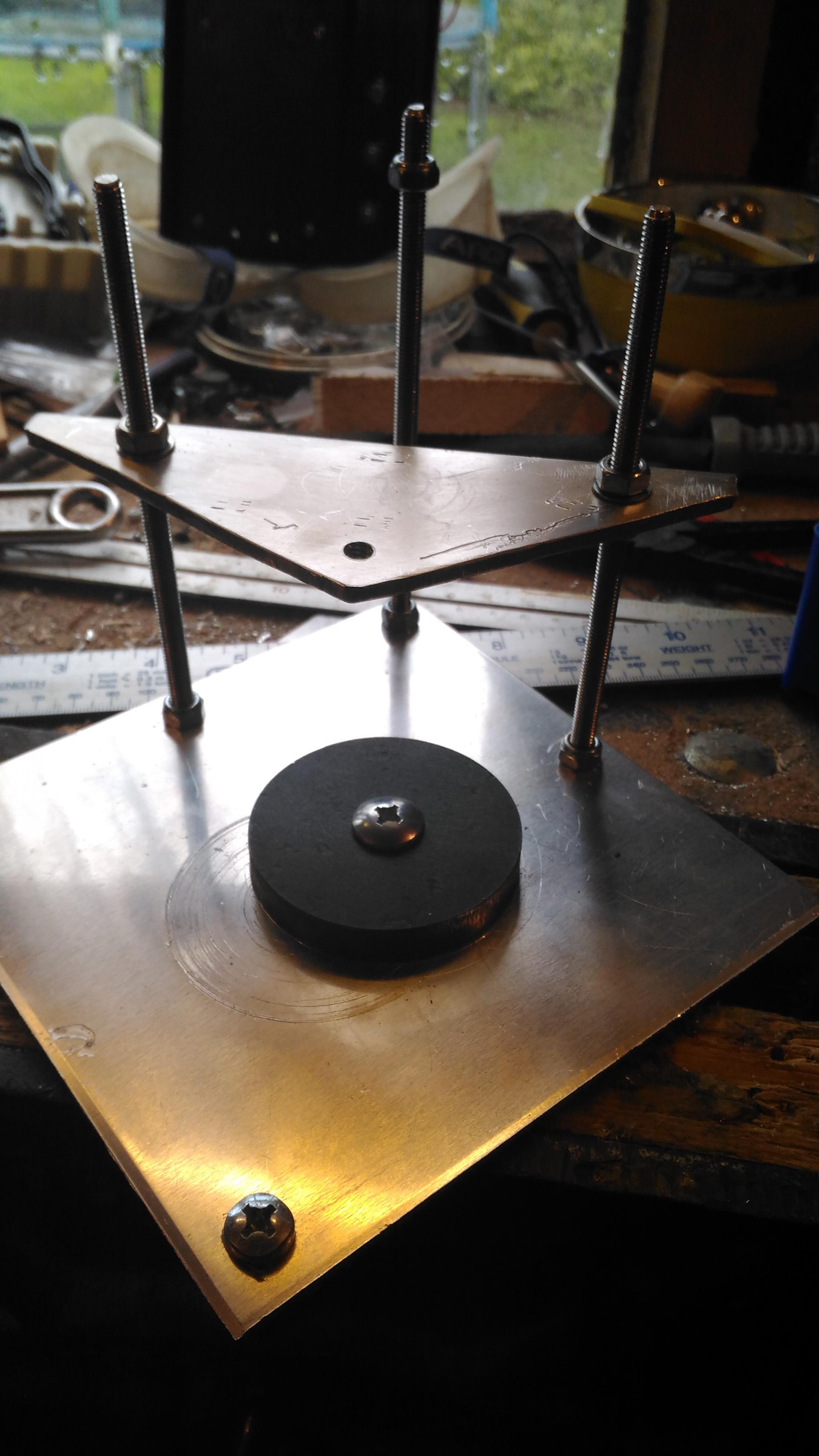

Attachment 16931
Again commercial models were outside of my funding bracket, so went back to basics to make my own.
Essentially just a series of plates, precisely drilled on my pillar drill, and then tapped to receive a threaded bar. As the bar is M6 in size - 1 turn is exactly 1mm.
When assembled I held the plates apart by nylock nuts, which also then allowed me to precisely adjust the plates to be parallel to each other and the base. the "anvil" is simply a piece circular steel, which I will drill in alignment with the pusher to hold wheel arbours etc. This can be unscrewed to make way for a pin vise.

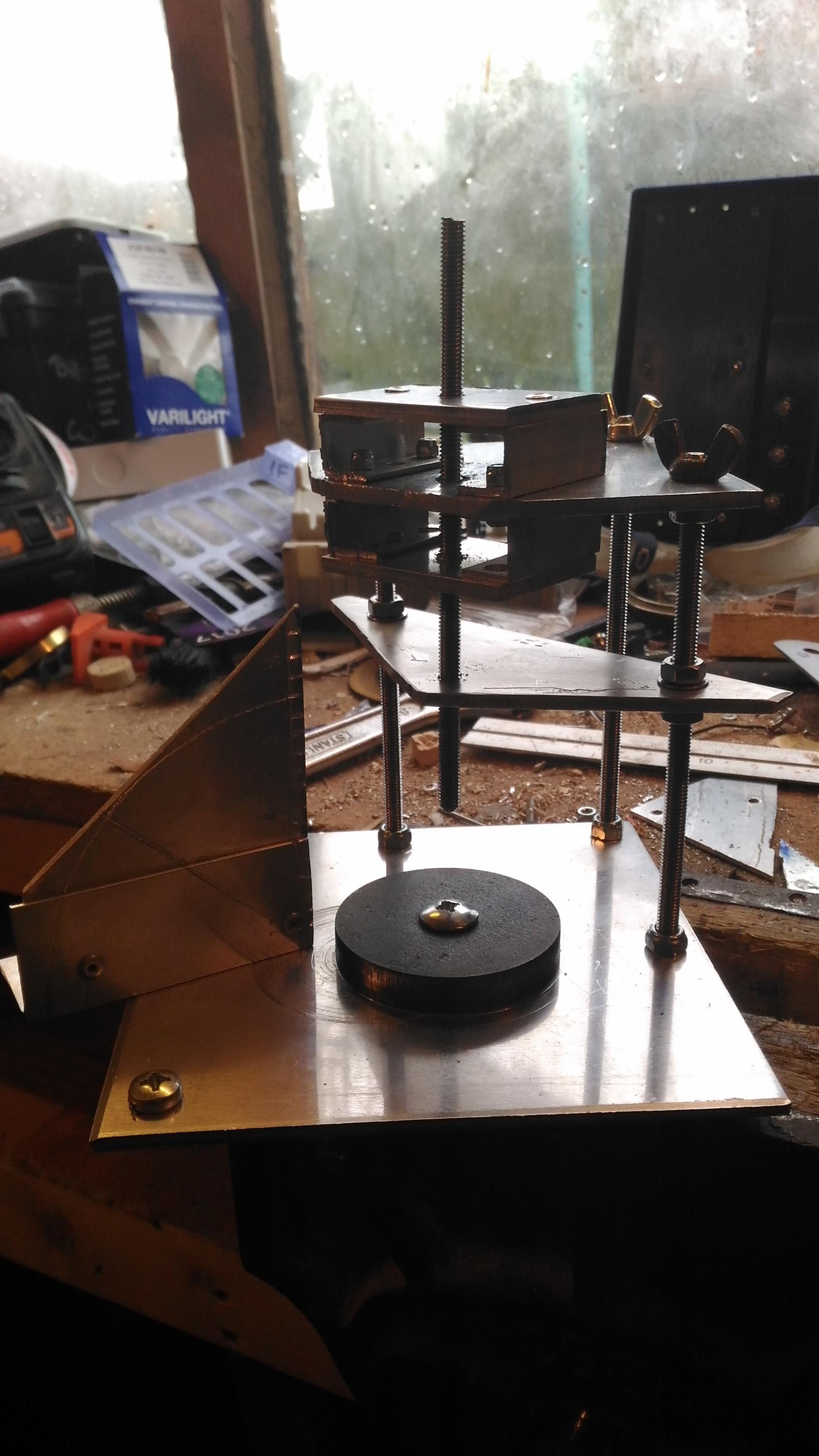

Attachment 16933

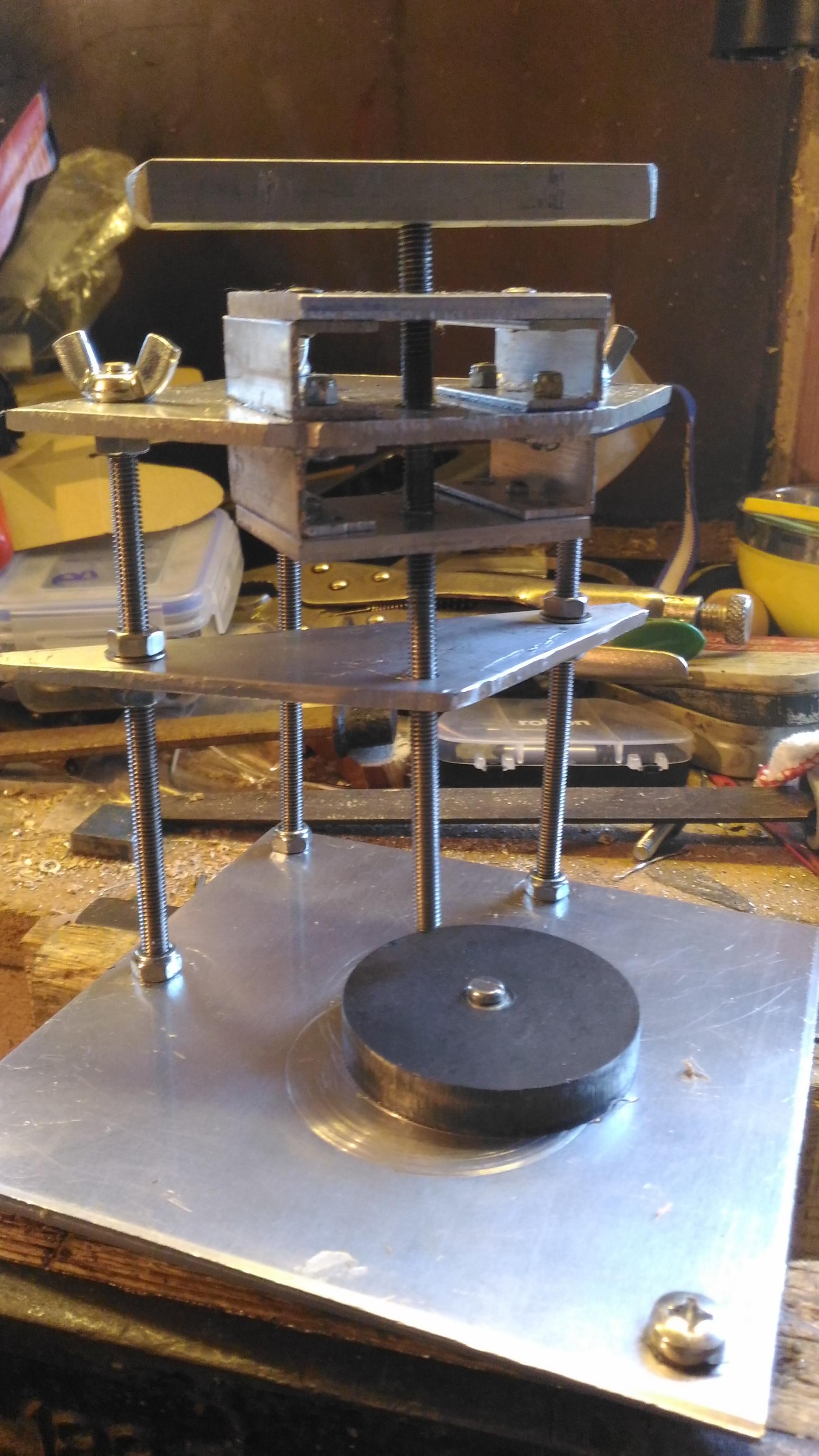

Finally I cut a piece of bar, threaded it half way and screwed this onto the top, then soldered in place
Attachment 16932
