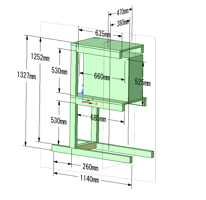

Hello gents, I am a newbie to here aboard from Yokohama, and a hobbyist welder. Last summer I got an old but a refurbished TIG welder made by Hitachi Co. that weighs nearly 40 and some kilograms so made up my mind to make a ruck for her so that she should not accumulate much metallic dust from the floor. I designed her on a 3D CAD, Spaceclaim provided from Designspark;
https://www.rs-online.com/designspark/home
This is the one I did on this CAD;
Attachment 23050
This ruck has two tables jointed to the main post at the back cantilevered, so that this can provide me a lot more utility in operation.

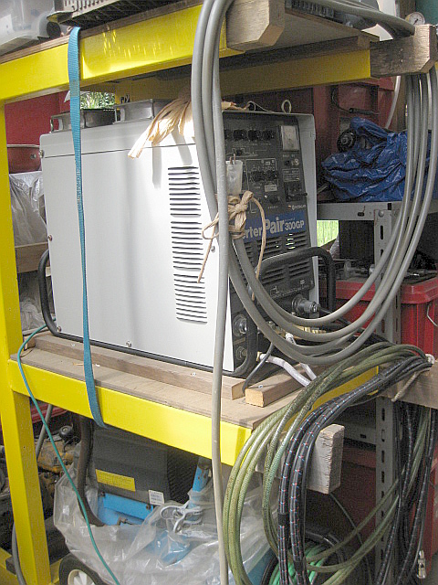

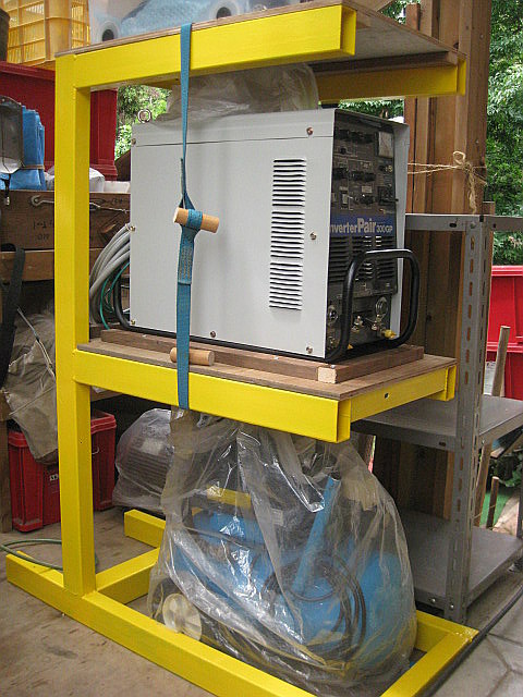

Now it looks like:
Attachment 23052

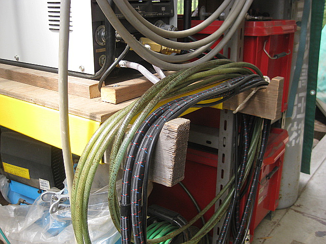

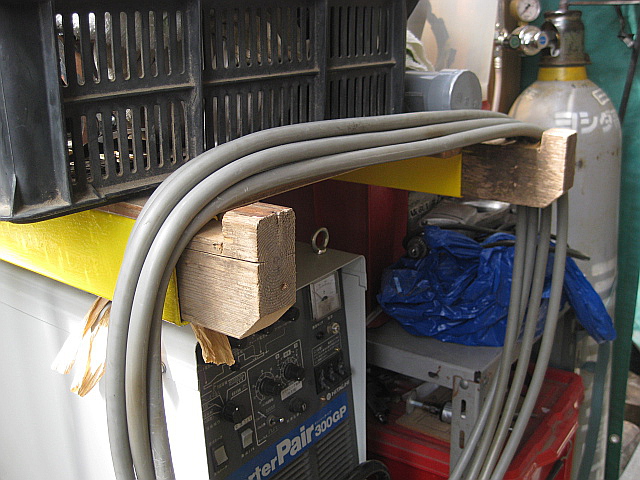

At the front ends of each table I put a couple of wooden hooks that can slide in the horizontal arms.
Attachment 23053
Attachment 23054
