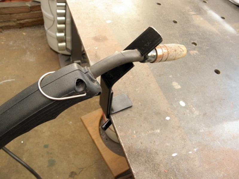

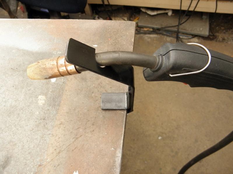

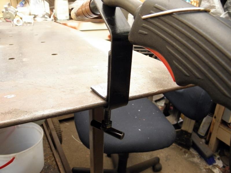

Welder tip holder made form 1"x1/8" bar stock and 1 5/16 bolt and small rod. :O)

Little things, but makes the shop tidier and more pleasant to work in.
Yes it does, DIYer I can tell you see the light...:O)

As a new-to-welding-and-metalwork dude I like the idea of using welding to help with various jigs and doodads especially anything that makes my woodworking easier :lol:
Have started simply welding small rod to bolts to make easy turning t-handles - I have arthritic hands and it's a bugger hand tightening knobs.
