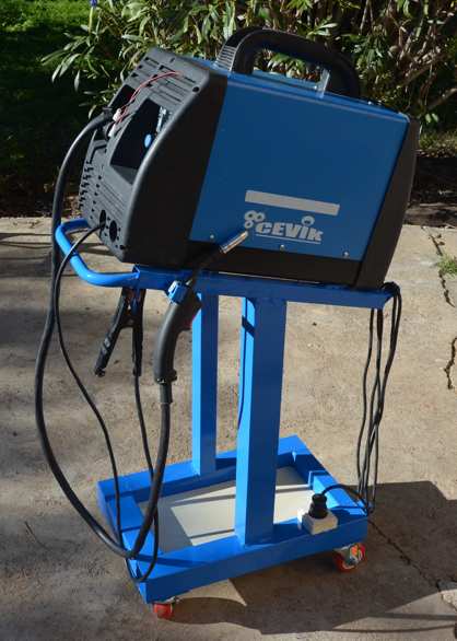

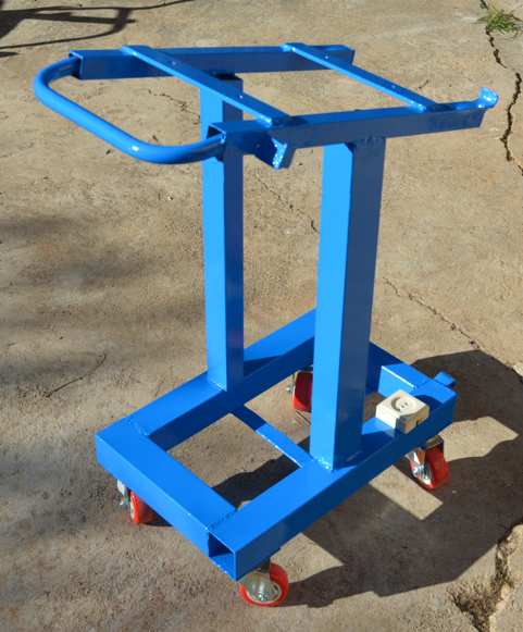

I do like your trolley, it was just that I didn't notice provisions for a bottle I have a couple of the small or as I call them baby mig machines one has .023" wire with 75/25 on it and on the other I keep the .030" flux cored gasless wire then there is my medium sized unit that I might have .030" ER70S6 solid wire or .045" duel shield flux core depending on application I might use CO2 or the Argon/CO2 mix. I much prefer my 450 or 600 amp machines but since they are 3 ph and require up to 15 KW to run them I haven't been able to use either one in quite awhile since I didn't have a generator large enough to pull them and my rotary phase converter is nowhere near large enough to supply the current.
