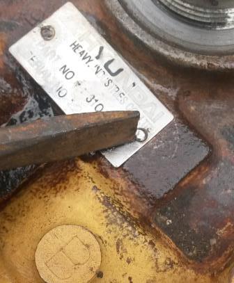

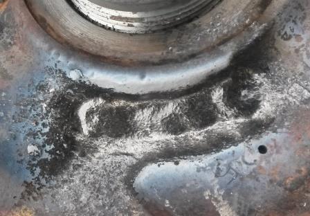

After inspection and cleaning carefully remove the drive screws that hold any data tags if they are in the effected areas
I sometimes use the corner point of a reasonably sharp chisel against the edge of the screw These things are like rivets in a way but they are almost threaded with a very steep TPI just turning them about 1/4 turn will loosen them enough to grab them with a pliers so you can twist and remove them. Unless you have a ready supply of them be sure to save them for reinstall. Data tags may not mean much to you the repairman but TRUST ME they are very important to someone.

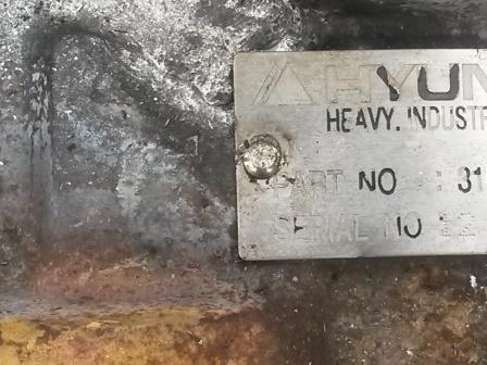

Attachment 14657
now that the area is ground deep enough and wide enough it is ready to weld. Notice the grove is as wide as it is deep and smooth.

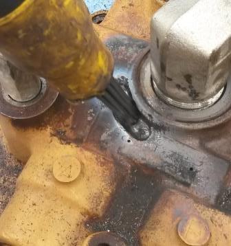

Attachment 14658
Note the needle scaler I'm not sure how many passes I have made at this point but the process is the same for each one.

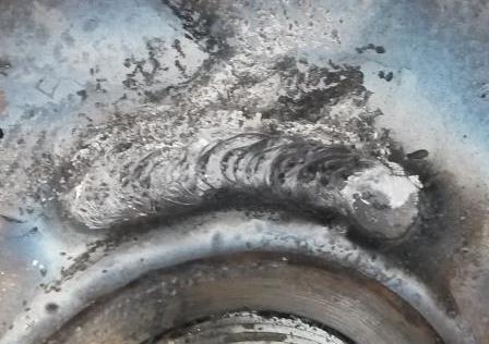

Attachment 14659
this is a pass before annealing with the needle gun

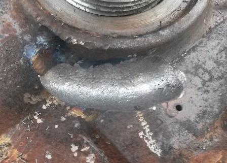

Attachment 14660
This is what it looks like with a few strikes just enough to remove the flux
Attachment 14661
After 10000 strikes

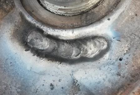

Attachment 14662
Job done
Attachment 14663
OK my choice of fillers was AMTEC 133 1/8" for this job
I hope this helps someone in the future
