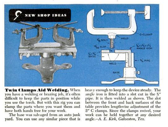

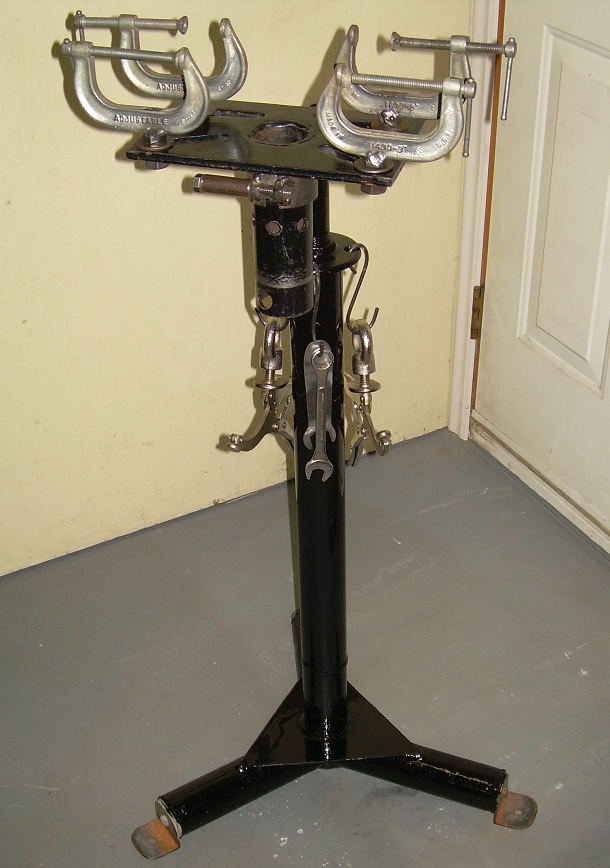

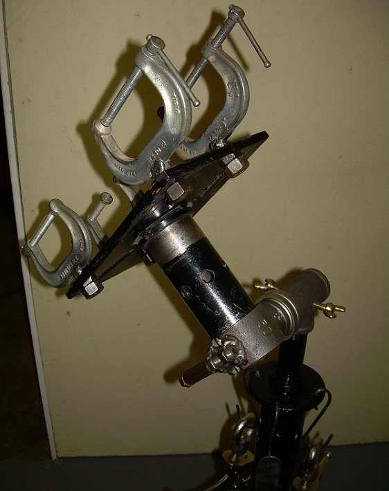

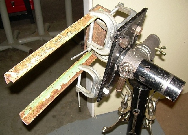

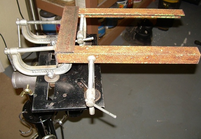

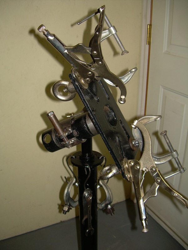

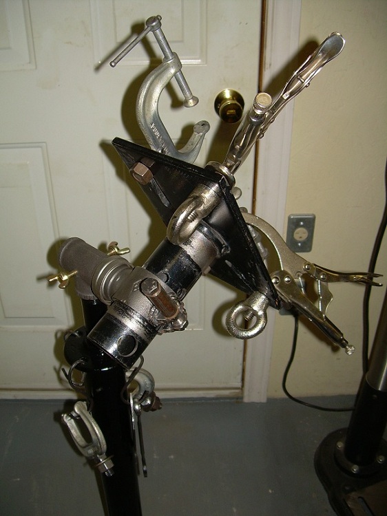

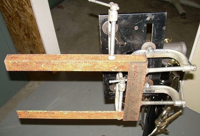

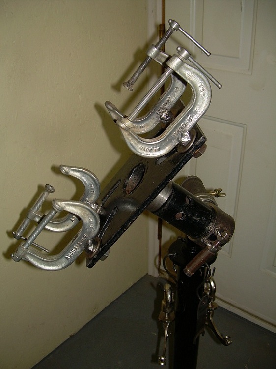

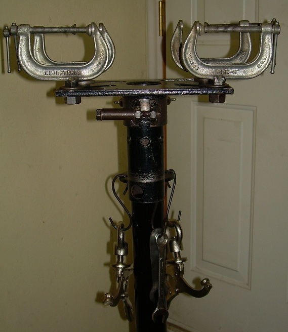

I built this fixture late last year after seeing the tip illustrated in the first pic. somewhere on the web.When I find large enough wing nuts I will change out the nuts that require the wrenches seen on the hooks. This will make set-up even faster than it already is. The fixture can rotate 360* in two planes to allow me to make flat welds when a position weld would challenge my welding abilities. The fixture is all built from pipe and pipe fittings except for the table which is a motor mount from a discarded motor stand. The last 3 pictures is an example of the quick set-up of a small angle frame for welding.
