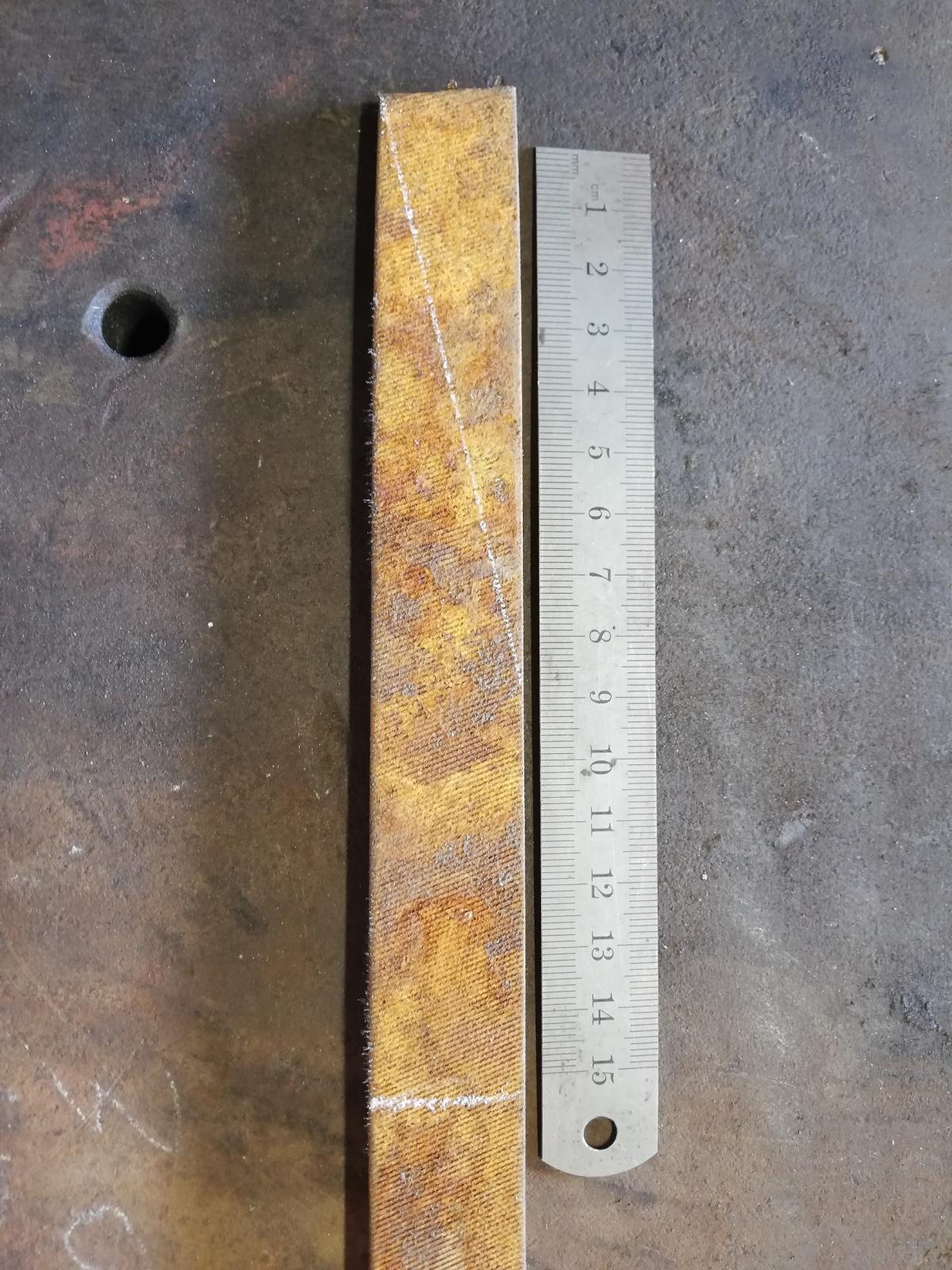

Attachment 29274

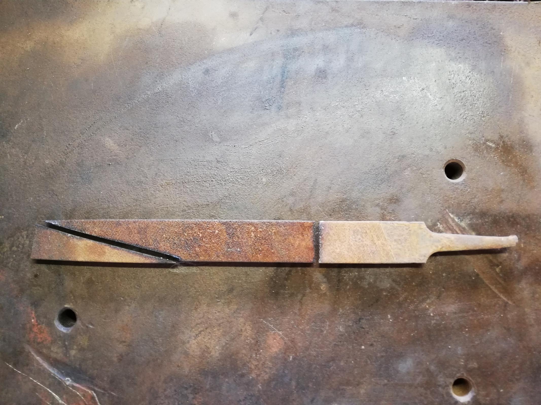

This file is approximately 6mm thick and about 2cm wide and marked out to rough proportions like on the picture.

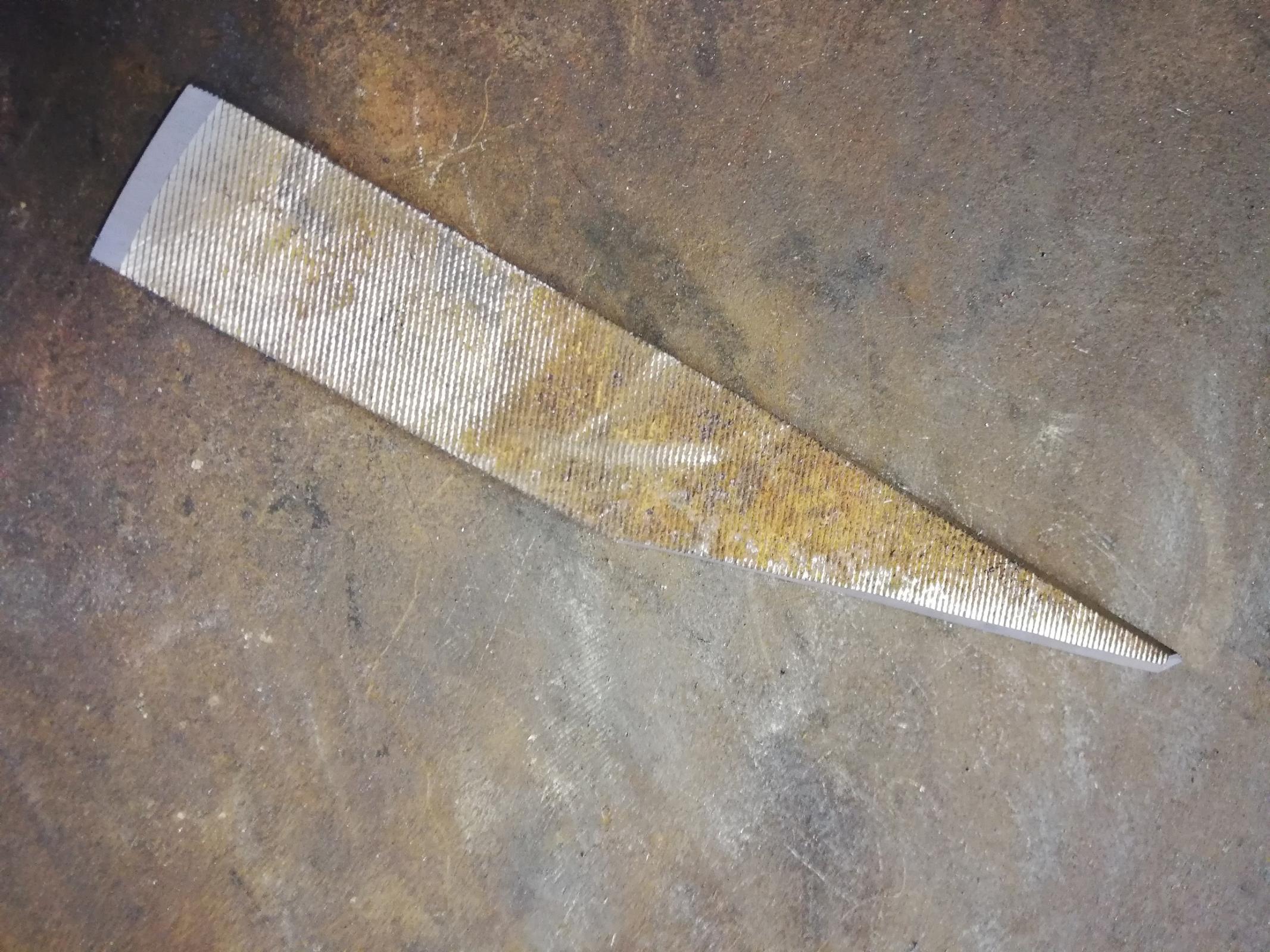

Attachment 29275
It is then cut up, taking care to not heat up he metal too much so that the hardness of the file is retained.

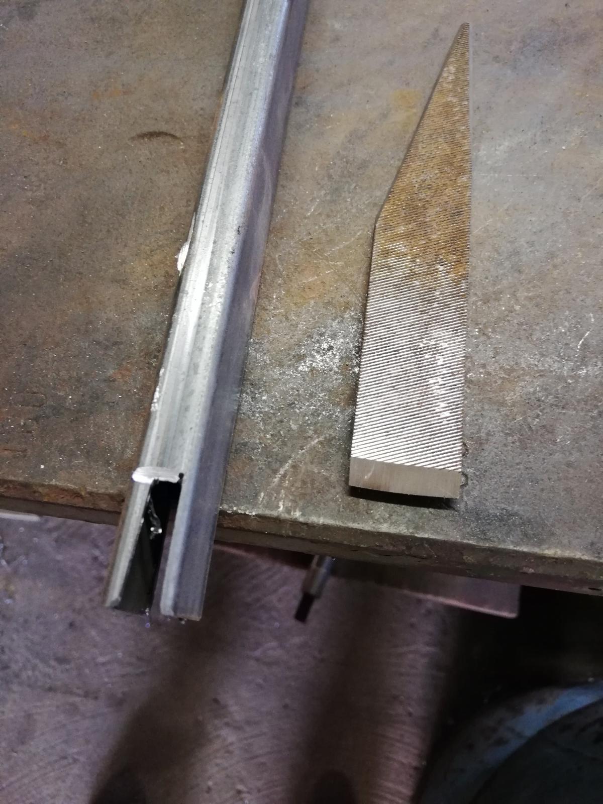

A handy piece of 25 x 12 rectangular tube lying around is cut to approximately 300mm and a slot is measured out and cut to receive the hammer head. I prefer rectangular or square material that does not tend to slip and turn in your hand. In this case the dimensions of the tube makes it unnecessary to add a grip to the handle. Flat bar also works just fine.
Attachment 29277Attachment 29278

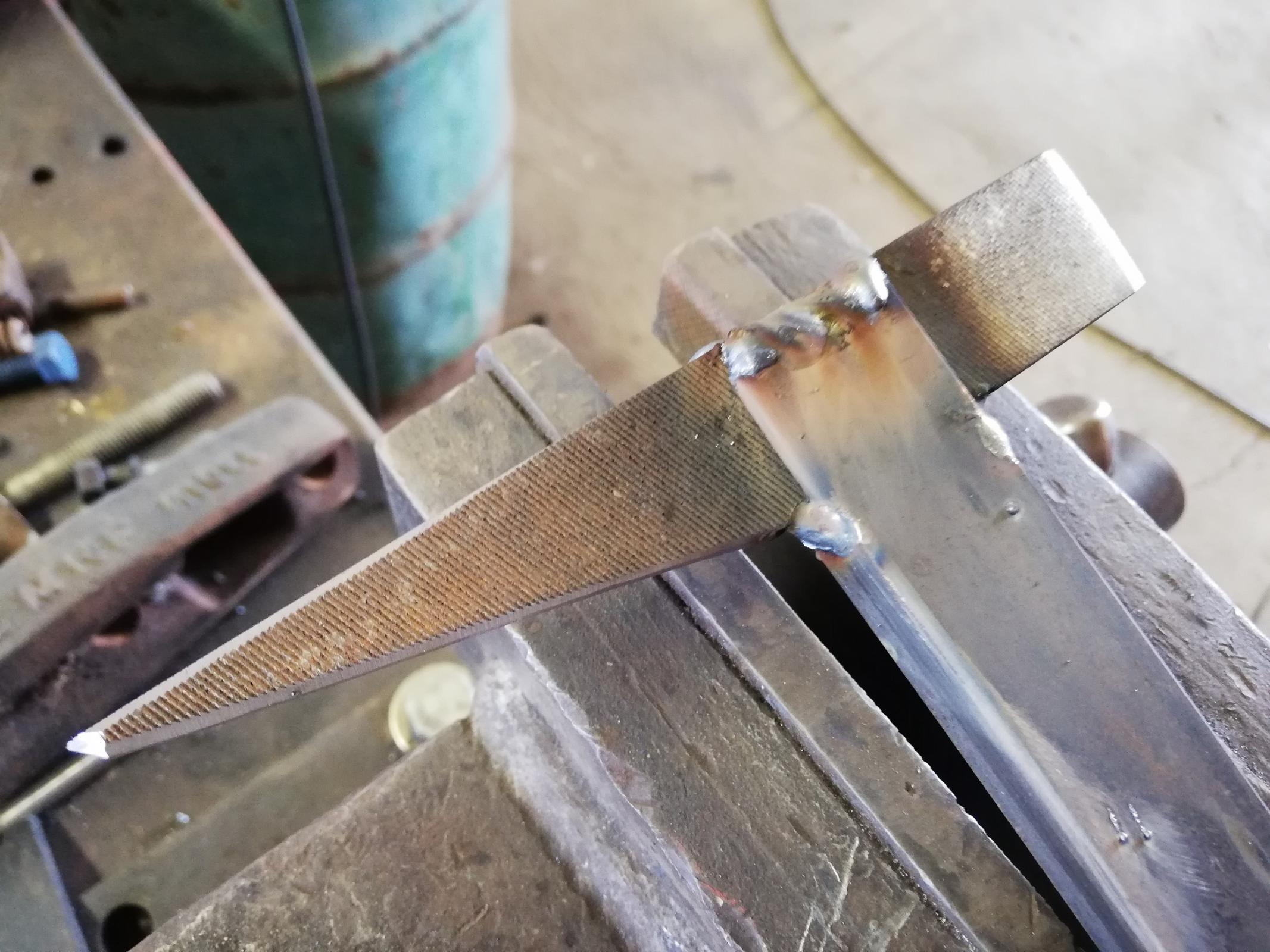

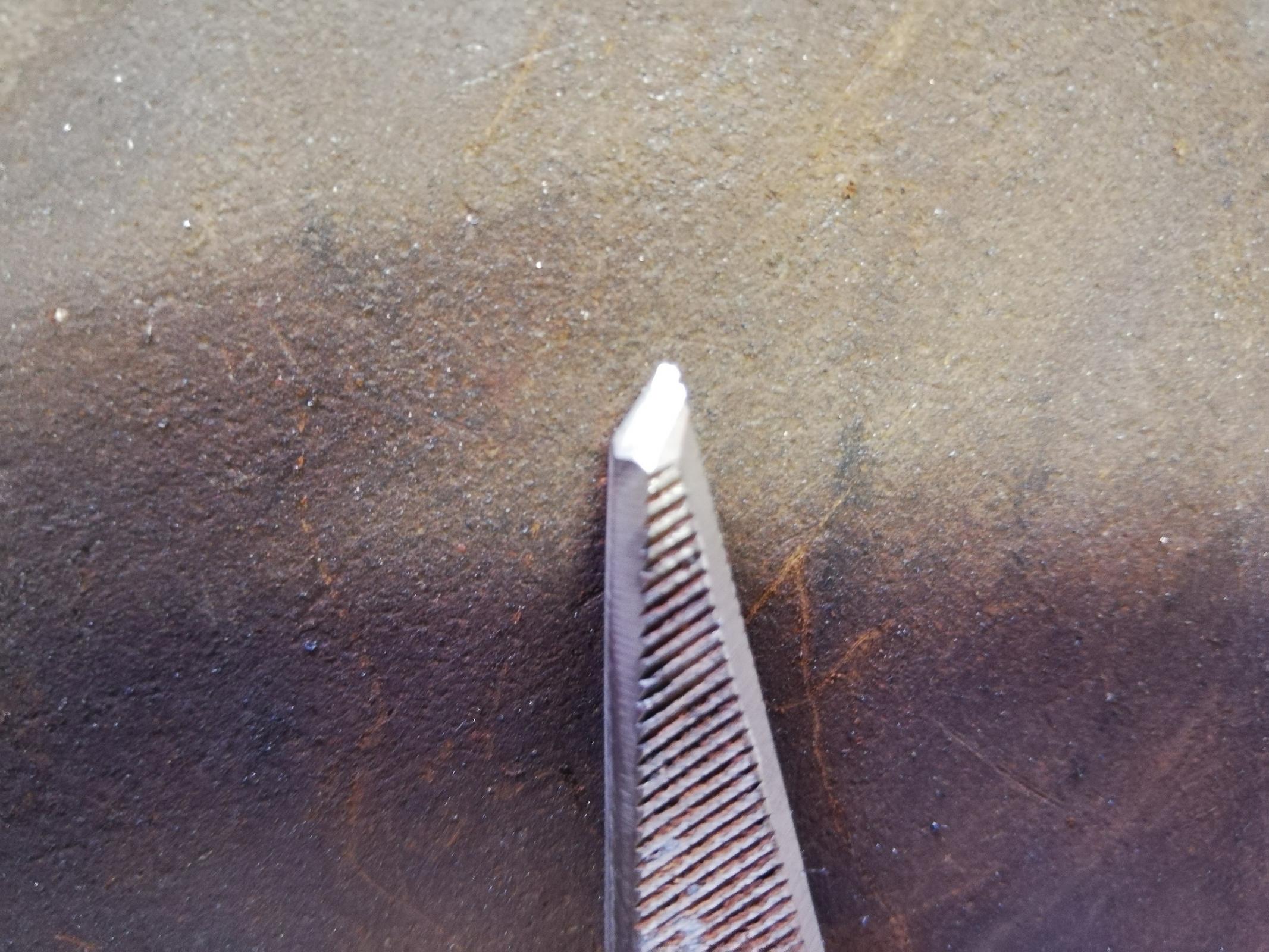

By now, the chopping surfaces of the head are already ground... easier to do before welding.
Attachment 29279
Not too severely welded. Remember heat messes up the temper.

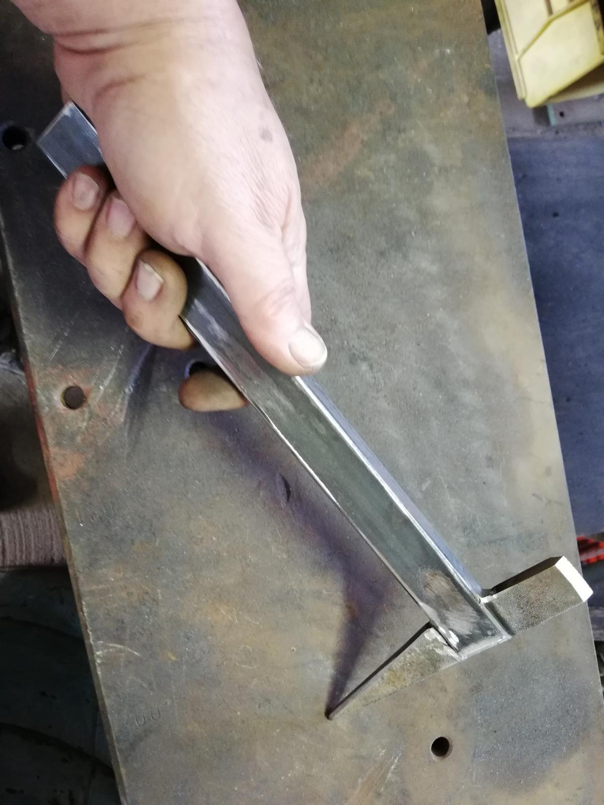

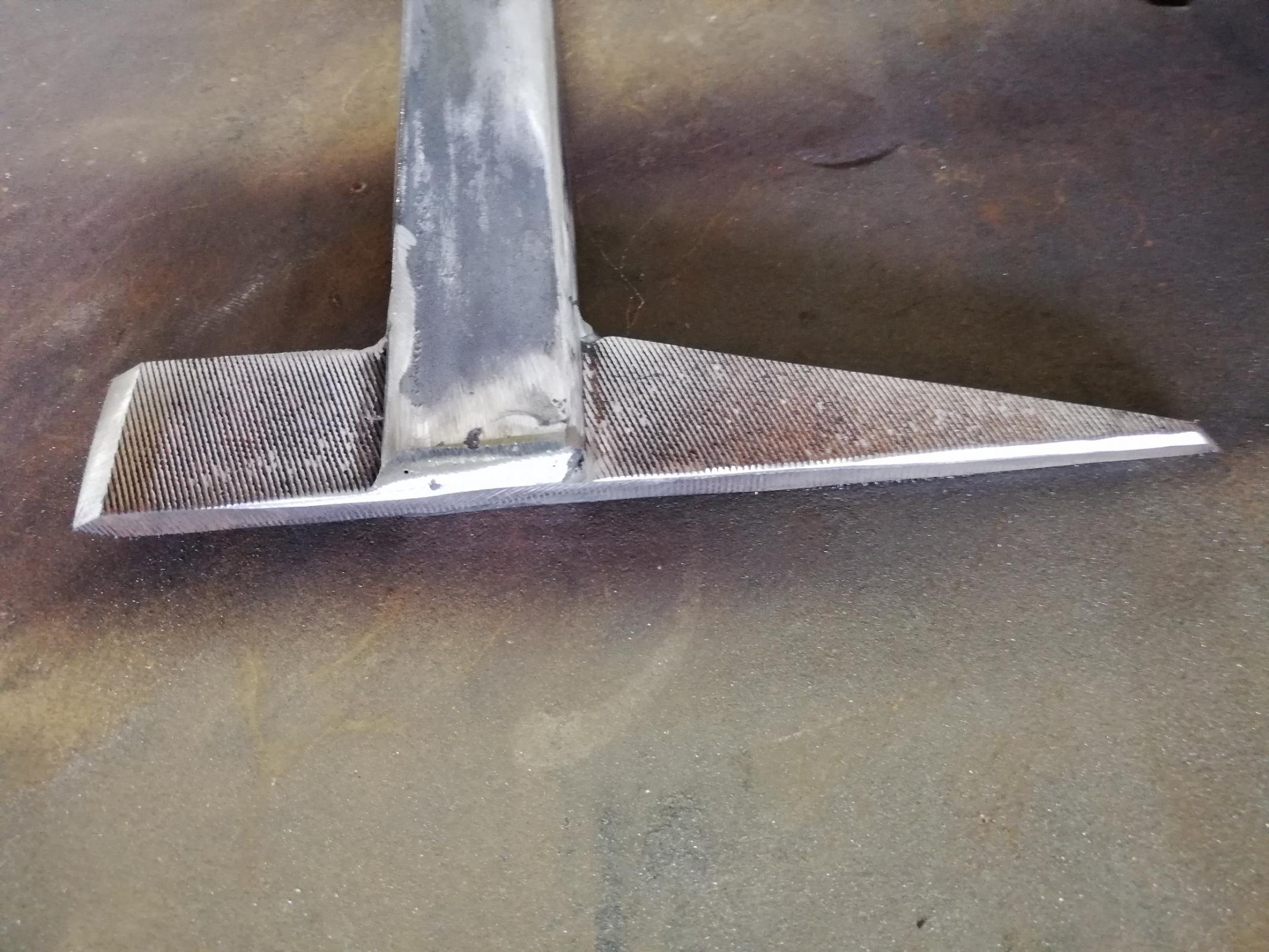

Attachment 29280Attachment 29281

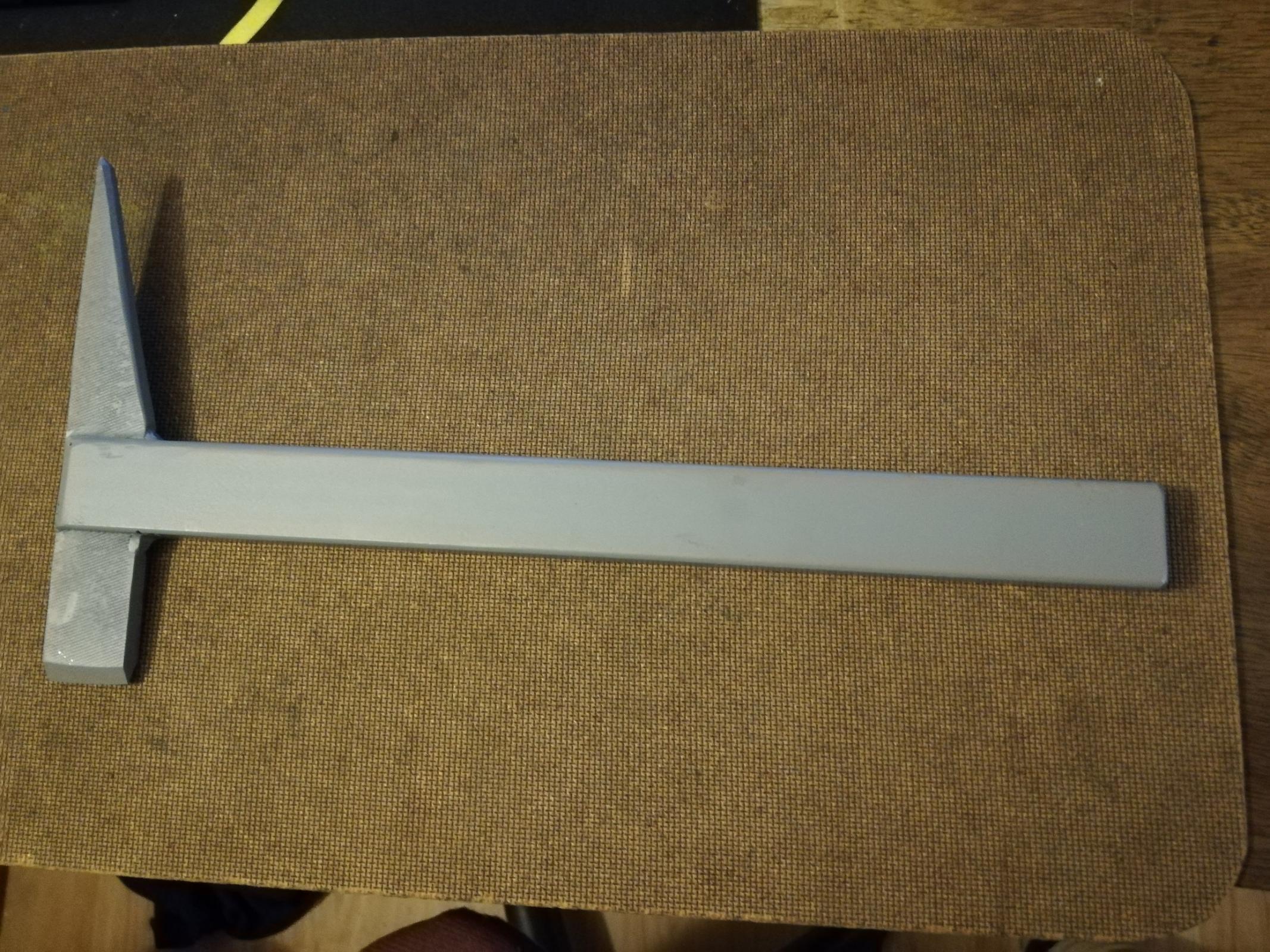

Ready for use
Attachment 29282
And a bit of paint for pride!
