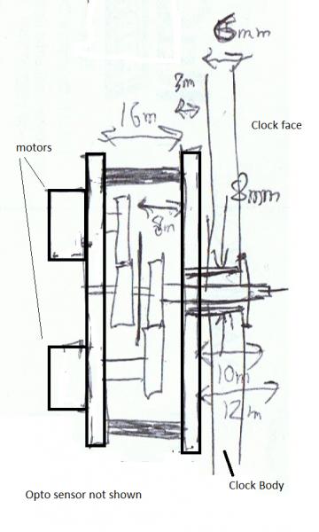

    I have exactly the same stepper as yours, and so far, I feel they are quite slow, so I guess the hands are not dirctly on the shaft of the stepper, and how do you manage to drive the two hands that are on the same axis ?
    Edit, I just saw the video, I saw how you did it, but where did you find the necessary gears ?

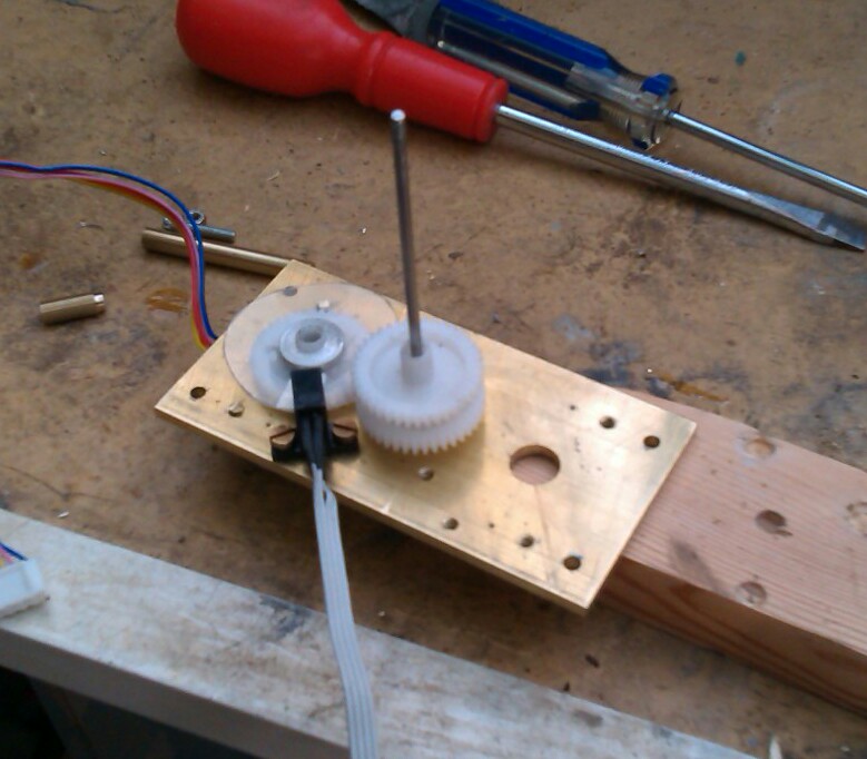

    Christophe, those motors have a plantetary gearbox so have a ratio of 1/63.8. The gears came from Proops Brothers ltd via Ebay.
    Here they are for a test fitting.

    I don't appear to have any photos of the concentric shafts but here's a sketch I made.

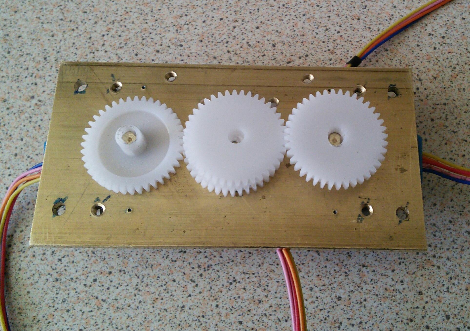

    Attached Thumbnails Attached Thumbnails WIP - Enchanted Cottage-2014-05-25-19.24.10.jpg
