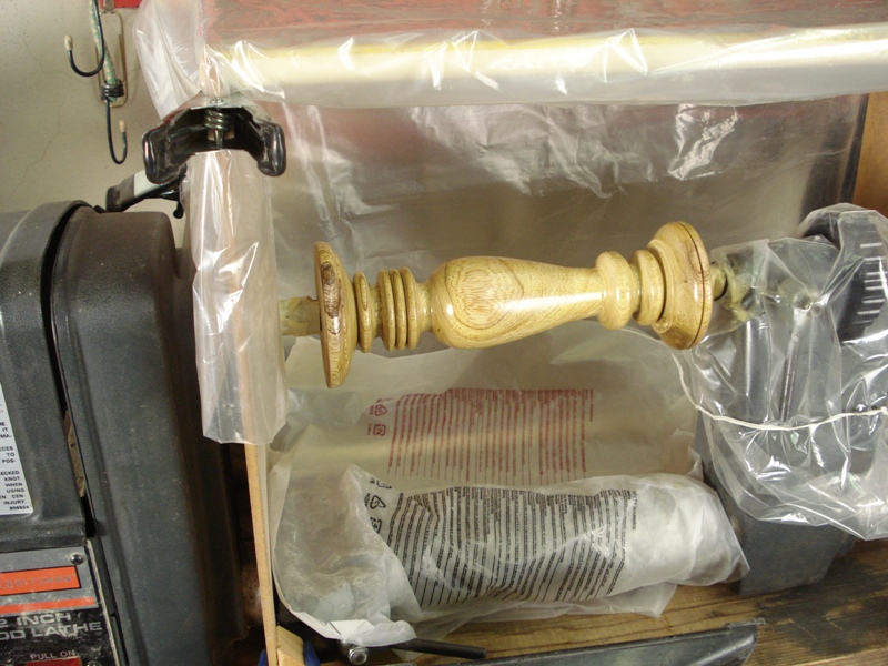

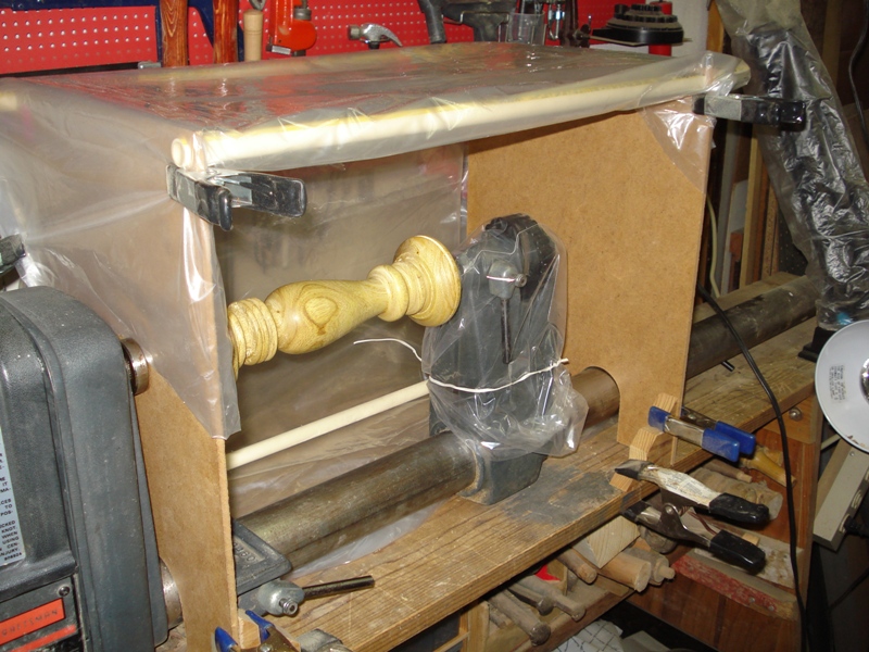

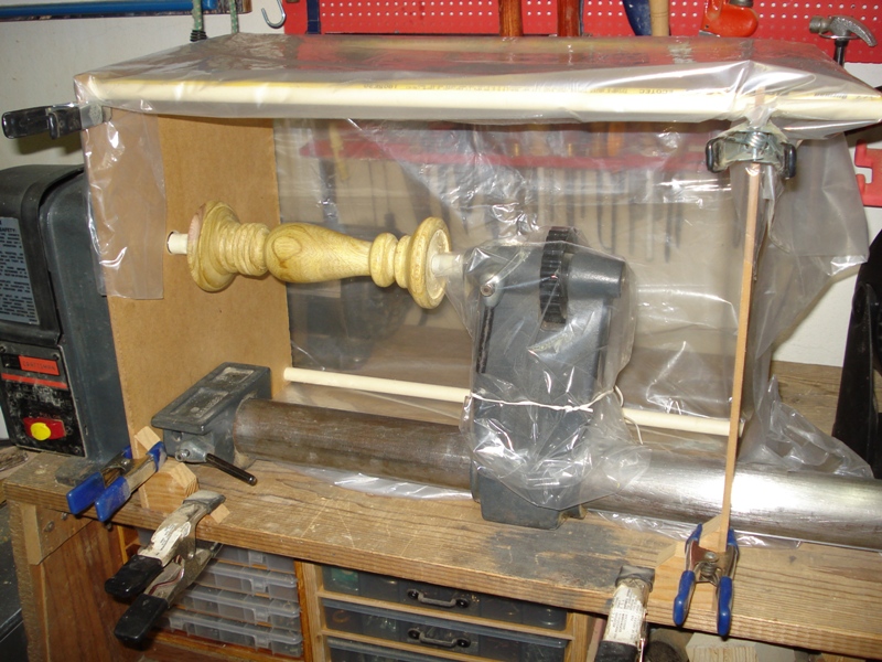

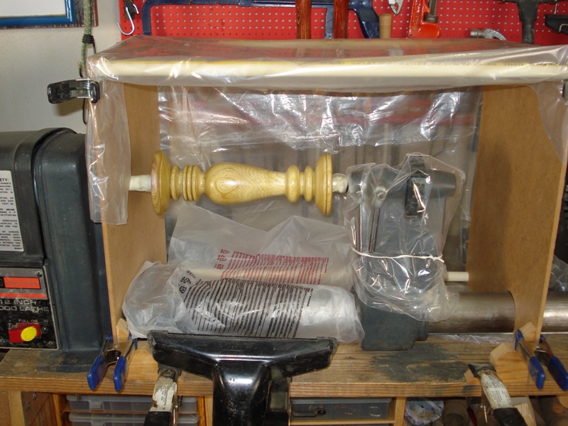

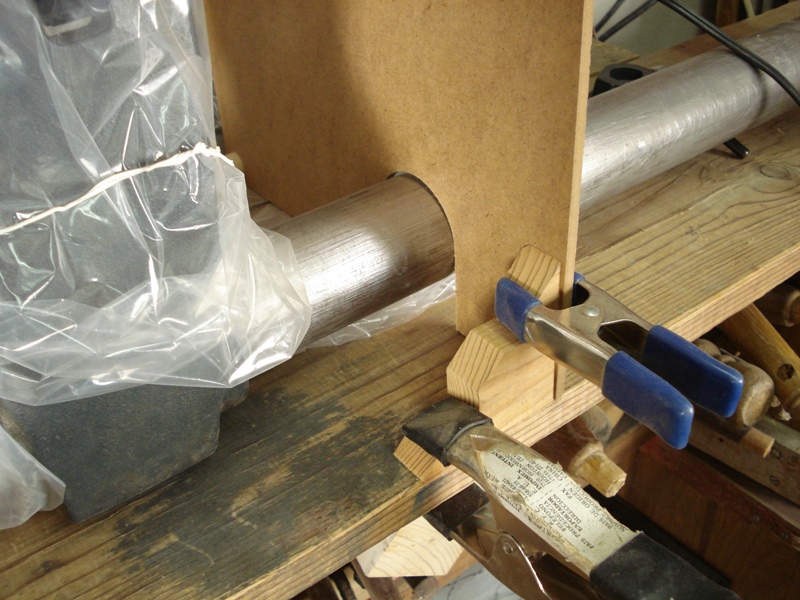

Wood lathe spray booth
Undoubtedly, the most practical way to finish turned pieces is through its application while the piece is still mounted on the lathe.
As with the spray booth (http://www.homemadetools.net/forum/l...ay-booth-53180), the purpose of this booth is to limit overspray of finishing products, when applied in aerosol form or by compressed air.
The frame is made with two macocel boards, and three pieces of PVC pipe. The frame is then covered with plastic on the top, rear and bottom sides.
Attachment 14642
Attachment 14643
Attachment 14644
Attachment 14645
Attachment 14646
Regards, morsa.
