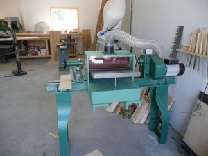

Homemade thickness sander powered by a lathe. Base and tilt board are fashioned from MDF, while the drum consists of a stack of glued 3/4" plywood discs. Sanding medium is hook and loop sandpaper.
