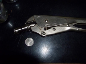

Homemade intercooler pipe beading tool based on a Vise-grip. Intended to bead tubes down to 9/16" ID. Bead was welded onto one jaw and a matching channel was ground on the opposite jaw.
