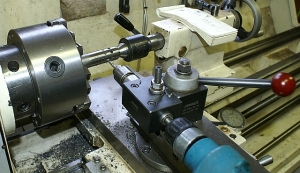

Homemade Adaptor for Drilling Angled Holes in a Rifle Brake
Gerald C on chaski.org
Homemade adaptor for drilling angled holes in a rifle brake. Utilizes a drill spindle running on two bearings that is clamped to a lathe's boring bar holder. A separate hand drill turns the spindle to make the required angled holes.

Love innovative setups like these. Making do with what you have, instead of just spending money.
