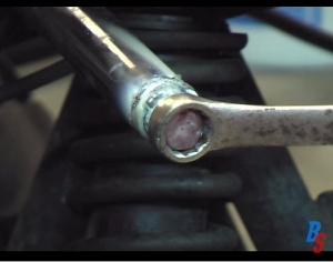

Homemade Broken Bolt Removal Method
bstanga on homemadetools.net
Homemade broken bolt removal method constructed by welding a nut to the broken part.
