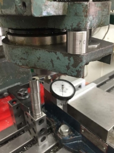

Homemade CNC error correction technique for an RF-30 mill/drill based on utilizing the Mach3 software's Screw Mapping function to identify and zero for errors in the mill's quill and mechanical components.
