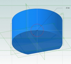

Homemade compound angled hole drawing method comprised of creating a plane at 20-degrees off horizontal, moving it up to the cylinder's perimeter, and then pivoting it 30-degrees. Intended for users of Alibre CAD software.
