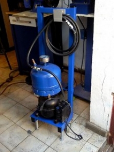

Built using a refrigerator compressor and a gas bottle. The gas tank mounted above the compressor acts as a separator. An additional separator is placed inline prior to the spray gun.
