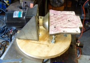

Homemade Diamond Tool Sharpener
Mike Walton on homemadetools.net
Homemade diamond tool sharpener powered by an adjustable-speed motor. Utilizes a 75% 600 grit 3" wheel cooled by Windex. Intended to facilitate the process of sharpening carbide blades.
