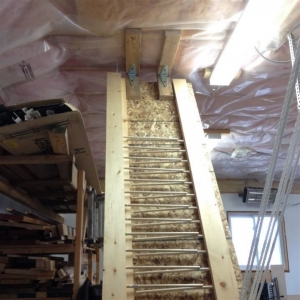

Homemade drying rack constructed from wood, dowels, and OSB. Attached to the ceiling with gate hinges and pulley-mounted, it is raised via drill-powered boat winch. Features 24 slots on 3" spacing.
